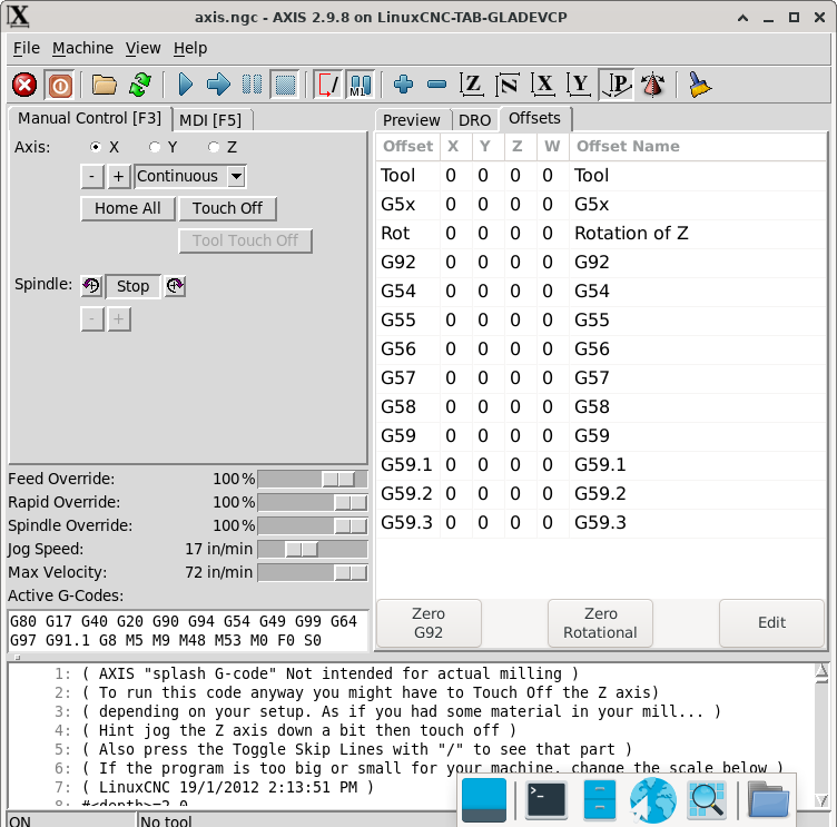

Here is what it looks like.  All offsets show zero, even though they are not zero.

As I expected, it's because offsetpage does not automatically find the var file.
You must make a handler file to set the var file  path.
Something like this (it assumes the offset widget is called 'offsetpage' and the var file is called 'sim.var')
import os
varpath = os.path.join(os.getcwd(),'sim.var')
def get_handlers(halcomp,builder,useropts):
    return [HandlerClass(halcomp,builder,useropts)]
class HandlerClass:
    def __init__(self, halcomp,builder,useropts):
        obj = builder.get_object('offsetpage')
        obj.set_filename(varpath)
        obj.set_col_visible("abcuvw", False)

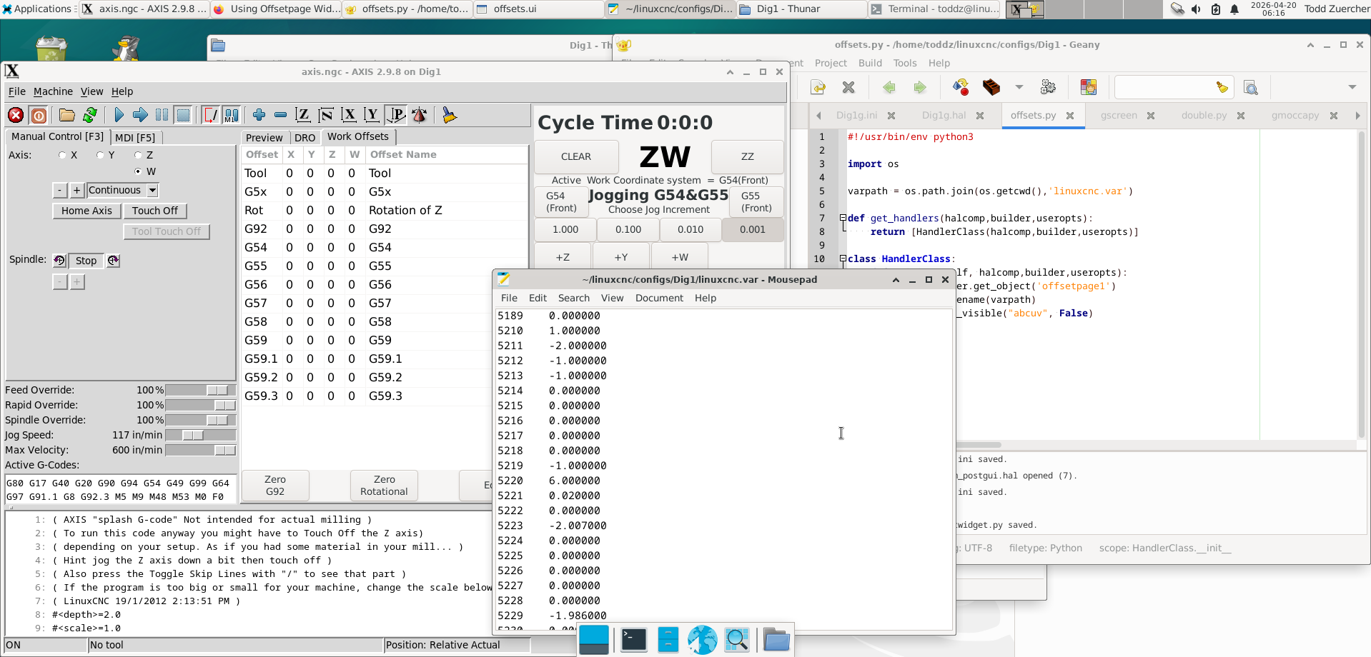

I tried coping what you have above (with the appropriate name changes) to the handler file, but I still get all zeros in the table.

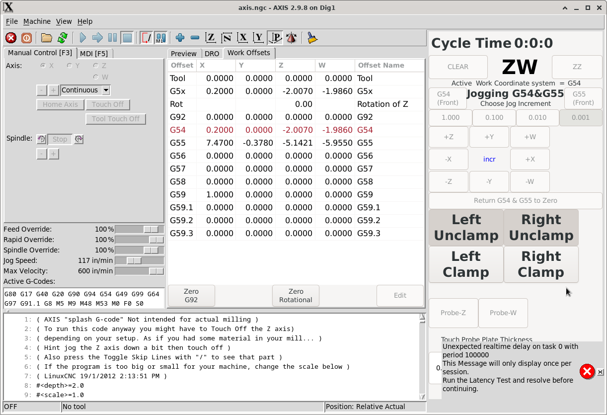

Never mind, I had the name of my handler file wrong in the ini file.
It works!
Thank you

And the INI lines to add it to a tab in Axis.
EMBED_TAB_NAME=Work Offsets
EMBED_TAB_COMMAND=gladevcp -u ./offsets.py -x {XID} ./offsets.ui
