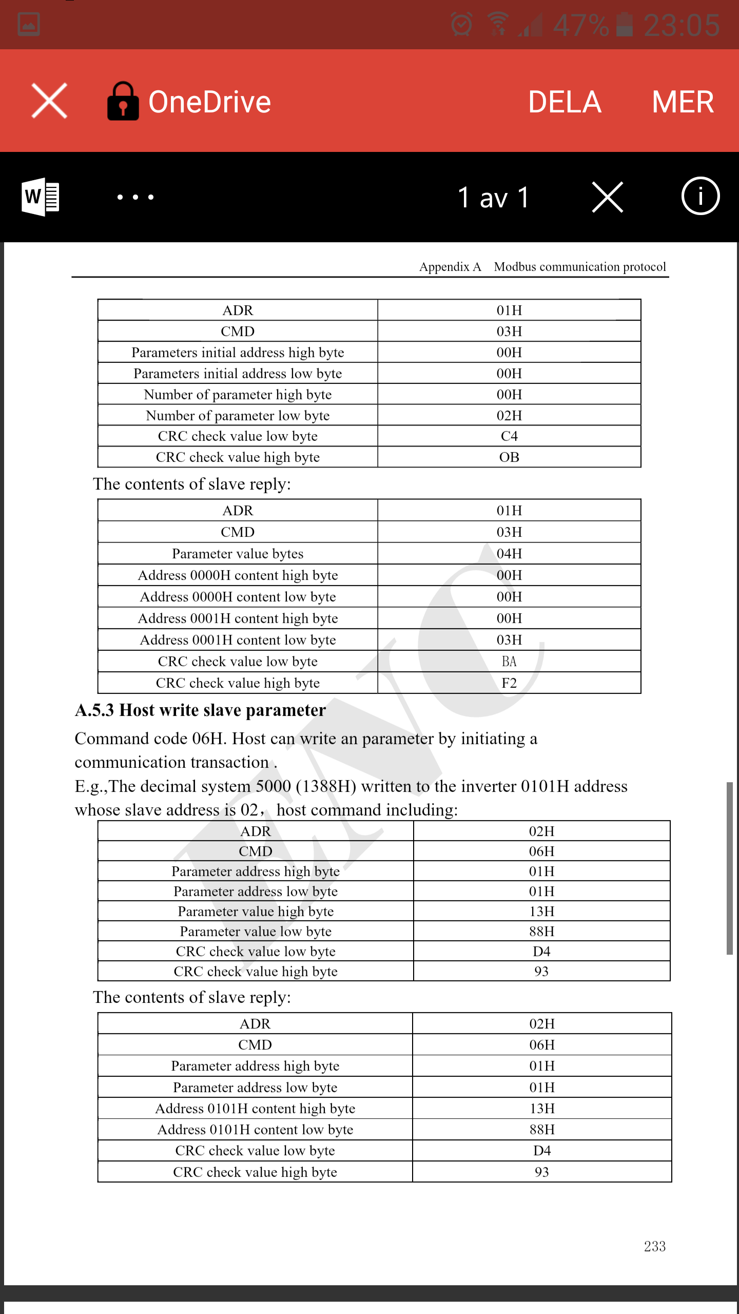

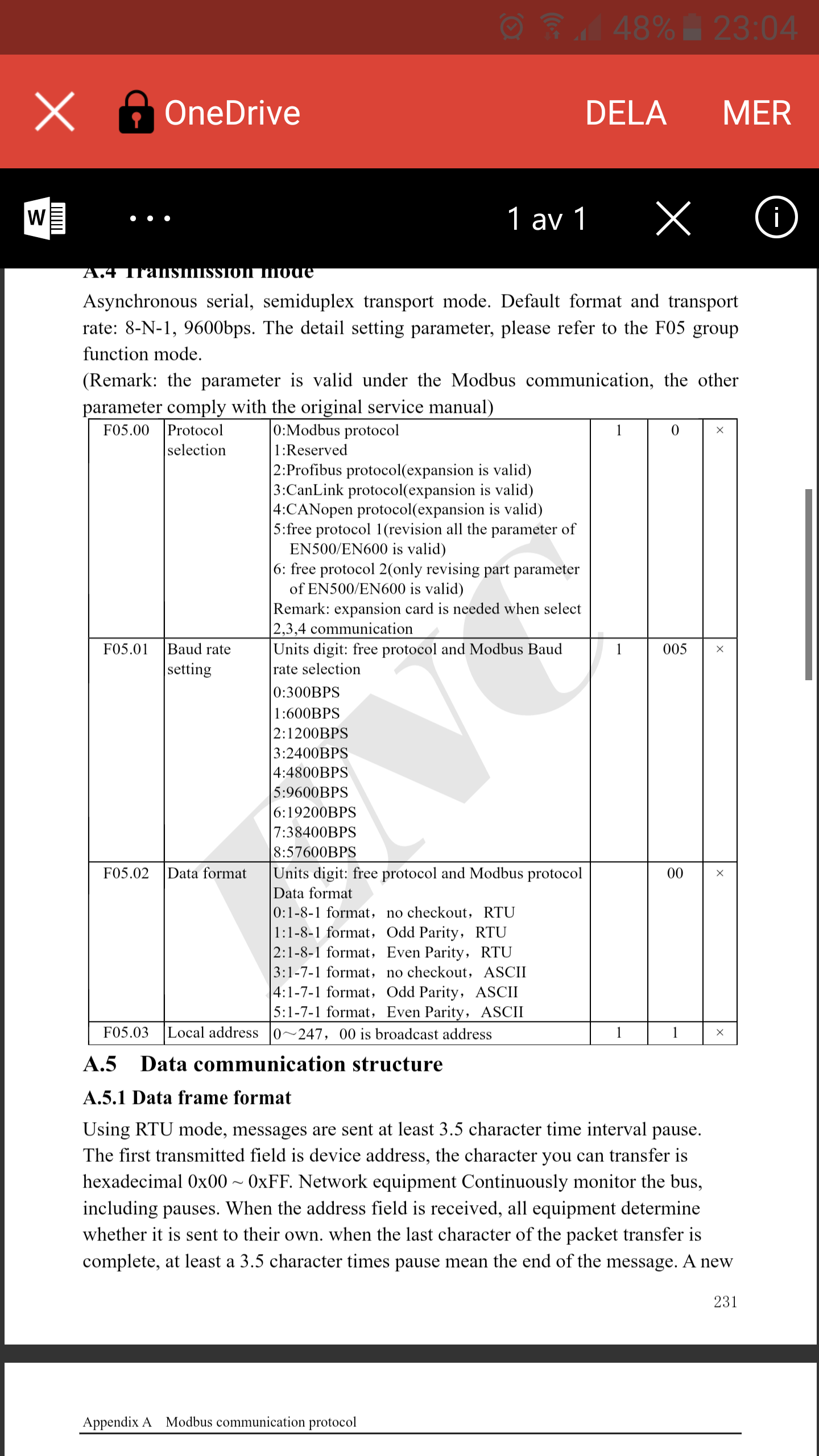

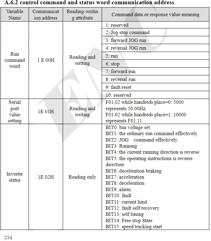

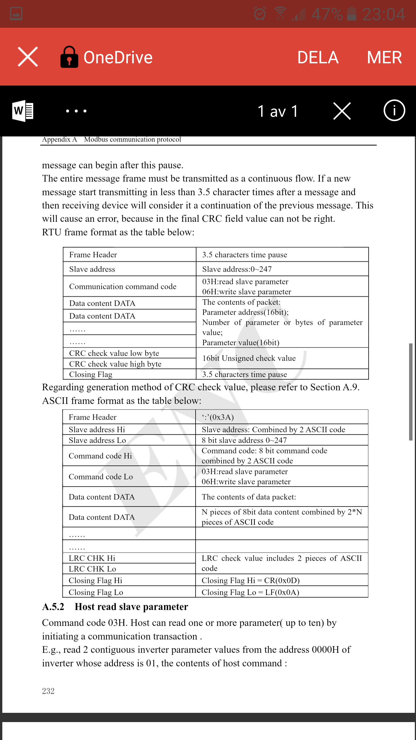

The below link is a couple pages on the modbus section from my ENC EN600 VFD.
VFD Modbus manual

Well the manual is really good for my vfd, i separated the modbus part that can be located here: 1drv.ms/b/s!AnY9CcWCLBtalGev69rQ1UOUzZXn
i just don't understand how i should apply the information from the manual, if we look at this chapter from the X200 code for example:
# Running Clockwise?
[TRANSACTION_04]
MB_TX_CODE=fnct_15_write_multiple_coils
FIRST_ELEMENT=14
NELEMENTS=1
HAL_TX_NAME=is-reverse
MAX_UPDATE_RATE=0.0
DEBUG=3
i have this table in the manual:
Victor

16 Feb 2017 15:35 #88077 by Todd Zuercher
Replied by Todd Zuercher on topic Setting up USB -> Modbus (CH340) for VFD control
Looks enough simpler than the ones I had to use, to wonder if your are missing something.
Such as my drives need to have a certain register written to to unlock the drive. Then another had to be read periodically to prevent a communications shut down... I'm a little jealous if you only need to write to one register and read 2 contiguous ones. (Did i mention the drives I had to work with were a complicated mess.)

16 Feb 2017 16:01 #88084 by Todd Zuercher
You'll have to bear with me a bit, as it was more than 3 years ago since I have last looked at this stuff. (and it wasn't all fond memories, so I have not dwelt on it.)
The first thing you need to do is figure out what the drives current modbus parameter settings are, and what you need to set them to.
You need to figure out what the address of your little USB dongle is. (It should be something like SERIAL_PORT=/dev/ttyUSB0 (or 1,2 3...) Mine was 0 as it it the only USB device on that computer.

16 Feb 2017 16:10 #88085 by Victor
Ok. The usb address is ttyUSB0
I have the following pages with diffrent protocols if that is what you mean?
