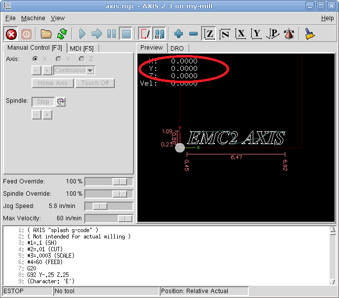

I have a question regarding configuration. How I can change resolution from X: 0.0000 to X: 0.00
I am asking about it, because step in my cnc is 0.05mm and I want to see value much more closer to the real position.
I attached picture to show what I am asking about.
Thank you for your support.

If you upgrade to 2.8 you can customise the dro settings.

If I change this DRO_Format and I wil get 0.00 format, is there a possibility to have step on 0.05 not 0.01 ?

If you are refering to the jog increments, then yes.
Same section see INCREMENTS.

I've changed jog increments to 5mm 2mm 1mm 0.5mm 0.1mm 0.05mm
What I want to achieve, is that in continuous mode, it will stepping every 0.05mm on the display, because I know that it is physically working like that.

I've checked... I have 2.7 and upgrade is needed

Not sure how that could be achieved.

Some how you would need AXIS to process the DRO value with something like this (found on the net):
But I wonder about possible problems with say doing offset adjustment calculations with such a display.
def round_to(n, precision):
correction = 0.5 if n >= 0 else -0.5
return int( n/precision+correction ) * precision
def round_to_05(n):
