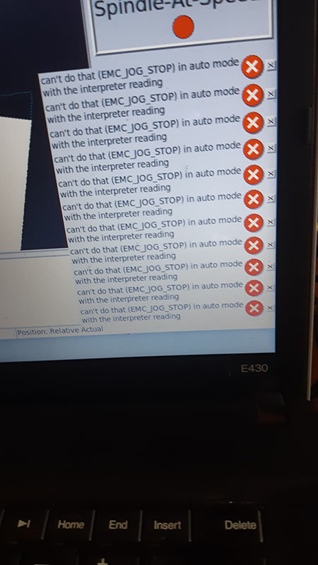

Good evening everyone
While I was executing a g code on my machine I got this warning right at the beginning and if I try to close each small window, more and more coming up.
This warning does not effect the work but I rather not to see it.
Sometimes I get also and error like "linear move on line 58 would exceed X's positive limits" but when I check the line everything seems in the range.
i always home my machine right at the beginning but sometimes this error comes up.
Any help would be great, thanks in advance.
Regards,
V.

Can you post a short bit of G code that will create that error?
In Axis if you click on Help > Quick Reference you can see all the keyboard shortcuts. Ctrl-Space will clear all notifications.

Move the mobile phone away from the keyboard and mouse !

For the one in the picture is there any chance you have a key on the keyboard getting stuck? I believe I have seen that error when trying to manually jog while the machine is running. If it keeps popping up something from your gui is trying to do a manual process while running.
For the second issue use the axis preview to see if any of the tool paths are outside the red box in the preview. The red box is the machine soft limits. You can toggle the axis preview using one of the buttons on the top ribbon around the center. One of the buttons will give you a 2d view looking down at the xy plane from the z axis. If you see white lines outside the red box that's your offender.
When viewing line 58 code just remember that the gcode is usually running as relative position and not absolute. If you set your work offset (G54) a bit too far to one side of the table you can be outside your work envelope.

My phone is always near my laptop, so I will try to move it away.
This is a piece of very simple code with a tool change (two tools) and I got the error in correspondence of the second tool at the end of the code (the code of course goes on till its end).
I found out that there is actually a mistake in my code.
If we have a look at my macro that is related to tool change ( I remapped the M6 command), the code does not switch back to G90 so I need to manually introduce a G90 G54 X0 Y0 after the execution of the macro.

I manage to fix the line 58 error.
The error was due to my mistake.
I need to put in my g code before of every G53 the line G0 G90 G54 X0 Y0 and i would be fine.
Regarding The warning message I have no idea; I have tried to move away any source of interference that I am aware of but still there.
I have noticed that this warning start to appear after I carved the smoking demon.
