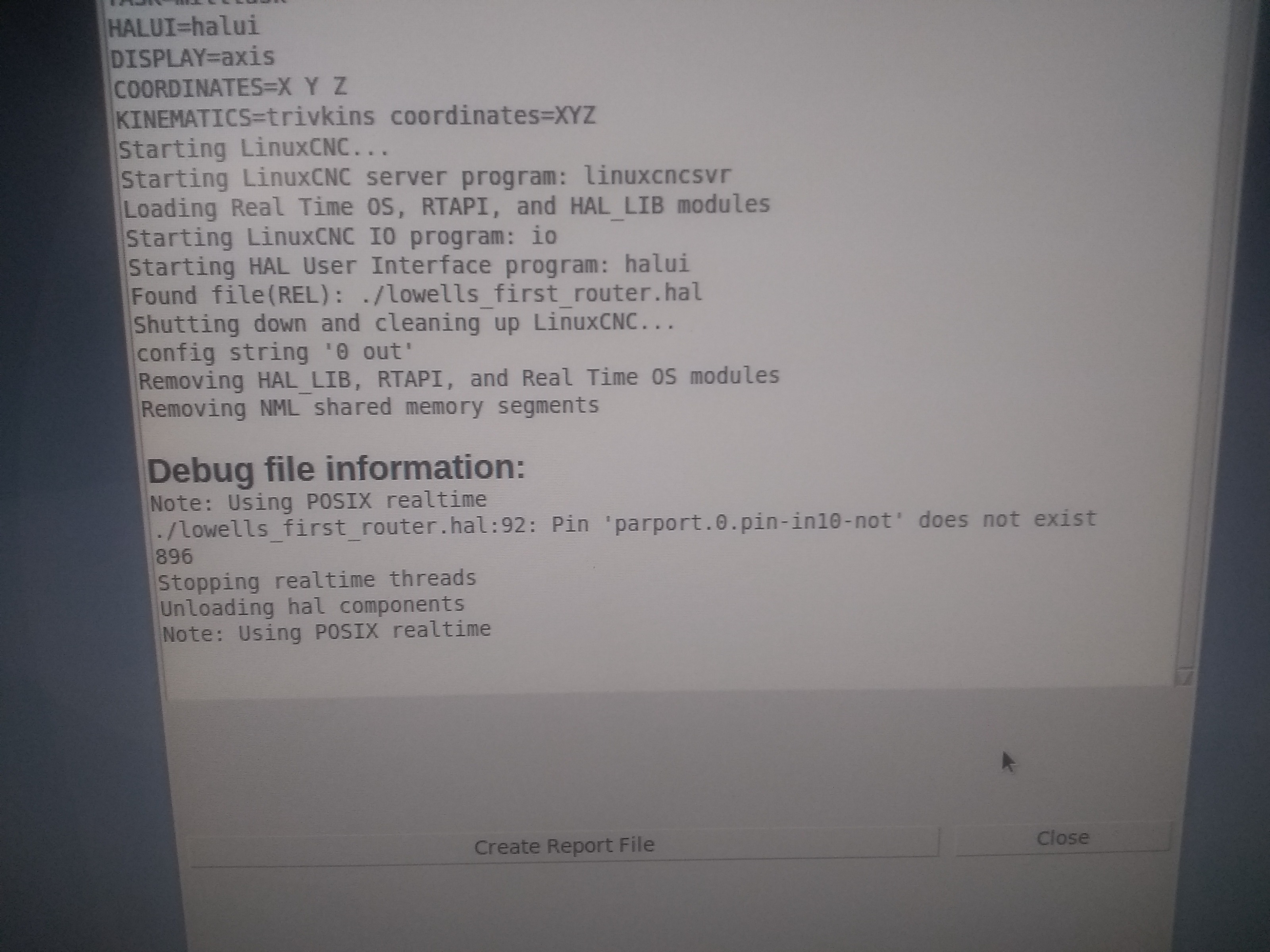

Bevins, this is from your post:
loadrt estop_latch
addf estop-latch.0 servo-thread
net estop-loopout iocontrol.0.emc-enable-in <= estop-latch.0.ok-out
net estop-loopin iocontrol.0.user-enable-out => estop-latch.0.ok-in
net estop-reset iocontrol.0.user-request-enable => estop-latch.0.reset
net remote-estop estop-latch.0.fault-in <= hm2_7i92.0.7i76.0.0.input-00-not
BigJohnT:
# estop
loadrt estop_latch
net remote-estop estop-latch.0.fault-in <= parport.0.pin-in10-not
They are IDENTICAL except for the last line. If I put either one into my HAL file, I get the attached photo. HAL will not even start up.

Replied by bevins on topic Setting up limit switches and a bunch of other things
The last line I put is for a mesa card. JT is for a parallel port card.
What does the debug portion of that error page say. That will tell you what is wrong.

It says that this doesn't exist :

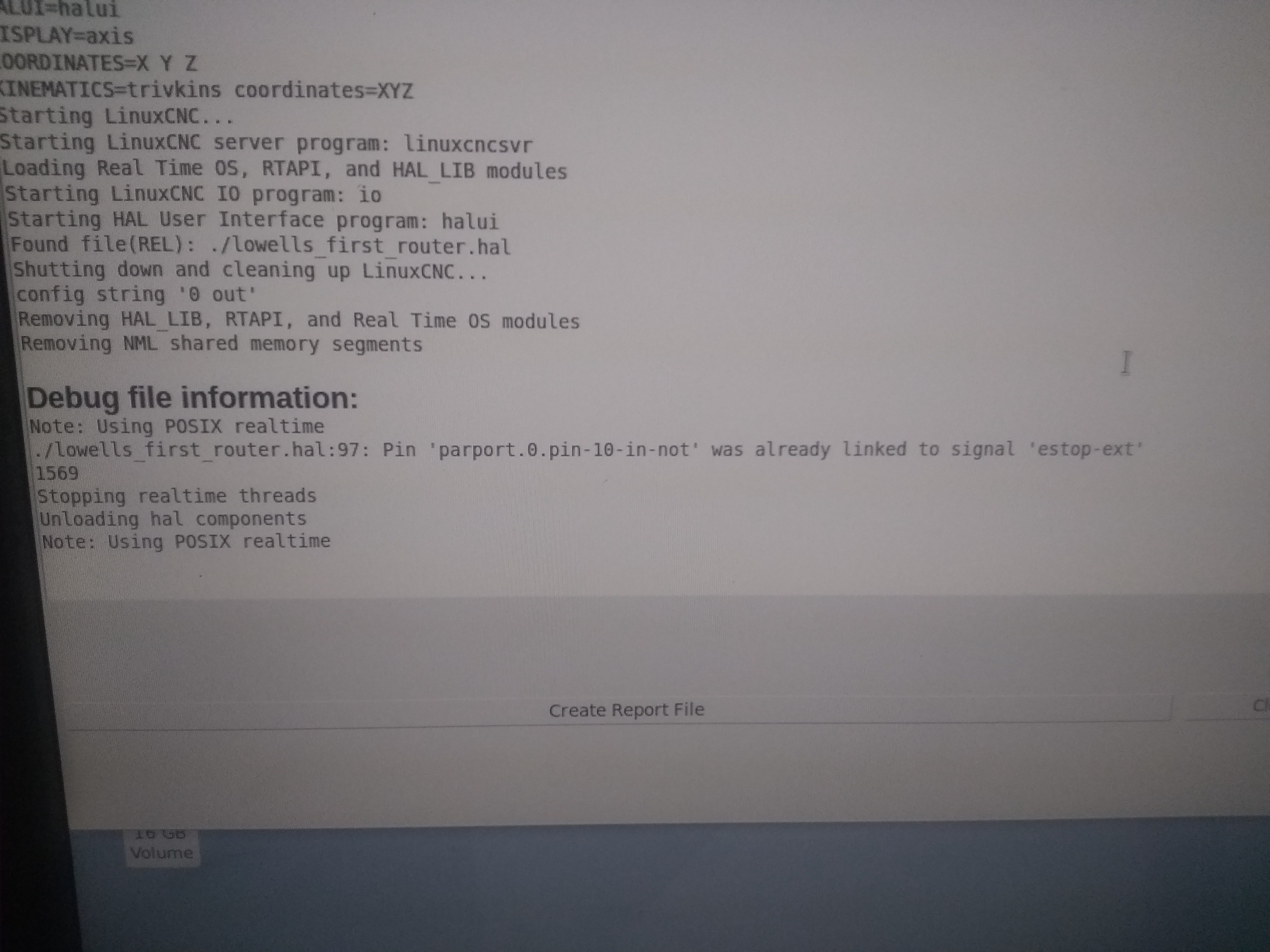

I then tried switching it over to "pin-10-in-not", and then it gave me the same error only now it was because I selected something used by the ESTOP. So I switched it back, and it doesn't exist again.

06 Jul 2021 07:40 #213831
Replied by tommylight on topic Setting up limit switches and a bunch of other things
parport.0.pin-10-in-not
Missing - between in and 10 in your last several posts

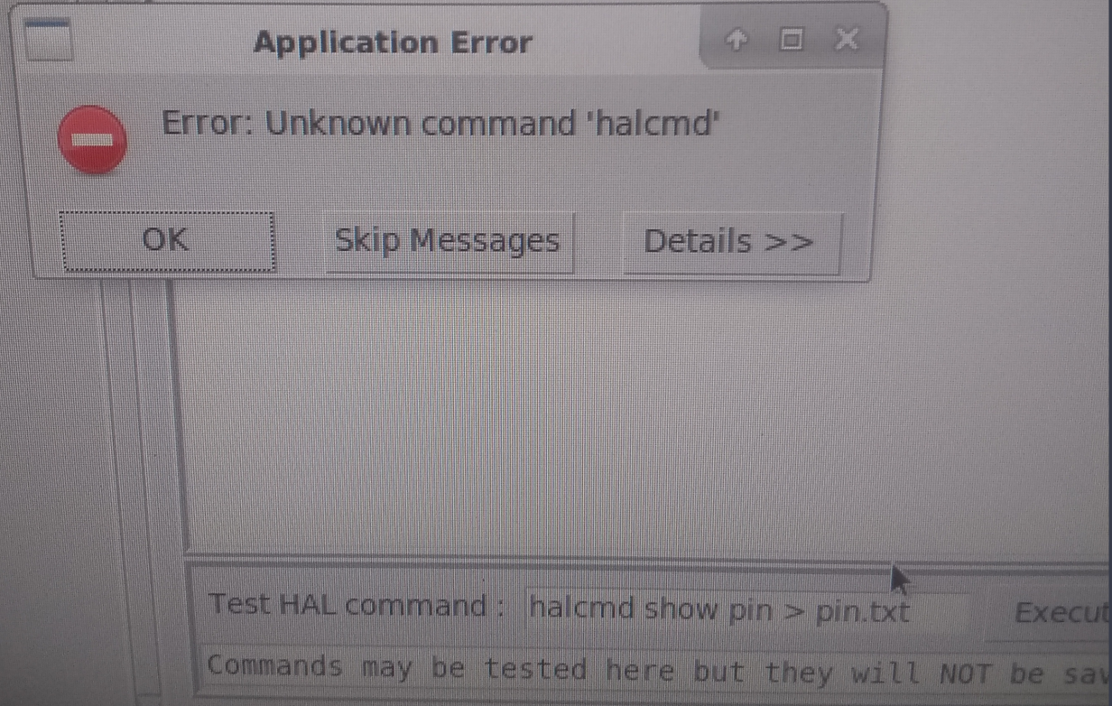

You do have to select a pin that you have, not just some random pin from the example.
Run your configuration and open a terminal and type in
Then select a pin you are using for the estop in from your machine.
JT
halcmd show pin > pin.txtThen select a pin you are using for the estop in from your machine.

And that's how that turned out. At this point I am assuming bad installation from the .iso file. Also just burned a copy of 2.7 Wheezy. Not ready to nuke the install yet, but I'm getting there.
EDIT:
Tried this instead -
halcmd: show pins
Same error as the photo. I'm done beating my head against this wall. It's a waste of time.

The install is probably OK
halcmd is normally run from a terminal window, it looks like you are trying to
launch it from halshow. You can run commands like "show pin"
(without the halcmd) from halshow but I'm not sure where a file (like pin.txt)
would be created since I don't know what the default path of the running LinuxCNC
instance is .
If you run:
halcmd show pin >pin.txt
from a terminal, pin.txt will be created in the current directory

Last error you got was for the same pin 10 found twice in the hal file, the debug part of the error report always will show what exactly is wrong.
Start LinuxCNC from the menu, select sample configuration>apps>parport>parport_0x378
That will open a parallel port tester with LED's for each pin, so look at pin 10 while togling the e-stop.
If nothing happens, set the jumper to "pull up" and test again.
If even that does not work use a different input as 10 is most probably fried.
