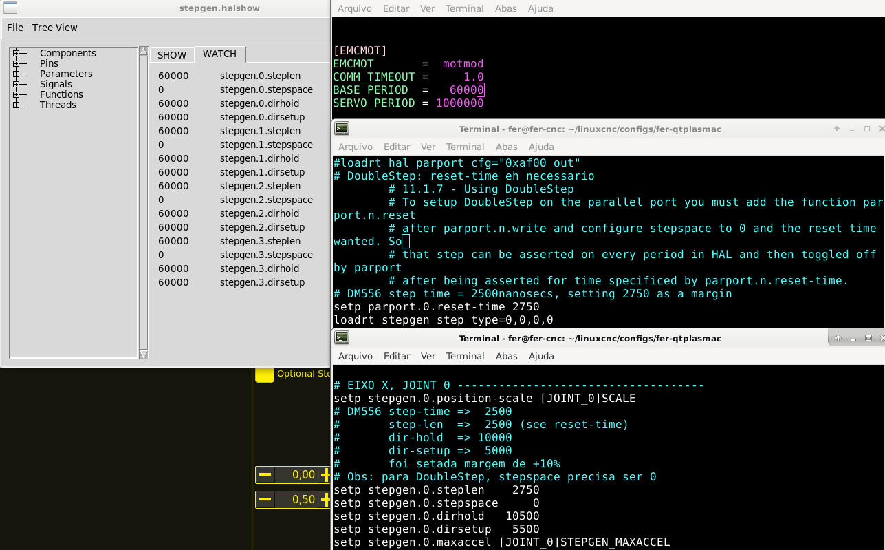

08 Aug 2021 09:36 #217237
by fernandosf
Replied by fernandosf on topic Base Period Jitter Manual Changes (without StepConf)
Hey Guys,
I have searched DM-556 timings and read about DoubleStep (I'm using parport).
So I added a 10% margin and set INI and HAL accordingly.
But, somehow, stepgen values are set to 60000 (which is the setting I've defined for BASE_PERIOD)
I was expecting dirsetup, dirhold and steplen to be the ones I defined.
Can someone explain why LinuxCNC is not following my settings?

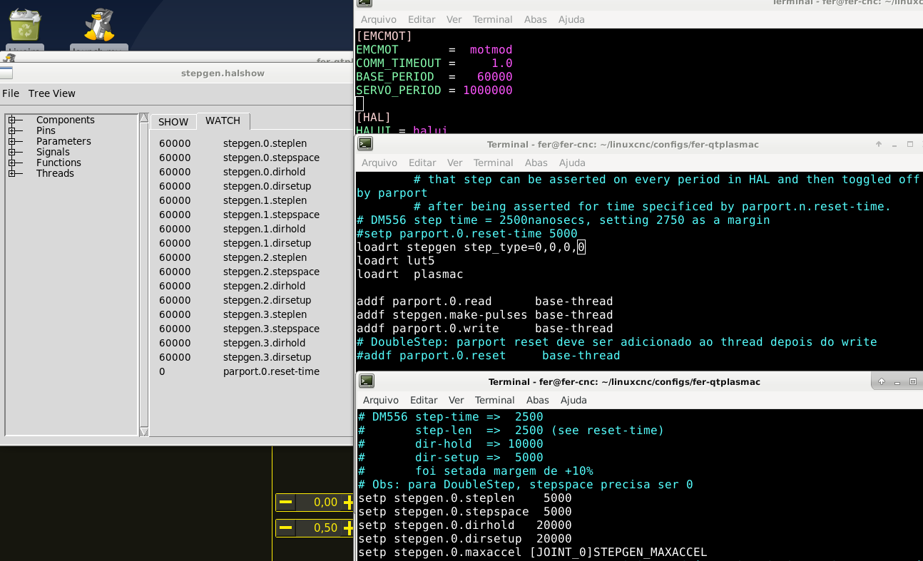

10 Aug 2021 19:17 - 10 Aug 2021 19:18 #217446
Replied by andypugh on topic Base Period Jitter Manual Changes (without StepConf)
There is no advantage in having dirhold and dirsetup short. The machine is by definition moving at zero speed at that point.
If you want shorter step lengths, then edit the INI file.
The chances are that the max speeds that you have configured mean that Stepconf sees no need to use a short step length, as the max required step rate can be achieved without.
