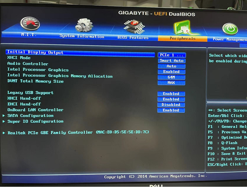

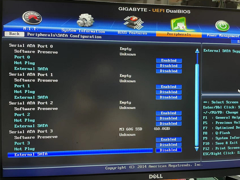

12 May 2022 01:49 #242706
by EdisonBin
Replied by EdisonBin on topic How to view the DB9 to USB port??
Hi Tommy!
I entered the BIOS and checked the serial port settings. I put the photos below.
It doesn't look like a problem, does it? It seems to have been turned on

The second picture shows the config for the Serial ATA drive interfaces, not the Serial comms port. Did we make a silly ? lol

Excuse me, am I taking pictures in the wrong place? Or is the configuration wrong? In fact, I don't understand ATA and so on. I'm very strange to these. LOL~
Can you guide me? thank you
- ALittleOffTheRails
- Visitor
12 May 2022 02:14 #242713
by ALittleOffTheRails
Replied by ALittleOffTheRails on topic How to view the DB9 to USB port??

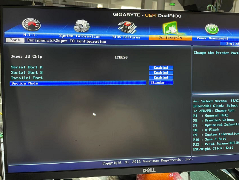

Serial ATA is the connection form your hard drive or solid state drive, SSD, to the computer. It has nothing to do with serial communications. I noticed in the first picture there is a reference to Super I/O, if this has a sub menu it may have some items regarding the serial comms.

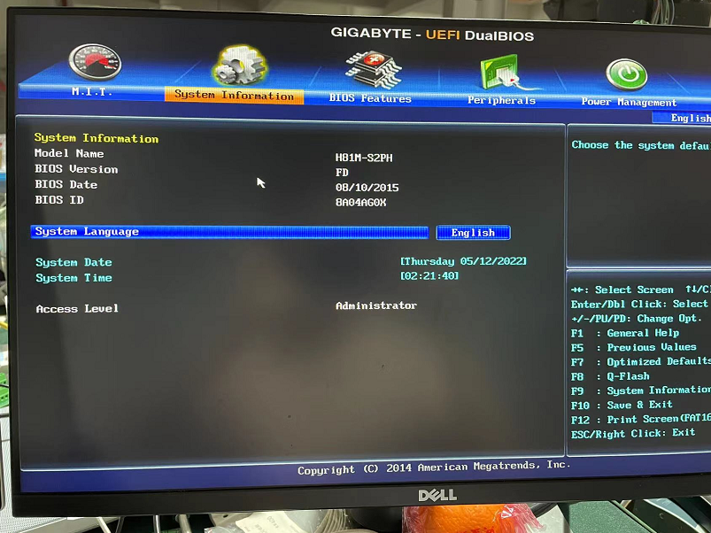

BTW what model of computer motherboard are you using, this could be of some help.

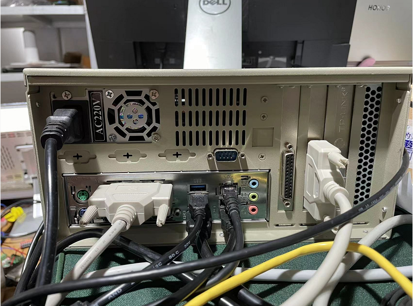

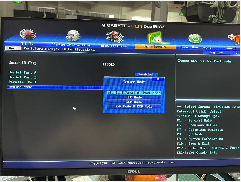

In BIOS, I found that the motherboard model is h81m-s2ph, which may be a very old motherboard? Because I bought this industrial computer online. I'm just doing application level
I also took photos and posted the information of super io. It seems that there is serial port information in it. I also took photos of the back of my computer
Please check, thank you
