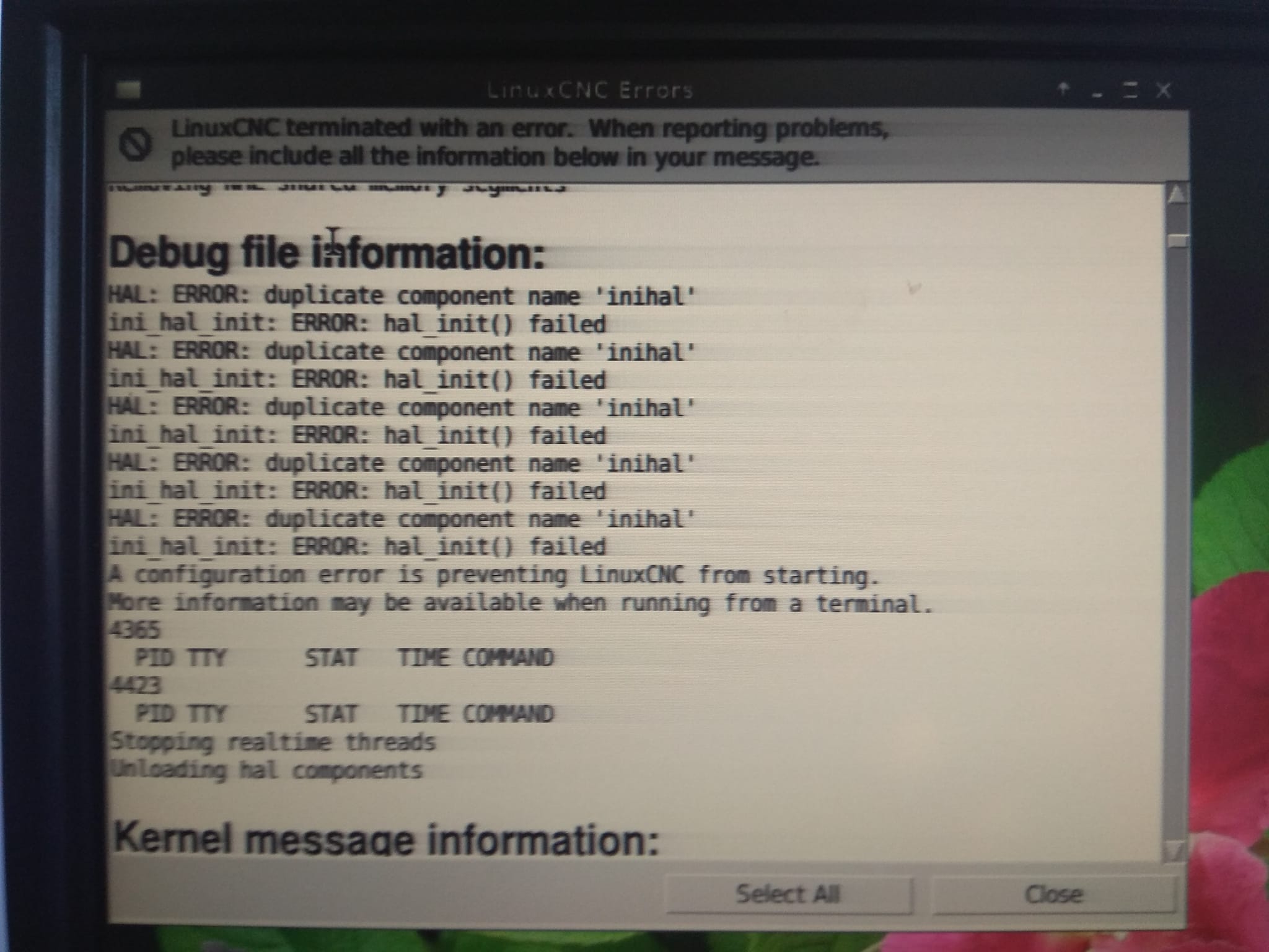

Hello,
I am trying to set my CNC to work as 5 axis
I did xyza config wizard installation and then added the c axis in. Hal and. Ini files
And this error appears
Error pic .Hal and .ini files are in the attachments
Any help is appreciated.

Replied by andypugh on topic 5 axis config
Do you have anything in custom.hal or custom_postgui.hal?
Do you see that "select all" button on the error dialog? If you press that then you can copy the entire error output and post it here. Things we need are either off the bottom or off the top.

You did a mistake inside your hal.
your parpaort isnt configuarated,
you will find the right address with the shell.
"lspci -v" and you get a list of parts thats on your pc.
look at the io card parport, and you get some addresses on the list.
loadrt hal_parport cfg="your address out"
then will work
