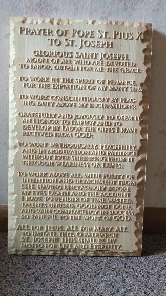

My CNC machine is functioning "normally" again. I'm not sure which did it, for sure, because I simultaneously HALVED my STEPGEN_MAXACCEL to 75 and DOUBLED my STEPLEN to 10000. My, wooden carving, projects don't require feeds above, maybe, 180ipm which is to say, I'm probably not a candidate for tweaking performance.
After a test run of 50 laps around an 8x10.5 rectangle (fans of 8.5x11 paper will recognize the significance) found the origin spot-on, I once again rashly launched the "finishing" pass of the model I'd cut the rough pass on, roughly, 19 months ago. It happens that it is the "450th" model I've made on this CNC machine.

Oh, and that reminds me to post the result of this successful last/first run (I decided to keep the mung-edness of the bottom to remind me of the Long Walk to get-back-up-to-speed. The rest of you take note about Preserving Your Setup against Future Unknowns.)
