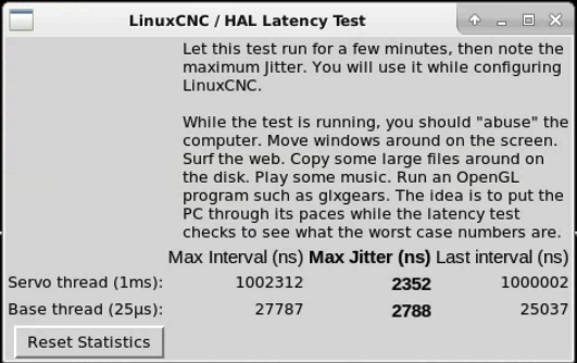

I researched this issue on google + these forums and cant seem to find a solution.
My X axis has been homing without issue until today. Now, homing completes and then triggers a 'following error' within 100mm of travel to go to the home offset. Movements of the X axis using the jogging commands + the setup utility work without issue at speeds up to 350+ mm/s. However, when I set my config ini to have an X max velocity in excess of 150mm/s, the following error triggers. My work around has been to set the home offset to near of the limit switch so no travel occurs after homing completes.
What am I missing here? This was working without issue until today- super perplexed. Attaching HAL and INI. Thank you!

Replied by tommylight on topic 'Following error' as X axis travels to home offset subsequent to homing
Missing
HOME_FINAL_VELOCITY = nn <number here
But that should not be the only cause as setting it to 0 is the same as not having it, meaning the machine will travel at max speed for the final part of homing.
Seems you have a metric machine, so FERROR = 1 and MIN_FERROR = .25 are to small, should be 10 and 1. This might just be enough to stop it having the issue.
But first, do you get latency warnings when using LinuxCNC?

Replied by PCW on topic 'Following error' as X axis travels to home offset subsequent to homing
That's weird, maybe something changed on the host computer to increase latency
Maybe a plot of the following error (and say joint 0 velocity) would provide a clue

Replied by kenthompson on topic 'Following error' as X axis travels to home offset subsequent to homing
- kenthompson
- Posts: 9
06 Jul 2023 16:52 #274901
by kenthompson
Changed FERROR to 10 and MIN_FERROR to 1- still getting follow error. I also added HOME_FINAL_VELOCITY = 150 to the ini. This also did not fix the issue. Not sure what to do
