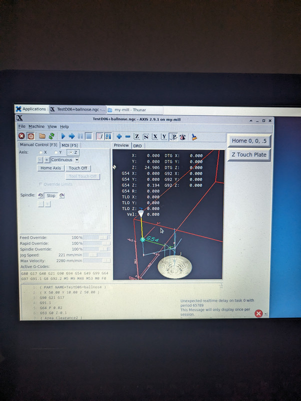

Ok lads, I've found it. The issue was caused by using
REMAP=M6 modalgroup=6 ngc=touch_plate
I've added it because after each tool change I would like to use touchplate to measure tool.
What I'm doing wrong? Any help?

Looking at your hal file, I don't see any links for limit switches for the Z axis:
Then in your ini I see you have HOME = 25 and HOME_OFFSET=25 yet you have not set any homing velocities, which makes me wonder how you home your z-axis?
setp stepgen.2.position-scale [JOINT_2]SCALE
setp stepgen.2.steplen 1
setp stepgen.2.stepspace 0
setp stepgen.2.dirhold 70000
setp stepgen.2.dirsetup 70000
setp stepgen.2.maxaccel [JOINT_2]STEPGEN_MAXACCEL
net zpos-cmd joint.2.motor-pos-cmd => stepgen.2.position-cmd
net zpos-fb stepgen.2.position-fb => joint.2.motor-pos-fb
net zstep <= stepgen.2.step
net zdir <= stepgen.2.dir
net zenable joint.2.amp-enable-out => stepgen.2.enable
#net max-home-z => joint.2.home-sw-in
#net max-home-z => joint.2.pos-lim-sw-inThen in your ini I see you have HOME = 25 and HOME_OFFSET=25 yet you have not set any homing velocities, which makes me wonder how you home your z-axis?

You are right, I've commented out my limitswitch on Z as I thought this config could be the reason for my issue with g54. I will bring it back.

Limit switches have no influence on your Z-offset but not properly homing your Z-axis certainly does.

Ok. I've enabled limit sw on Z axis and everything is correct.
After I add remap line, it is still wrong like on 1st screenshot. I've found out it is like that because of what I have in routines/touchplate.ngc.
Can someone point me where?
Is it missing G49? If yes where?
Ps. When I press on button to manually measure the tool it works like a charm. But in connection with remaping M6 it cause an issue.
All I want is if in gcode there is a tool change, lift z axis up, display message box to start manual change, measure tool in some position xy, measure using touchplate, display another messagebox with info to take touchplate, carry on the gcode.
