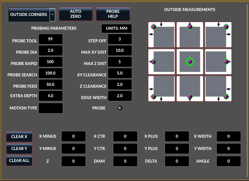

06 Feb 2025 02:10 #320808
Replied by cmorley on topic Versa Probe with Qtdragon hang
This is typical of the move length and speed not being finished in the timeout requirement.
But that seems strange on the latch return.
What version of linuxcnc are you using and can you post a pic of the probe settings you are using (when it failed)

06 Feb 2025 20:47 #320848
by h_munktell
Replied by h_munktell on topic Versa Probe with Qtdragon hang
- h_munktell

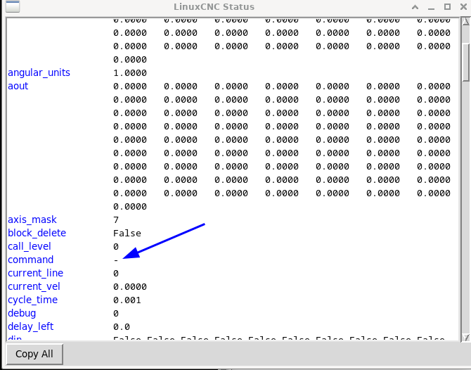

Made some progress on reproducing the issue:
forum.linuxcnc.org/qtvcp/57033-basic-pro...ails-on-latch-return
