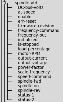

what about the gs2_vfd enable pin?

The 'gs2_vfd' component does not seem to have an 'enable' pin:

02 Sep 2024 08:33 #309200
by MennilTossFlykune
Replied by MennilTossFlykune on topic Modbus VFD startup delay?
Time to create page: 0.273 seconds
