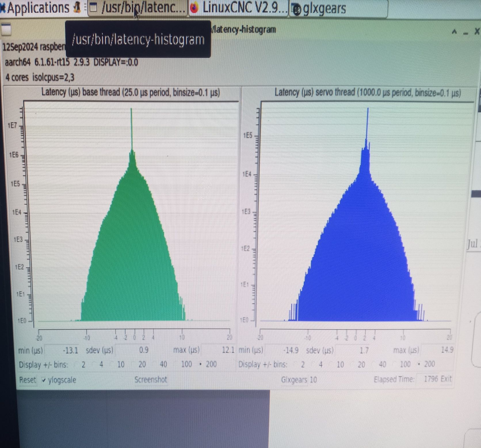

So one of the first questions that seems to crop up is latency/jitter and general performance of the RPI5 vs PC hardware and older RPI models.
I don't have an old pc available but i do have a RPI 4b and a PRI 5, both with 8gb of ram. and i can test the RPI 5 with and without the PCIE NVME hat to see if that makes any meaningful difference.
For fun i might try a usb bootable image for the laptop i used for Mach4 and Ethernet Smooth Stepper.
All will be tested with Linux CNC 2.9.2, SD card tests are done with a fresh image from the RPI Imager using the same sd card.
For the NVME test i have been playing with that install(2.9.2) for a few days (and the jitter looks worse for it I think).
All tests done with 10x glx gears running and Linux CNC guide open in firefox and scrolled around to get some idea of loaded up performance.
All RPI tests will be also using the same keyboard, mouse and HDMI + USB touch screen
As a side note the NVME drive seems to make the PI5 feel more responsive and quicker to bootup.

Well i have some results, but I'm not sure what they mean in real terms beyond the recomendations in the documentation. I would be curious to know how they compare to other peoples results.
DUT base thread (us) servo thread (us)
RPI 4b sd card -24.7 (sdev2.5) +79.1 -149.2 (sdev5.4) +148.6
RPI 5 sd card -23.6 (sdev 1.0) +19.3 -30.6 (sdev2.1) +31.6
RPI 5 NVME -13.1 (sdev0.9) +12.1 -15.7 (sdev2.1) +16.3
(left running for 7 hours, result above unchanged)
Going by linuxcnc.org/docs/stable/html/install/latency-test.html the sub 15 microsecond base jitter provided by the RPI 5 with NVME should allow software stepping and the hardware seems capable from this crude test.. And yes i did take a photo of the screen because i am a luddite.

Your latency looks fine for ethercat. To me it does not make sense to adopt ethercat and use another system for I/O. Use a ethercat I/O module

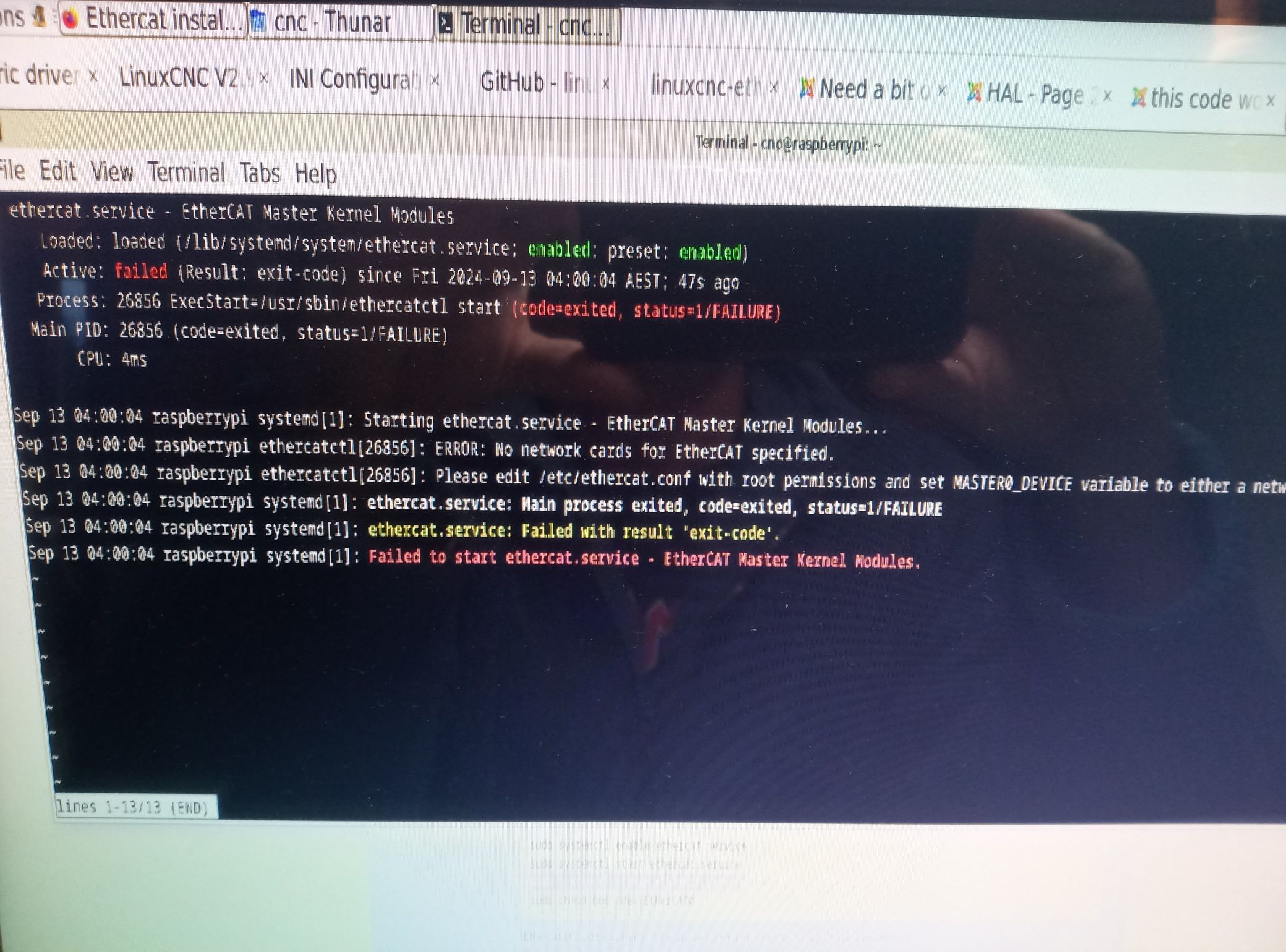

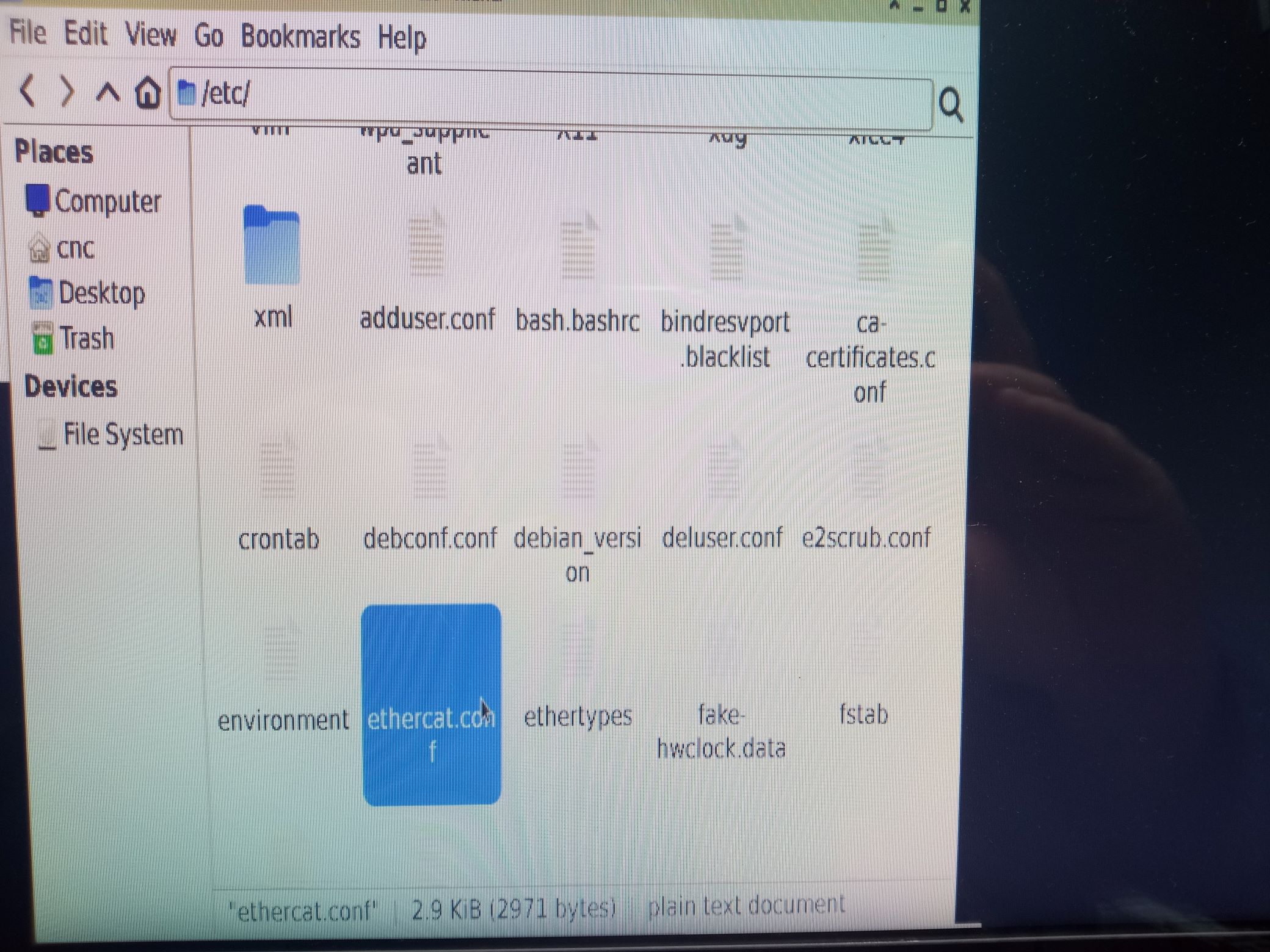

Establishing Ethercat communication is covered beautifully by forum.linuxcnc.org/ethercat/45336-etherc...-how-to-step-by-step
But for those like me who struggle with following instructions you might encounter the following error
because you failed to modify the ethercat conf file located
with
MASTER0_DEVICE="xx:aa:yy:zz:bb:cc"DEVICE_MODULES="generic"
beware that is might not show an error like this if you missed the DEVICE_MODULES="generic" line further down the file. but it did not behave as expected / work.
the end result of "sudo systemctl status ethercat.service" should look like this

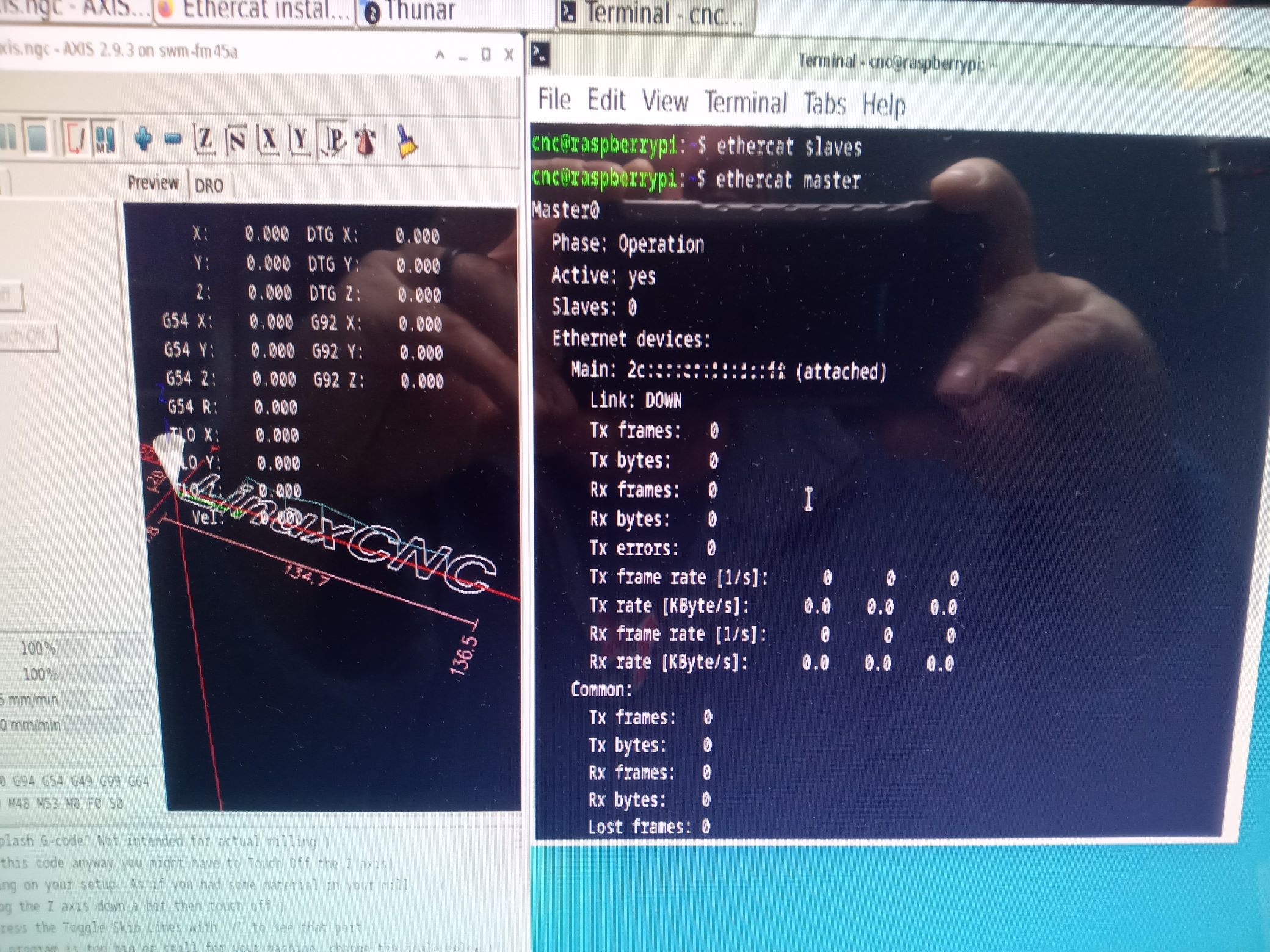

To confirm that Ethercat is trying to do something, but without any slave devices attached the command " ethercat master" should provide some conformation that something is going on. the output of the command should appear something like this.
