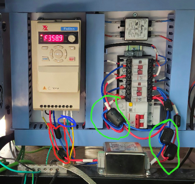

I am getting some pretty ridiculous EMI from my VFD and I'd like to try add debounce so I can cut parts again. Long story short, my hard drive failed so I got a new PC setup, copied all of my machine settings and it doesn't work. EMI for days but only if my VFD is running!!! Even with 3 line filters on all of the 110/240V circuits. Missing steps and sounds horrible.
Could someone be so kind to review my INI and let me know how to write a good debounce code for it?

Replied by PCW on topic Another EMI issue
Sounds like EMI in the step/dir lines which debounce will not help.
Debounce can help with noise on the limit switch and probe inputs
but that's it.
For noise on the step/dir signals you need to make sure that they are not
routed near wires connected to the VFD. Also a common mode choke
(giant ferrite bead around the U,V,W motor leads) can help reduce radiated
EMI. Also if you are controlling the VFD speed/direction make sure the control
logic is isolated. If not isolated, you can help reduce introducing noise into
the control system by adding common mode chokes to all the control wiring
going to the VFD.

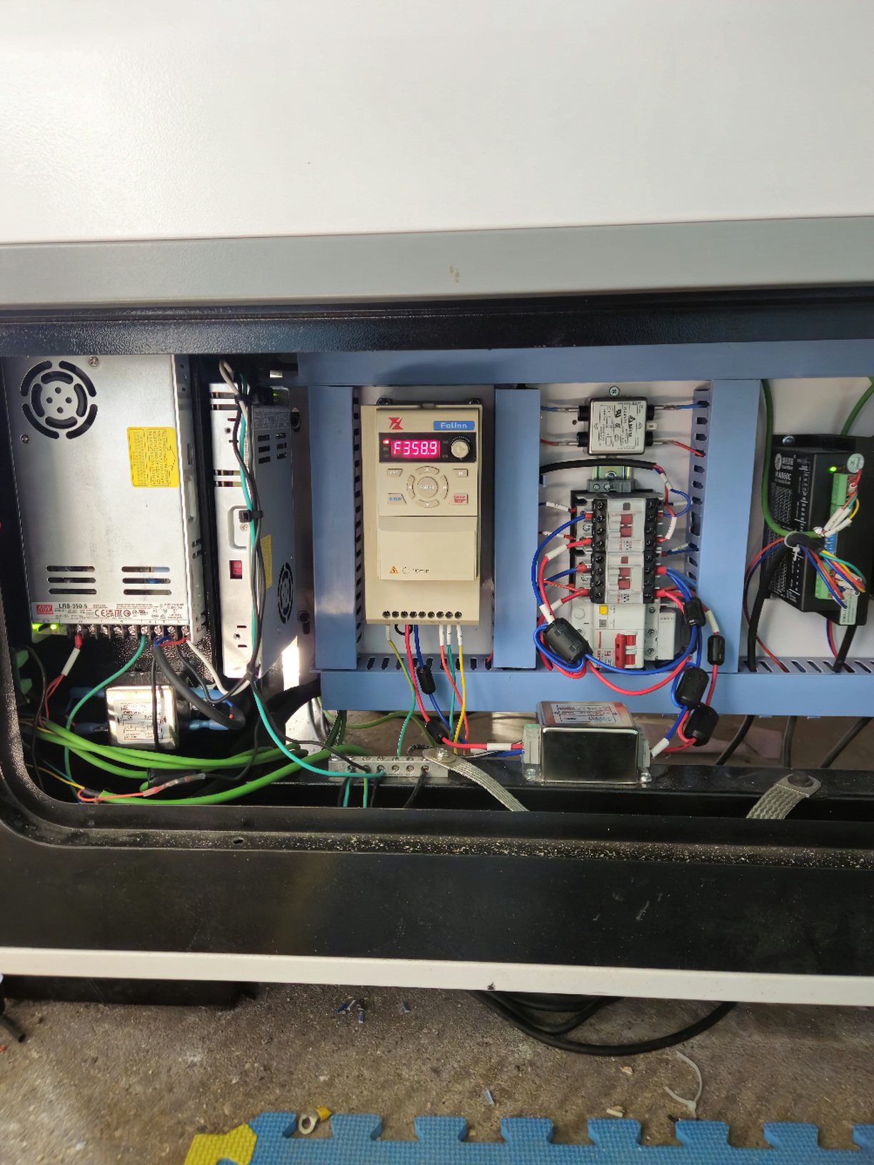

Replied by tommylight on topic Another EMI issue
From your description, no amount of debounce will help, so where did you get the idea that it will?
It would be more helpful if you upload the pictures of the wiring, detailed ones, but in the mean time:
-make sure the PC is grounded properly
-make sure the VFD is grounded properly
-power supplies that can be grounded should be grounded
-use shielded cable for the spindle, shield bolted to motor and to VFD
-using a ferrite bead (doughnut) on motor wires at the VFD side helps

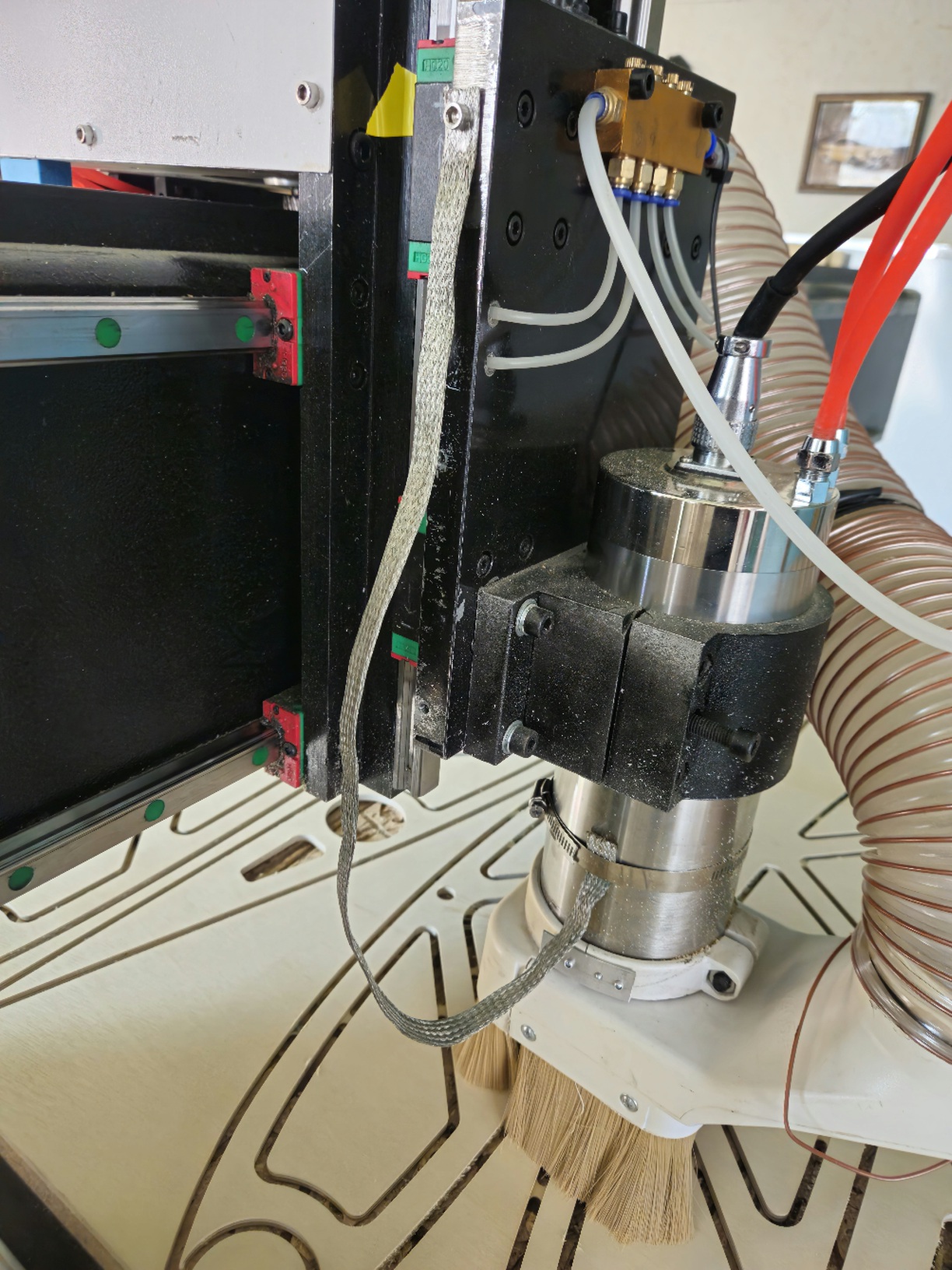

Replied by flychris on topic Another EMI issue
Alright. Grounded every component like it should be, including one end of all my shielded wire. Cleaned up the signals very good! I even have tolerances to where i need them. I do get an occasional limit switch or probe trip a program, so a decent debounce should help me. Could someone write one according to my INI. I feel like I have the concept, but the parports get me to wonky.
- flychris
- Posts: 3
20 Oct 2024 19:32 #312706
by flychris
100% solved. Grounded every component to a ground distribution block. Used tinned copper braided wire and grounded the grounding block to the chassis and the spindle to the gantry. Then added a simple debounce to my probes and limit homes. It's all good to go. Right back to .0005" tolerances. Thanks for the support
