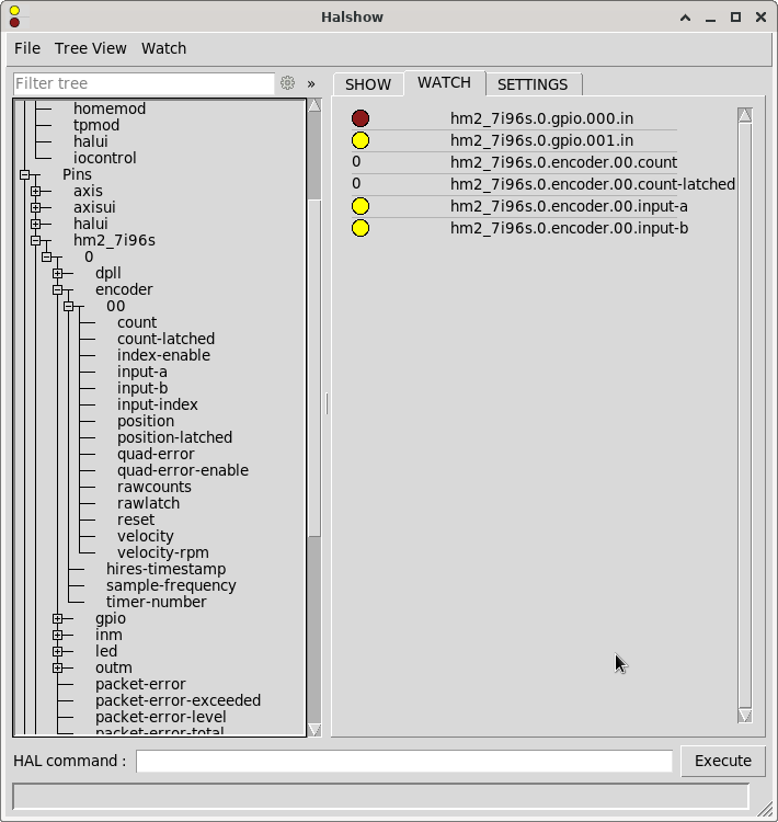

I have a glass scale connected up to inputs 0,1
I don't see them in HALshow. (I do see .encoder.00 however it does not seem to be linked to input 0,1), I think that's probably the spindle data.
How would I go about:
1) just viewing and scaling the quadrature data?
2) displaying the scaled value in axis?
Replied by slowpoke on topic 7i96S MPG input

The MPG encoders are part of the inm module, so in halshow,
select hm2_7i96s.0.inm.00.enc0-count
Note that these are just raw counts and would need
the scale component to scale to position.
It might be easier to have some normal encoders brought out on the
parallel expansion connector since standard encoders have scaling built in.
