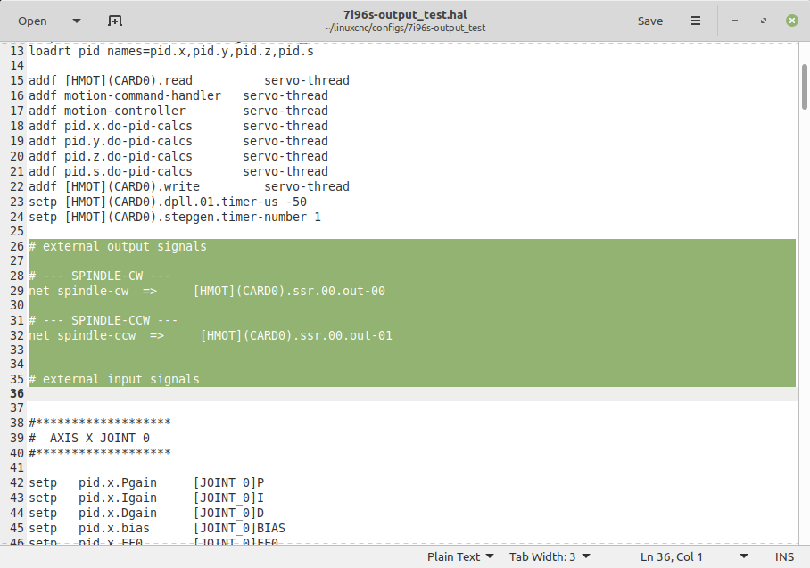

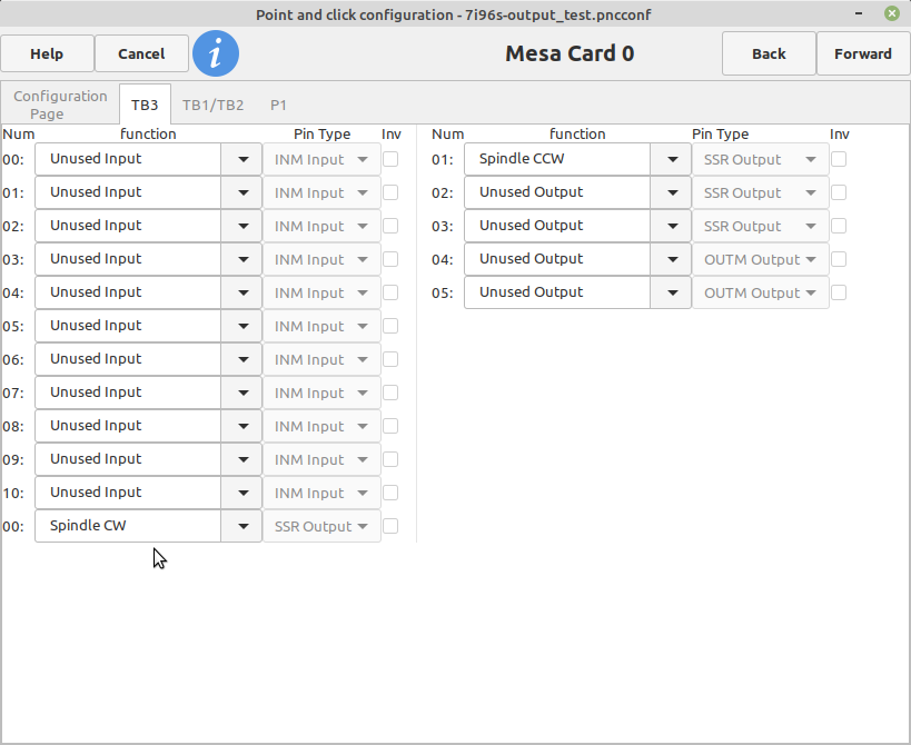

Replied by Pieter69 on topic Pulling out my hair trying to set up a spindle on 7i96
i dont know if this is a bug in pncconf or with my setup, but i had the same problem as you. I connected the enable spindle on tb3 13 and 14 and configured in pncconf the pins out0- and out0+ as the enable spindle. didnt work at all. the moment i connected them with out1- and out1+ (TB3 15 and 16) but kept the configuration in pncconf to out0- and out0+ it worked. I expect there is a mismatch in pncconf between the numbering of the outputs and the pin layout of the mesa 7i96s. Not sure why but it worked toi enable the spindle (though no speedcontrol yet)
