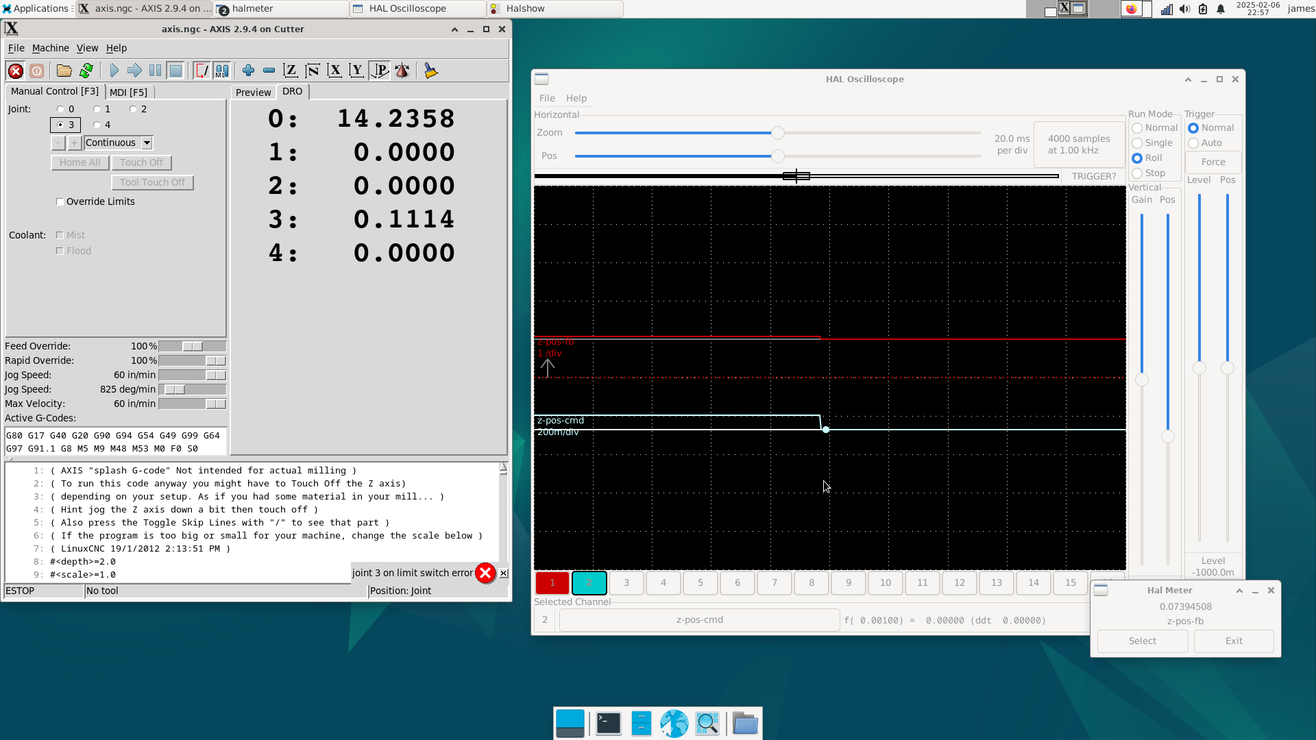

Hi Friends,
I am pulling my hair out with the Z portion of the homing sequence and could use some help. Currently i have my limit switch as the 'max-limit' for the Z axis. Prior to pressing Home All i am able to Jog the z axis and it works as expected (- is down, is up). 0 is max and -4 is min (this might be the root of my headache)When i press home all, it searches up and makes contact, backs off, and seems to continue through the switch in the positive direction. Per the homing configuration (linuxcnc.org/docs/2.7/html/config/ini-homing.html ) this shouldn't be happening because my search and latch vel are the same sign.

A halscope plot of Z position and home switch state
when homing would be helpful for debugging.
(Perhaps triggered by the home switch state)

I had tried flipping the 'final vel' as a last ditch effort, with out reading that it would result in an error and it didn't change anything nor throw an error.
I didn't even realize that was possible. Let me see if I can figure out how to do that and post it here.

07 Feb 2025 06:03 #320887
by notJamesLee
Replied by notJamesLee on topic Z Homing

It all does happen fast, you'll see i had to move X (joint 0) way out so I could observe Z (joint 3) which errors out at 0.114
I swore i tried inverting that sign because i had the same idea. However, it didn't change the z motor going in the wrong direction after. I will try again here in an hour or so and update.
Also reading 6.3 here (linuxcnc.org/docs/2.7/html/config/ini-homing.html) that value must be positive. Even though it didn't throw an error when i tried. I imagine it just take the absolute value of that number? It seems like i have to invert almost everything.

I've tried a bunch of more things.
I noticed it could possibly be a wiring issue but that just flipped the directions so you'll notice that the scale now has a different sign. I thought maybe i was getting confused by the min/max and it largely operating in the negative domain so I just changed it to operate from 0 ->4 and the max is 4.
I also messed around with the 'home offset' alot. trying 0, 0.1, -0.1, 3.9, -3.9 and no dice, so its now at 0.The last thing i changed was 'home' in the section above as a last ditch effort. I changed it to 4. The logic is when it hits the switch it considers max that it should do its final approach thing, back off then consider that home and set the DRO to 4. This isn't what happens.
I noticed that when Z is homing, as soon as it hits the switch the DRO changes to zero and not 4. This is the opposite of what we'd expect but clear I've fat fingered something. Attached is the latest .hal and .ini .
