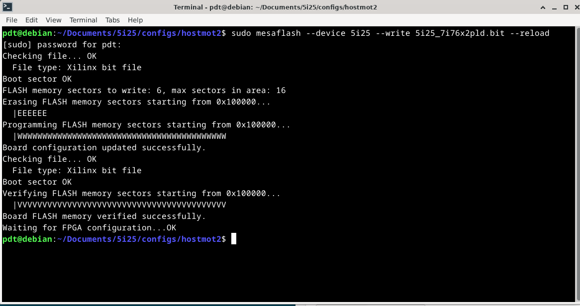

23 Mar 2025 19:21 - 23 Mar 2025 19:28 #324686 by mmt
I'm trying to get this working. Ive read most of the other relevant threads and the documentation.
I have flashed the 6i25 with 5i25_7i76x2pld.bit
here is my hal and these are the only code i have that references pwm

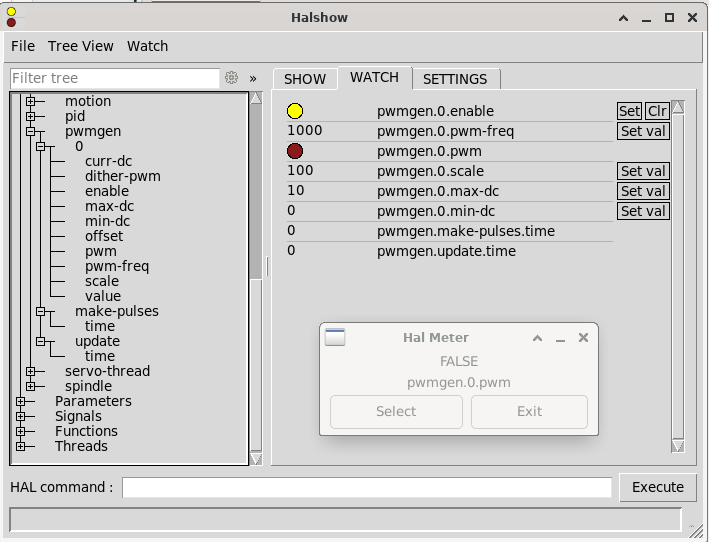

i get this error
/Laser.hal:26: parameter or pin 'hm2_5i25.0.pwmgen.00.pwm_frequency' not found
and also tried halshow

23 Mar 2025 21:05 #324695 by tommylight
Replied by tommylight on topic neeed help with additional pwm 6i25 and 7i76
Omit the offending line and try again
from
setp hm2_5i25.0.pwmgen.00.pwm_frequency 1000
to
#setp hm2_5i25.0.pwmgen.00.pwm_frequency 1000
I am pretty sure that is for plasma systems, so the spindle encoder inputs are NOT A/B/Z, but are A0/A1/A2 for 1 to 3 of THCAD.
Anyone, do correct me if that is wrong.
Thank you.
23 Mar 2025 21:28 #324697 by PCW
Yes,5i25_7i76x2pld.bit is a plasma configuration with no PWM
5i25_7i76x2_2pd.bit is a 7I76 configuration wit the last 2 stepgens
per 7I76 replaced with PWM/DIR
(so you don't need the software PWMgen)
24 Mar 2025 20:34 #324819 by mmt
ok my mistake i had/have the 5i25_7i76x2_2pd.bit in the 6i25
so my original post is still the same
thanks

24 Mar 2025 22:06 #324835 by PCW
That's the plasma config, the configuration with 2 PWMgens per 7I76 is:
5i25_7i76x2_2pd.bit
24 Mar 2025 22:24 #324837 by mmt
that worked sorry for the mix up
thank you
