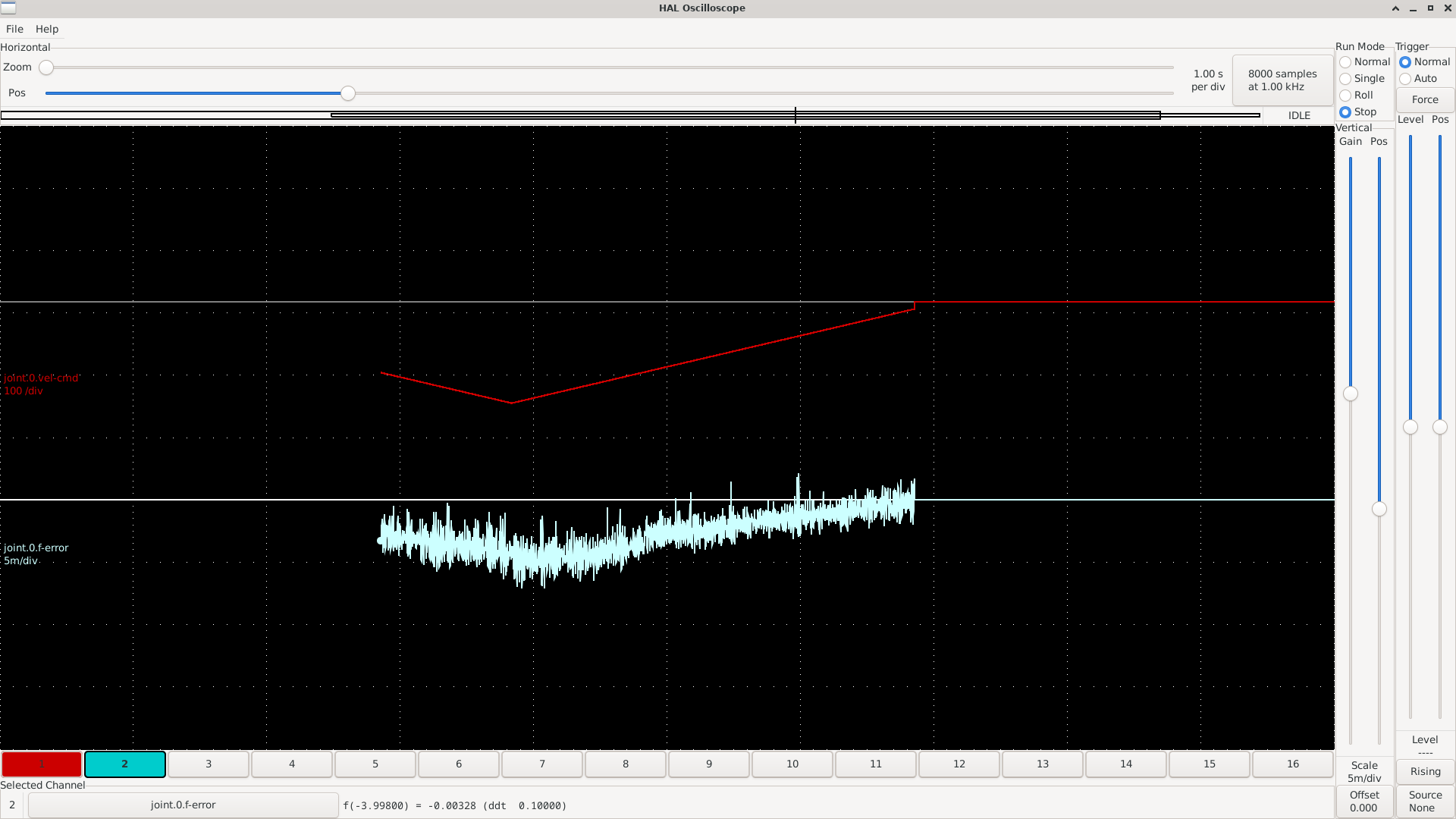

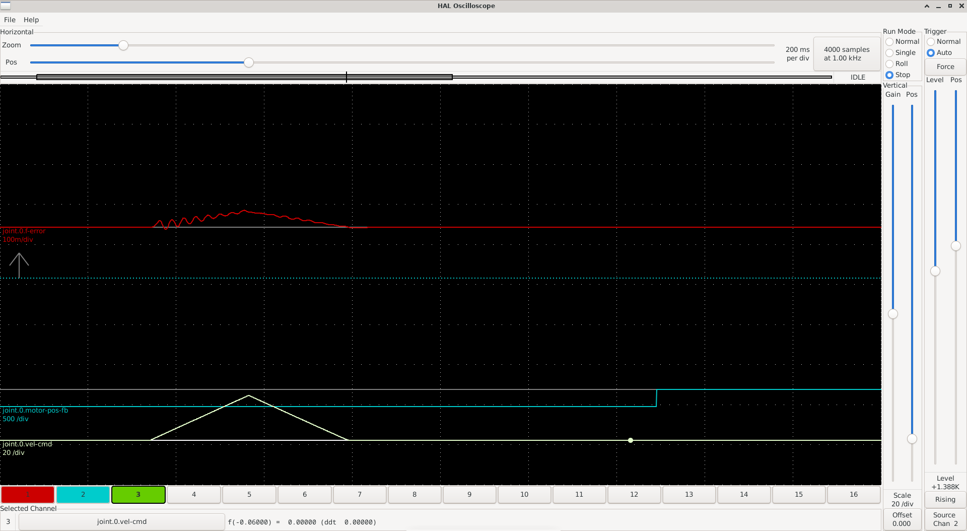

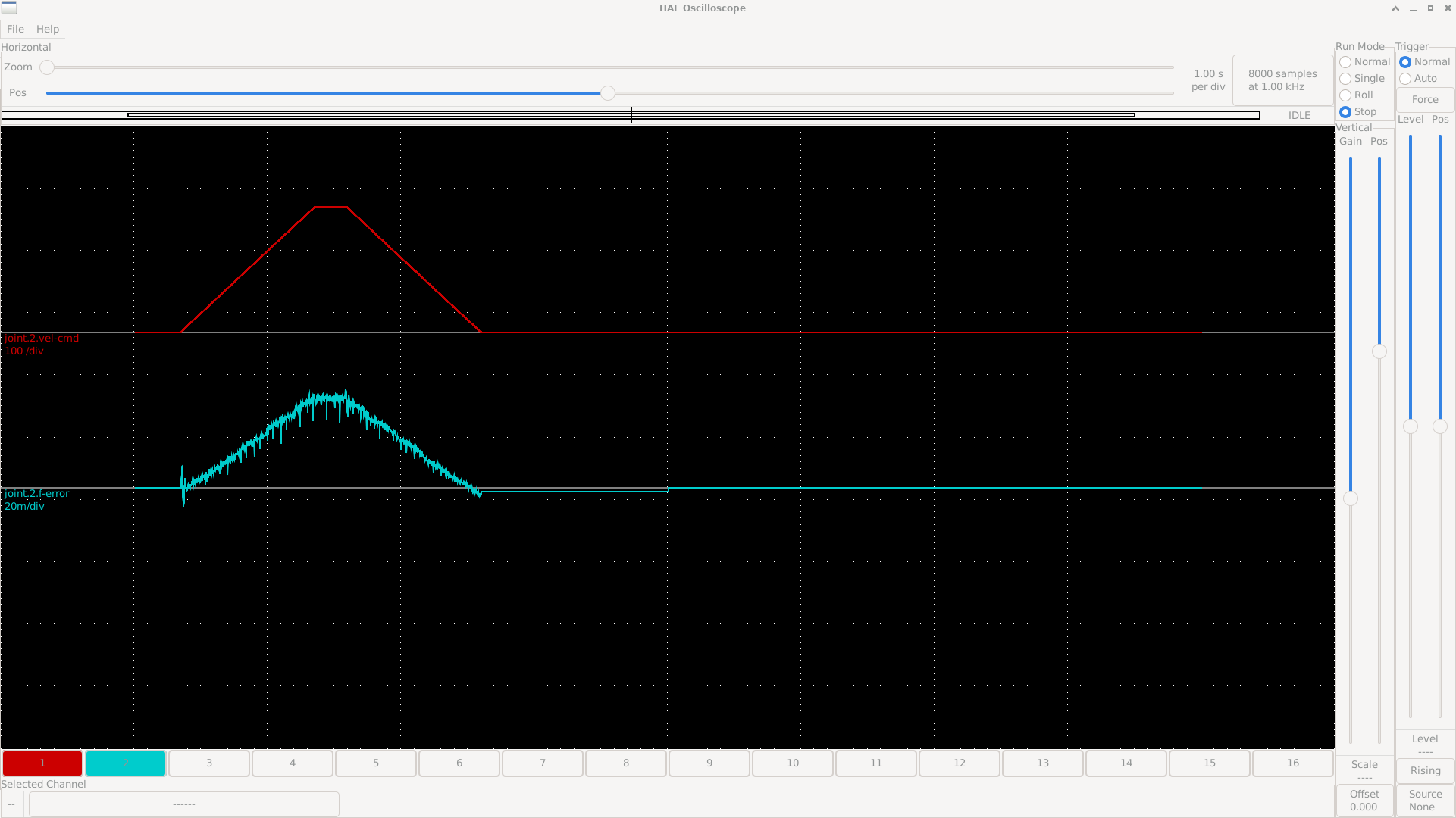

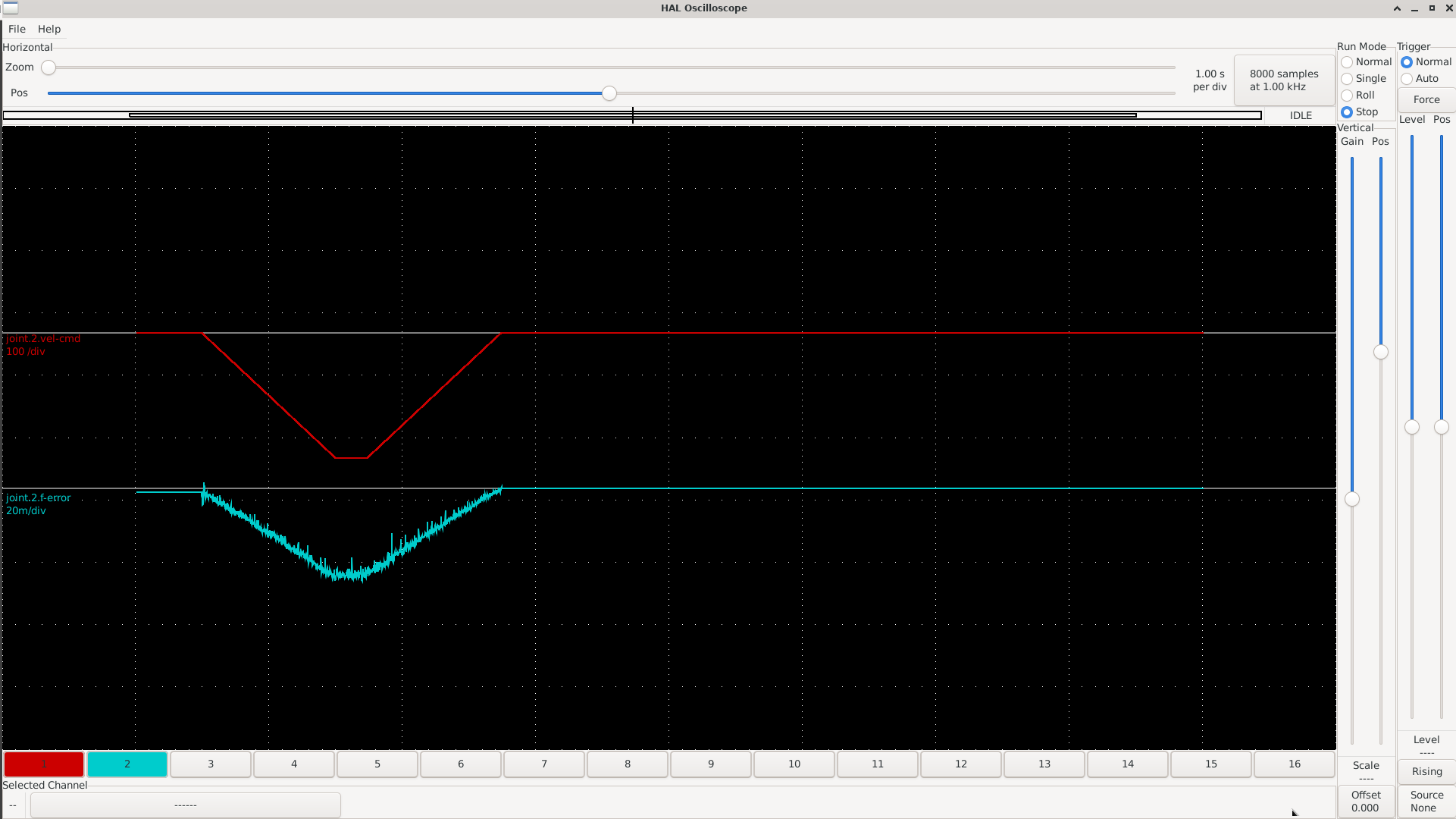

I am a newbie to Servo tuning. I made a linear guide (Travel length: 500 mm) and attached servo motor to it.
Servo Motor: Inovance MS1H2-10C30CB-A331Z-INT with 23 bit encoderServo
Drive: Inovance SV670P
Mesa card:7i97T
Servo drive is configured in speed mode and controlled through analog voltage - 10V. Followed the Servo tuning guide from this forum and tuned the P, FF1, FF2 values. Tuned with a displacement of 5mm.
This setup works upto 3000 mm/min for both continuous jogging and fixed length. Above 3000 mm/min, i am getting Joint-0 following error during continuous jogging and less error for small lengths and frequent errors for larger lengths.
I doubt whether the tuning is correct or not. Help me to solve this issue.
I have attached servo drive manual, INI file, HAL file and Hal Scope screenshots at 2880 mm/min and 6000 mm/min for both 5mm and 50 mm jogging.
Thanks in advance.

It looks to me like the FF1 term is different (too low) in the plots where the following
error tracks the velocity (higher velocity plots) Did you change some drive parameter
in these plots?
Also note that the velocity is not higher in the 6000 mm/m plots as it only gets to ~50 mm/s
(3000 mm/m) because of the acceleration bound
in these plots?
Last edit: 28 Apr 2025 15:07 by PCW.

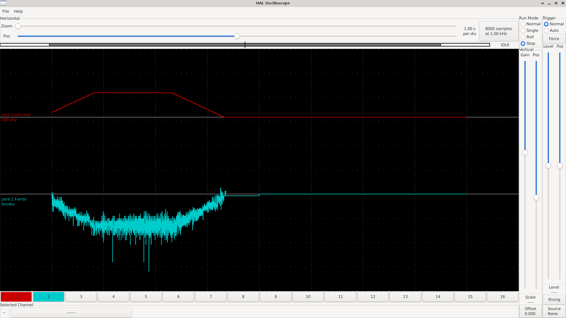

Hi Tommy and Peter. I took some time and tuned all three axis. Now i can jog continuously all three axes. I have attached halscope screenshots of all three axis. Can you please check whether the tuning is good or more need to be done ?
- Posts: 18093
- Thank you received: 5325
19 May 2025 23:31 #328762
Replied by PCW on topic AC Servo tuning - Joint 0 following error at high velocities
Looks good, though probably needs a bit more FF1 tuning.
Are you using the "Calibrate" menu?
This makes it easy to adjust PID parameters while running.
If the following error is in the same direction as the velocity,
FF1 is too low, if the following error is in the opposite direction
of the error, FF1 is too high.
The following user(s) said Thank You: abi9624
