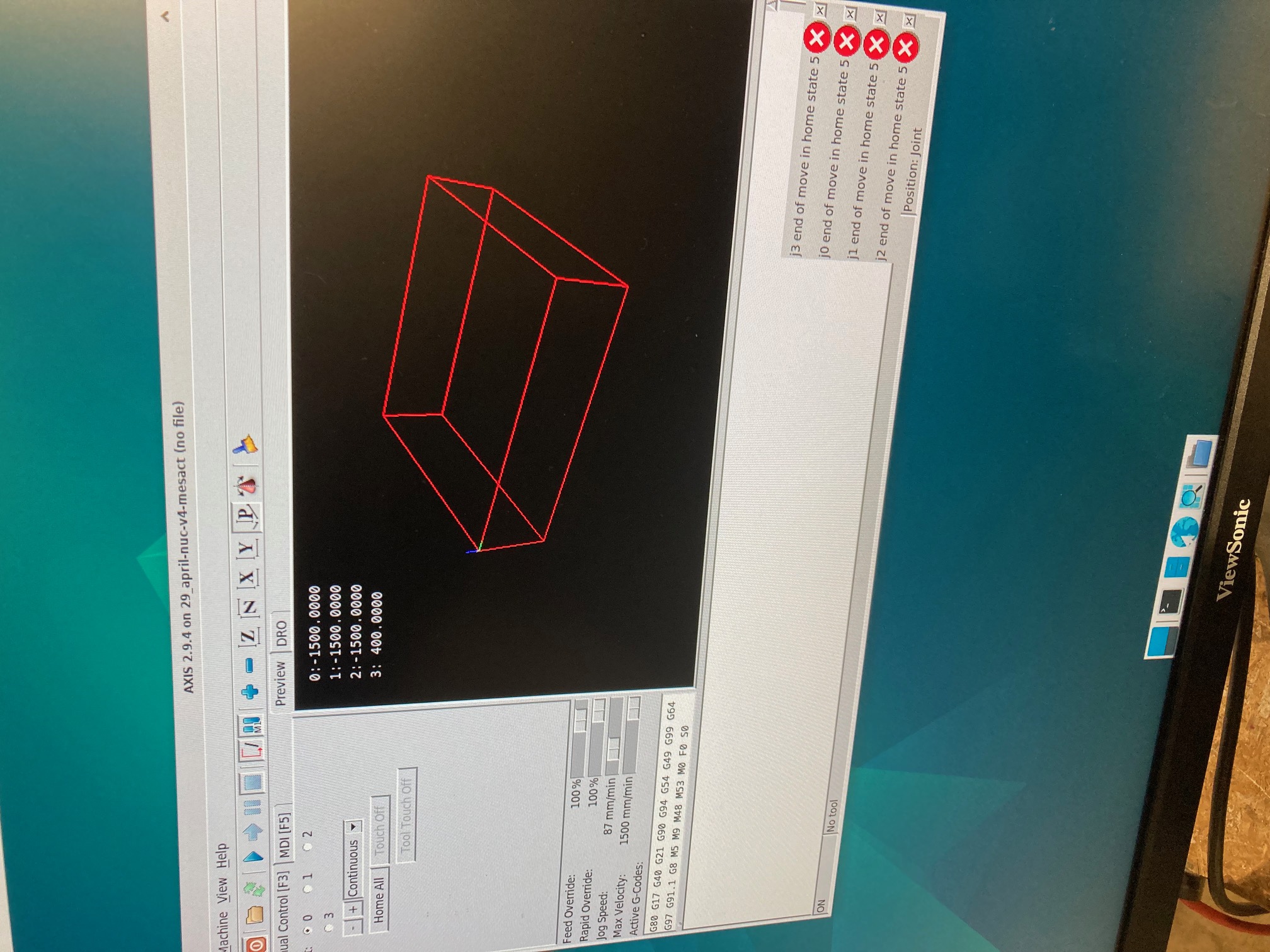

The Linuxcnc dro counts on the screen, but the actual motors don’t move.
It looks like It counts in all axis until the software limits are reached, then errors.

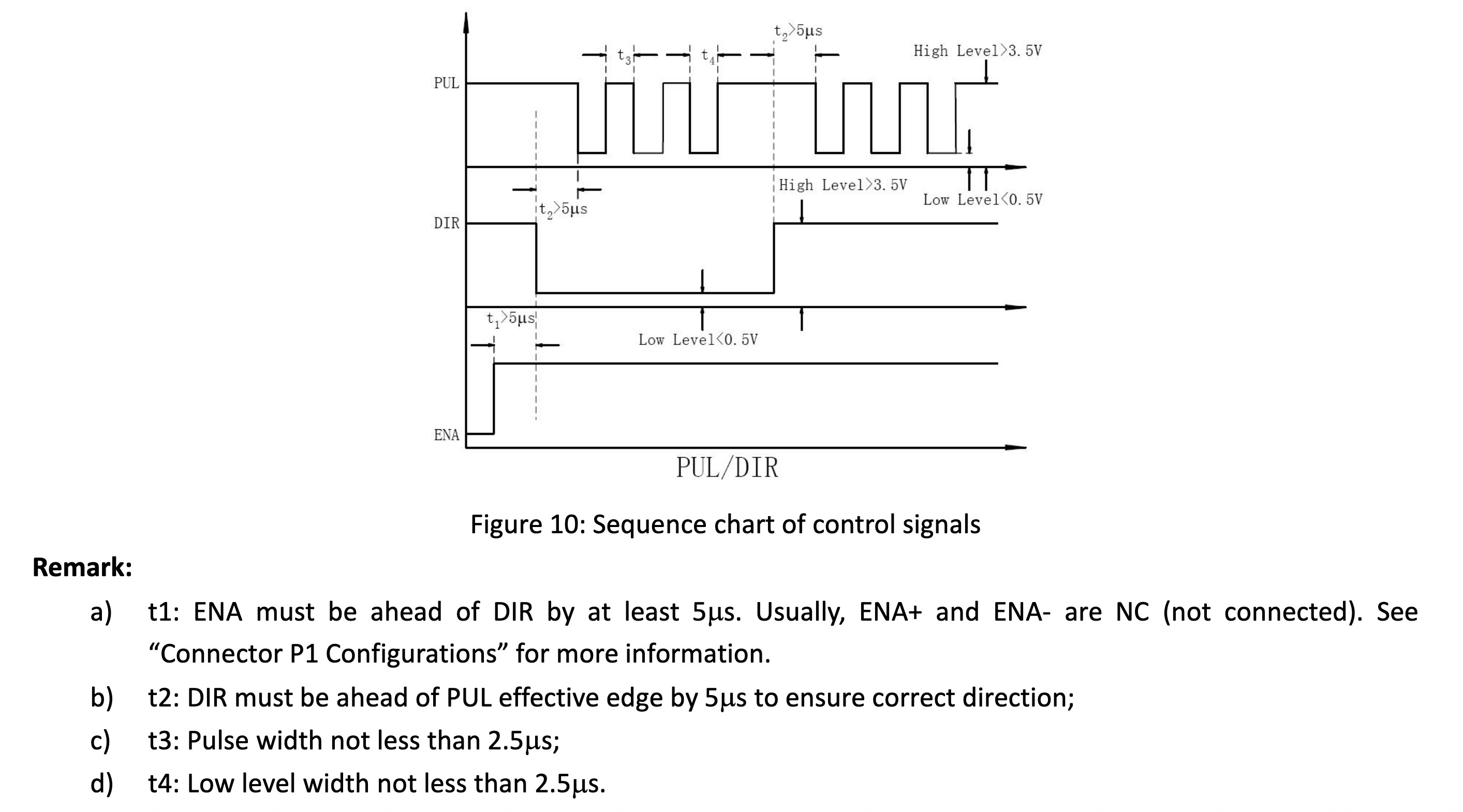

I would first try setting the step time and step space to 5000 (5 usec)
since 2500 (2.5 usec) is the drives minimum (0 margin)

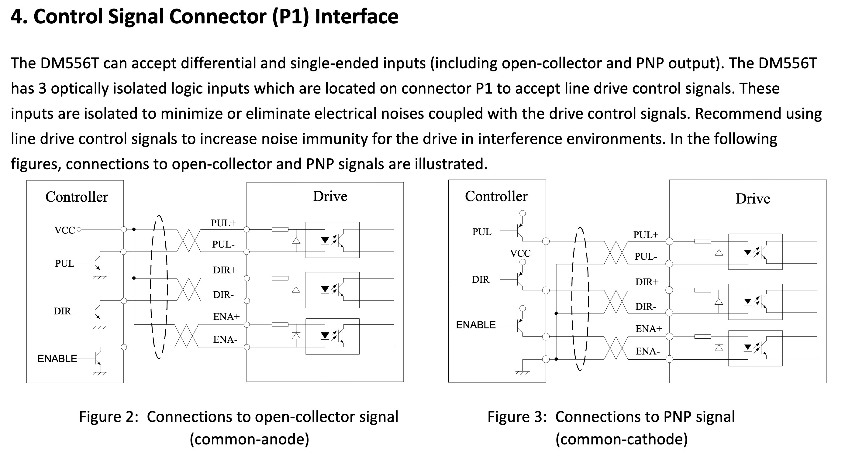

I tried this
Mesa 7i76u TB2 axis to DM556T signal in.
Differential wiring:
GND
STEP- to PUL-
STEP+ to PUL+
DIR- to DIR-
DIR+ to DIR+
+5VP
(with ENA+ and ENA- on DM556T not connected)
I tried the same as above with
GND wired to ENA-
then
+5VP wired to ENA+
then
with both wired.
See Control Signals image which shows two different wiring for single ended.
I don’t know which type the Mesa 7i76u control uses, but I tried both of these.
Open-collector signal ties +5VP to PUL+ , DIR+ and ENA+
PUL- to PUL-
DIR- to DIR-
PNP signal ties GND to PUL-, DIR- and ENA-
STEP+ to PUL+
DIR+ to DIR+

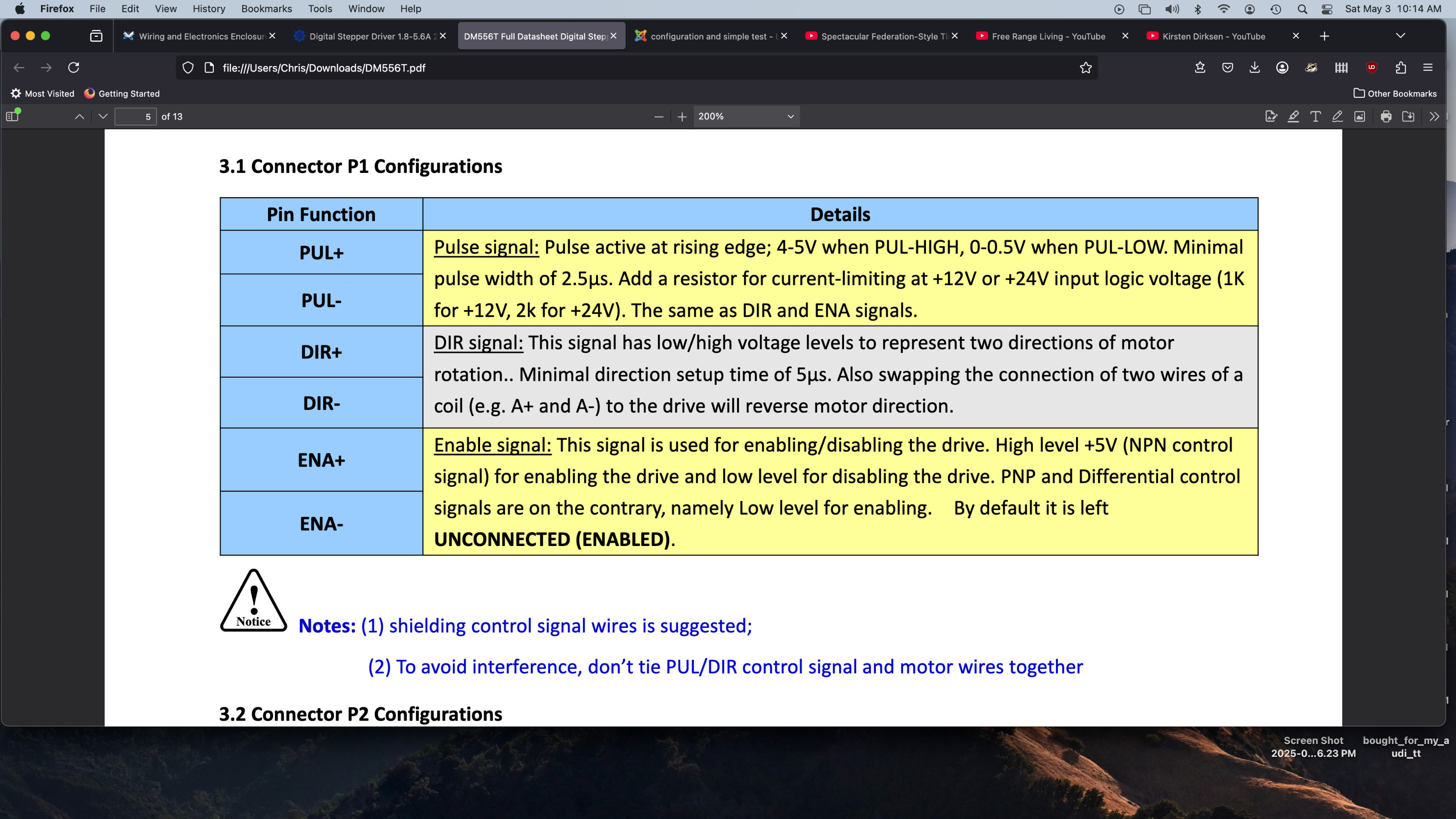

Enable_disable image mentions this …
Enable signal:
This signal is used for enabling/disabling the drive.
High level +5V (NPN control signal) for enabling the drive, and low level for disabling the drive.
PNP and Differential control signals are on the contrary, namely Low level for enabling.
By default it is left UNCONNECTED (ENABLED).

Do not wire Enable until you get things working.
- Posts: 18093
- Thank you received: 5325
03 May 2025 18:25 #327623
Replied by PCW on topic None of the axis are moving - using mesa 7i92t with 7i76u
Yep, on simple step drives, its a DISABLE input.Do not wire Enable until you get things working.
