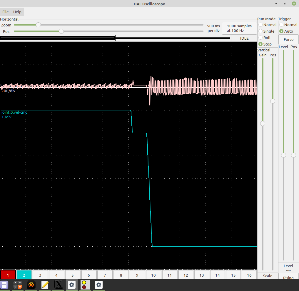

I'm using a Raspberry Pi 4 to drive a Mesa 7i96. For unknown (as yet) reasons, I can't reliably run without errors unless I bump SERVO_PERIOD to 2000000 (i.e., 2ms).
What affect will this have on machine operation? I sort of understand what's scheduled to run in the base thread, which of course is largely (completely?) irrelevant now that I have the Mesa. But I don't have a good mental model for what runs in the servo thread, so I don't have a good understanding of what happens to operation/performance if it only runs half as often as usual. Where would the difference show up?
Until recently my mill maxed out at about 40ipm, so absolute performance wasn't really a consideration. I've upgraded to a machine capable of at least 80ipm using Grbl, and initial tests with LinuxCNC and the Mesa card indicate 100ipm may be fine. So now I'm wondering if I need to start worrying more about that servo thread.

18 May 2025 12:06 #328687
by pgf
Okay, that's interesting, and of course I have more questions.
First, does the Mesa know how many steps it should count? Will the longer period introduce greater error in the length of each chord? I.e., might it overshoot by 1ms worth of steps, vs. just 500ns worth of steps? Or is the command to the Mesa really just "start moving at N steps/second"? (rather than "start moving at N steps/second, for 10500 steps")
Second, the chord error you describe would only occur for a curved path. If the G-code is written completely using straight-line approximation (which of course introduces its own chord errors), it seems like the longer servo period wouldn't introduce any more error at all. True?
In any case, it sounds like I can stop worrying about my 2ms servo period for the time being.

For Mesa step generation (others are similar) LinuxCNC creates a local feedback loop
where at every servo thread invocation, LinuxCNC reads the current stepgen position
and then sets a new velocity based on the current commanded velocity and with a small
correction based on the current position error. That is, at every servo thread invocation,
LinuxCNC generates a new position. Based on that new position and the current stepgen position
a new velocity is calculated to meet that new position at the next servo thread invocation.
With Mesa hardware the precision of the control loop is 1/65536s of a step, so typically
the error between the commanded position and the stepgen position is never more than
a fraction of a step.
Here is a plot of stepgen error at:
10 ms servo thread
1 IPS cutting speed
5 IPS rapid
50 IPS/S accelration
Note that Velocity is in IPS per division and error is in 20 uinch (~0.5 u) per division
The residual noise in the error is caused by timing uncertainty in the position sampling.
This is about 2 usec at a 10 ms servo thread but about 400 ns at a 2 ms servo thread
Even the chord error is nothing to worry about as long as you do not have extreme
acceleration (say > 1G)

Thanks! That first paragraph was gold. My understanding of how the whole thing works just went *way* up!
