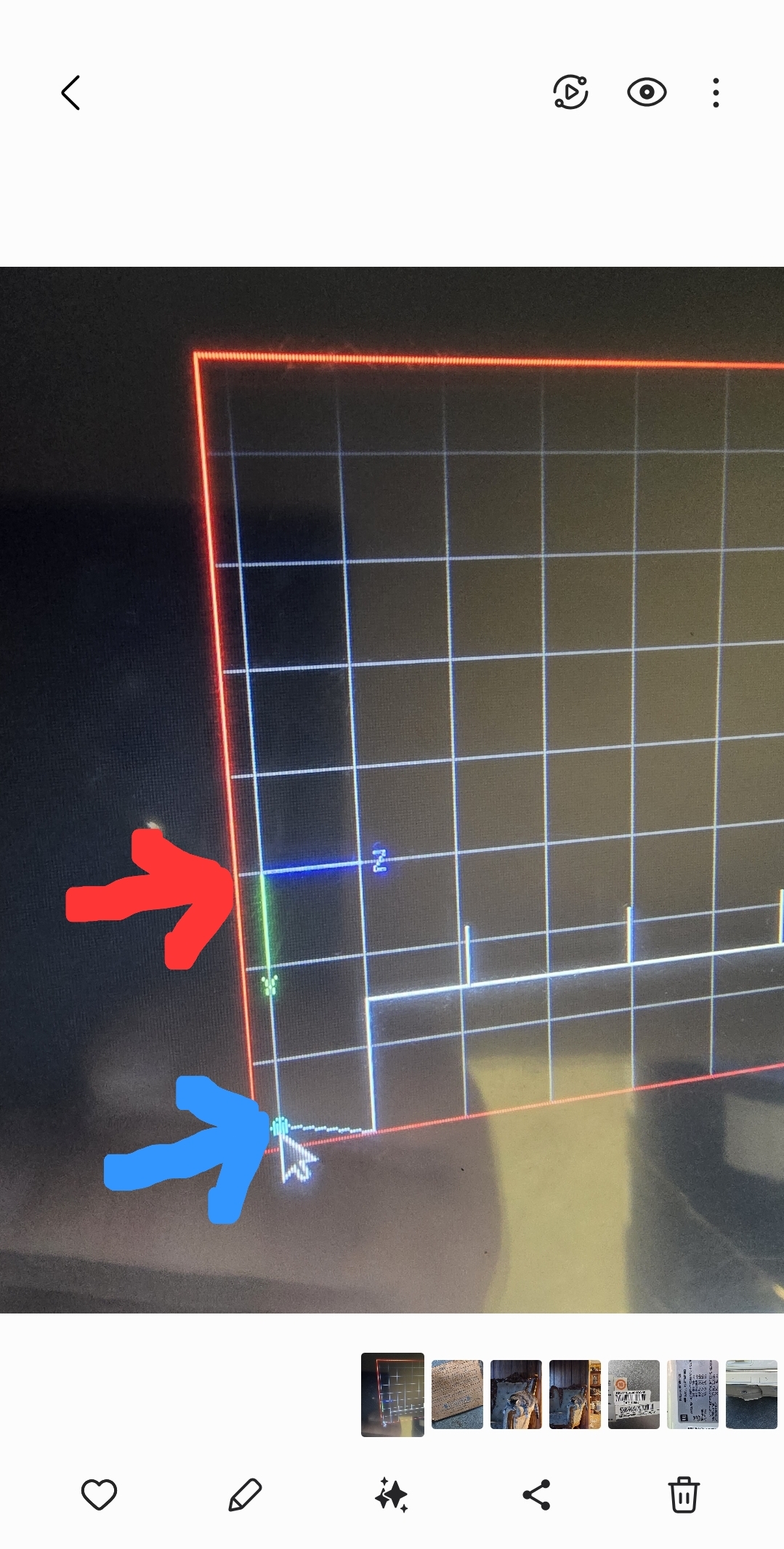

I believe I have just about everything I need figured out on our double gang grinder CNC lathe conversion as far as operation goes.. The only thing I have yet to figure is altering the position of the where the marker starts on the preview grid. I would really like to have the plot marker in preview to be in the middle of the X on the grid. Tool offset and home offset have had zero change to the position marker's start on the grid.

20 Jun 2025 11:57 #330569
by TheTinkeringMechanic1
Replied by TheTinkeringMechanic1 on topic Reposition Preview grid.
I apologize if I wasn't clear.
In the image you'll see a blue and red arrow I'd like to move them up on preview grid closer to the middle, as you can see the program path takes it right to the limit of the preview grid.

20 Jun 2025 12:39 #330570
Replied by Aciera on topic Reposition Preview grid.
All these elements are drawn to represent your machine limits and offsets:
The blue circle in the lower left corner is the home position.
The red rectangle shows the axis limits in respect to the home position (as set in the ini file).
The XZ coordinate system shows the current work origin (ie in your example you have an active work offset in x )

20 Jun 2025 13:28 #330572
That's the problem. It realigns the whole grid to wherever the home is set to. I can't find a way to move the grid itself. If I could keep the grid aligned with the physical home and off set the set home by 3-4 inches on the grid I would be happy. I can't seem to find a way to do that.

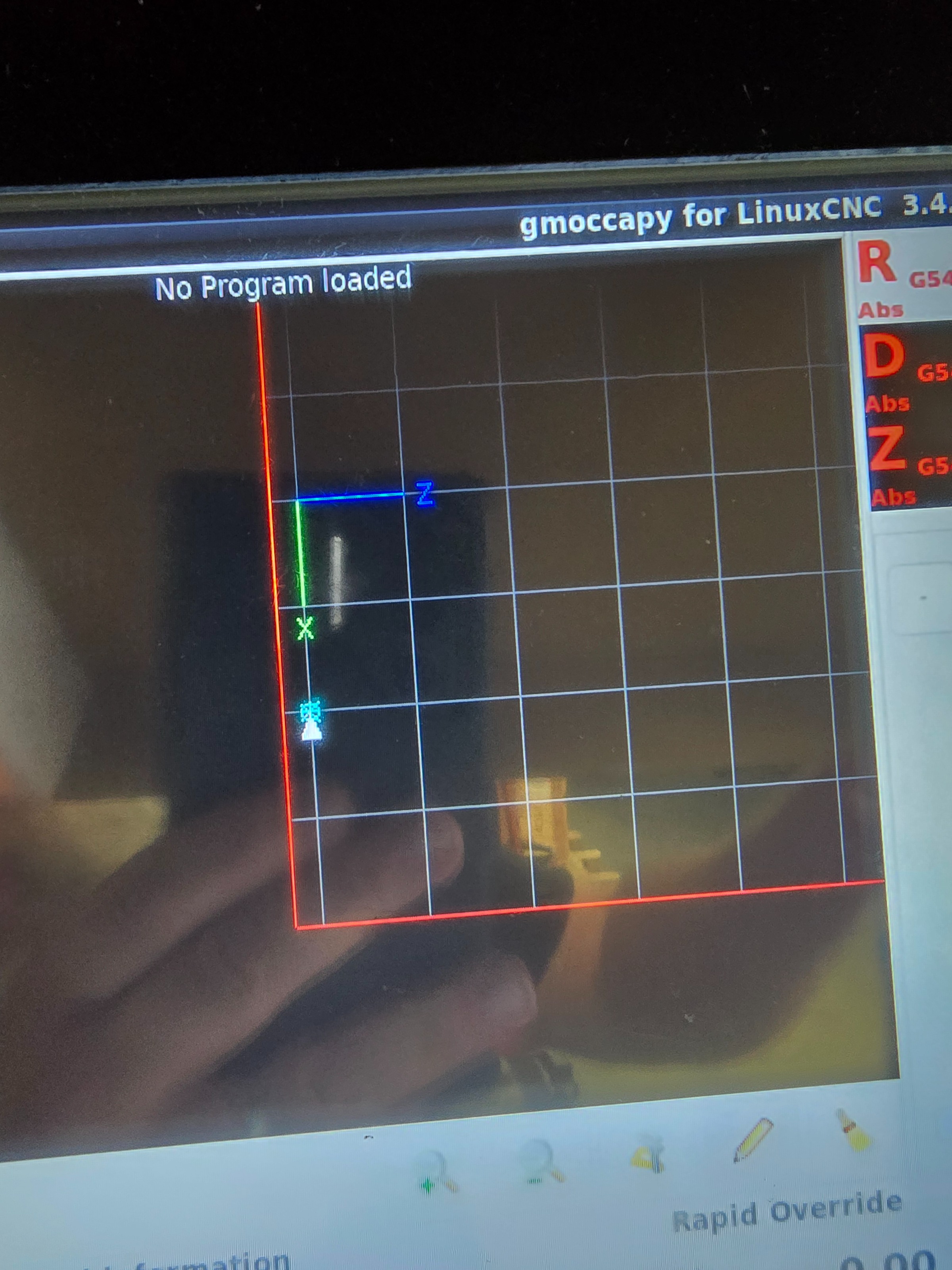

20 Jun 2025 15:19 #330580
I believe I figured it out. I was looking at it the wrong way. I needed to set the max limit in the ini file and then set the offset to move the home position further into the grid. I'm not sure if this is the correct way of doing, it but it got me the desired result.
This image shows my new position in the preview grid.
