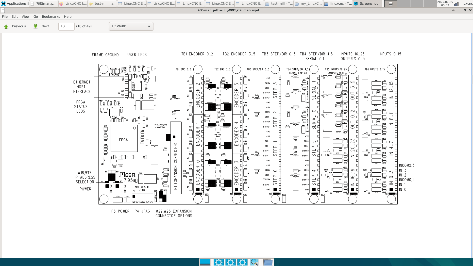

A quick scan of the 7i95 manual did not show any reference to an analog input, you may need to open a new discussion in the board interface section of the forum and see if there is a custom file that can convert one of 7i95 pwm pins to accept 5v analog input.

The 7I95/7I95T has no analog input so an encoder is probably a better choice
( Using either a high speed encoder or a MPG on the isolated inputs )
Another possibility is to add a 7I73 which has analog/encoder/keypad support

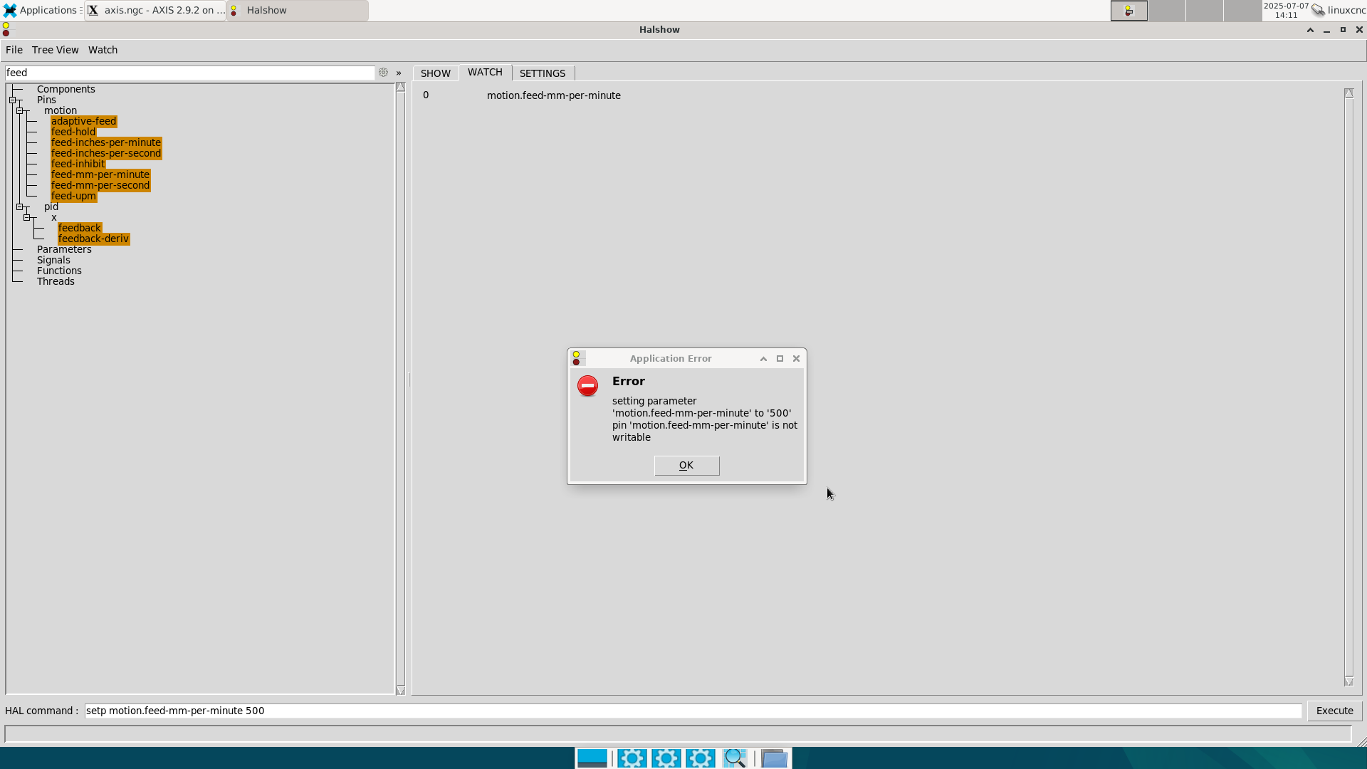

Another thing I was trying to identify was the pin/parameter that is responsible for feed override. In Axis GUI, there is a button for feed override, but I am not able to locate the corresponding pin and parameter in the Halshow Configuration window. I do locate one pin, but it is saying it is not writable. A screenshot is attached.

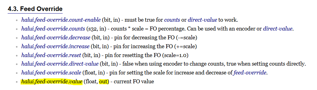

Earlier, the HALUI was not loaded, so I was not able to find the feed override pin in Halshow. Now I have added the section for HALUI and the corresponding pin (halui.feed-override.value) of the feed override is visible in Halshow. But this pin is OUT direction, which means not writable or can not change its value for testing in Halshow only. Attached is one image of the pins available under the feed override tree. I am looking for a pin that takes input and changes the feed override. kindly help! Or share the sample .ini and .hal files for the same purpose

If you use an encoder for feed override, the counts would connect to:
halui.feed-override.counts
