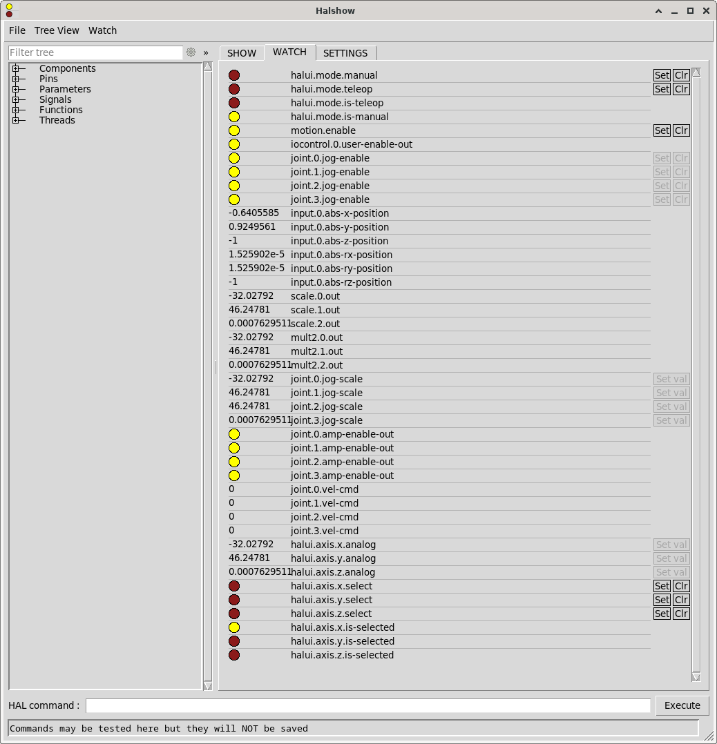

Hey,
I am trying to set up my xbox controller to jog a three axis machine (y-gantry). Using a bluetooth dongle I had to fiddle around a bit (and install xpadneo) to get the controller to connect to the system but I eventually got there and do see input when pressing buttons/moving the joysticks.
I was digging into LinuxCNC a few years ago but then life happened and I had to put the project on ice up until now. This is my first home-built CNC (wood router) and I am very new to all of this.
My goal is to be able to move the X, Y (gantry) and Z axis using the gaming controller when there is no gcode being executed.
Currently this is a parport setup and the stepper motors are not actually installed on ball screws so I do not mess up anything while testing. I am planning on switching to a mesa card in the near future.
xyyz.ini (machine basic setup)
xyyz.hal:
xbox.hal
With this setup I can see input from the controller in halshow:
However, joint.*.vel-cmd always stays 0 and obviously the stepper motors are not spinning. Also I am not sure what mode I have to use, but I also tried setting halui.mode.manual and halui.mode.teleop using the [Set] button in halshow, but this did not change anything.
Setting it up like this will not allow the machine to start when the Xbox Controller is not connected as it expects the controller to be found. The controller will shut itself off if not being used for a certain period of time and this will also result in an error popping up in axis ui.
I think my current approach is way more complicated and clumsy than it actually needs to be, but the learning curve seems to be pretty steep for me and therefore I probably resorted to using way more AI generated code than I should have.

loadusr -W hal_input -KRAL Xbox
loadrt scale count=3
addf scale.0 servo-thread
addf scale.1 servo-thread
addf scale.2 servo-thread
setp scale.0.gain 50.0 # X
setp scale.1.gain 50.0 # Y
setp scale.2.gain 50.0 # Z
loadrt mult2 count=3
addf mult2.0 servo-thread
addf mult2.1 servo-thread
addf mult2.2 servo-thread
loadrt conv_bit_float
addf conv-bit-float.0 servo-thread
net xbox-x-raw input.0.abs-x-position => scale.0.in
net xbox-y-raw input.0.abs-y-position => scale.1.in
net xbox-z-raw input.0.abs-ry-position => scale.2.in
net xbox-x-scaled scale.0.out => mult2.0.in0
net xbox-y-scaled scale.1.out => mult2.1.in0
net xbox-z-scaled scale.2.out => mult2.2.in0
net xbox-jog-bit input.0.btn-a => conv-bit-float.0.in
net xbox-jog-float conv-bit-float.0.out => mult2.0.in1
net xbox-jog-float => mult2.1.in1
net xbox-jog-float => mult2.2.in1
net xbox-x-vel mult2.0.out => joint.0.jog-scale # X
net xbox-y-vel mult2.1.out => joint.1.jog-scale # Y (Y0)
net xbox-y-vel => joint.2.jog-scale # Y (Y1)
net xbox-z-vel mult2.2.out => joint.3.jog-scale # Z
# Press [A]-button to enable joints
net xbox-jog-bit => joint.0.jog-enable
net xbox-jog-bit => joint.1.jog-enable
net xbox-jog-bit => joint.2.jog-enable
net xbox-jog-bit => joint.3.jog-enable
setp joint.0.jog-vel-mode TRUE
setp joint.1.jog-vel-mode TRUE
setp joint.2.jog-vel-mode TRUE
How do I
- set this up correctly so the Xbox Controller input can actually controll the X, Y and Z axis?
- set this up in a way so the controller does not need to be connected in order for the machine to start and won't result in an error when the controller disconnects for some reason

However, I played around a bit more and got a very basic setup that actually allows me to use the joysticks on the joypad to move the axis.
Switching the jog speed looks quite useful though, I'll try to adapt it. And also the dead-man switch is probably a good idea.
This is what I currently have:
Code:
net x-stick-in input.0.abs-x-position => scale.0.in
net y-stick-in input.0.abs-y-position => scale.1.in
net z-stick-in input.0.abs-ry-position => scale.2.in
net x-scale-out scale.0.out => halui.axis.x.analog
net y-scale-out scale.1.out => halui.axis.y.analog
net z-scale-out scale.2.out => halui.axis.z.analog
setp halui.axis.jog-speed 50.0
setp axis.x.jog-enable TRUE
setp axis.y.jog-enable TRUE
setp axis.z.jog-enable TRUE
