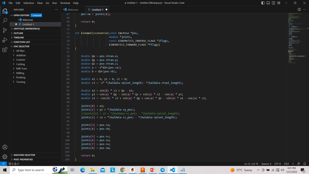

. I have looked at the Kinematics tutorial on the website, but I just learn better if I can see someone do a working example. After hours of reading that with Gemini helping with some of the explanations, I don't know how to start writing the code. Anyway, from the tutorial I posted earlier, there is an image of this person's kinematicsInverse function, which I will insert below.
From what I've understood, the job of this function is to understand the required tool tip movement and spit out the number of steps each axis motor needs to make, correct? If that is correct, I should be able to modify the trigonometry here to accommodate my ballscrew articulated B-axis and get this going, hopefully. Because his setup also has an XYZAB setup similar to mine.

Personally I would suggest tp use the .comp format:
linuxcnc.org/docs/2.9/html/man/man9/userkins.9.html
But regardless,
Forward kinematic uses the joint positions to calculate the cartesian coordinate positions
Inverse kinematic uses the cartesian coordinate positions (ie the position commands of the motion planner) to calculate the joint positions (ie basically the commands that get sent to your motor drives)
One needs to be the mathematical inverse of the other (otherwise the values will run off and you will get limit violation errors)
But regardless,
