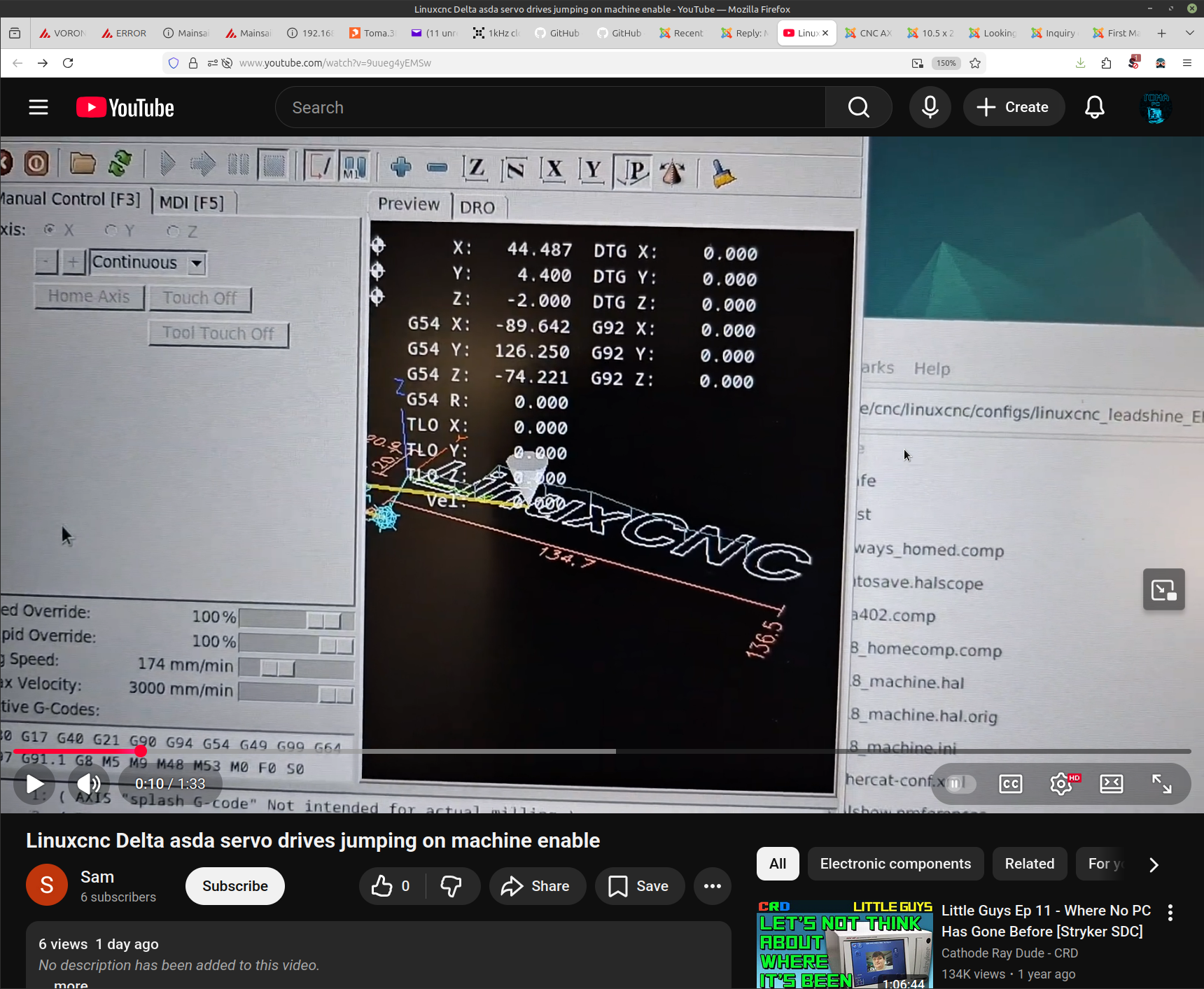

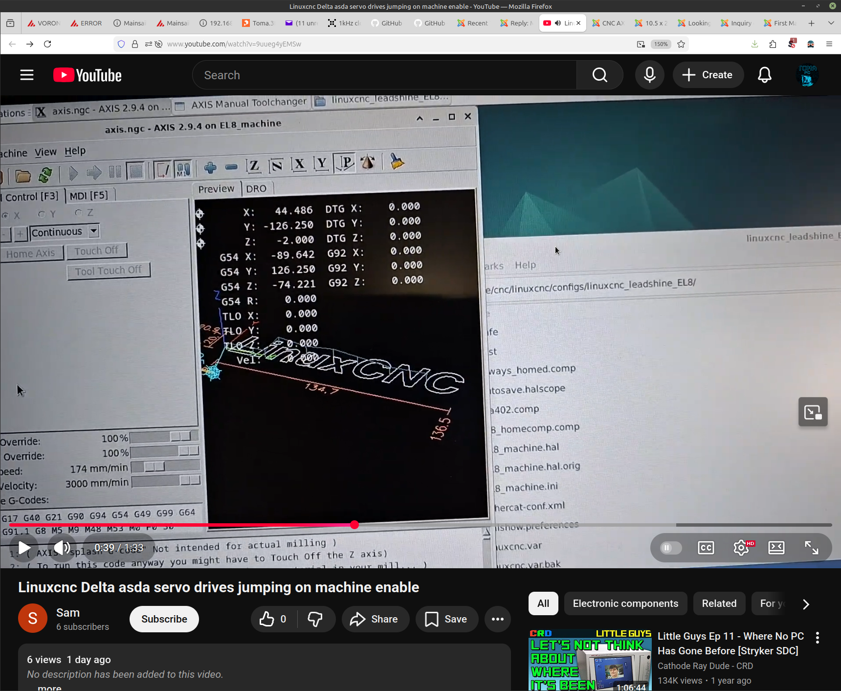

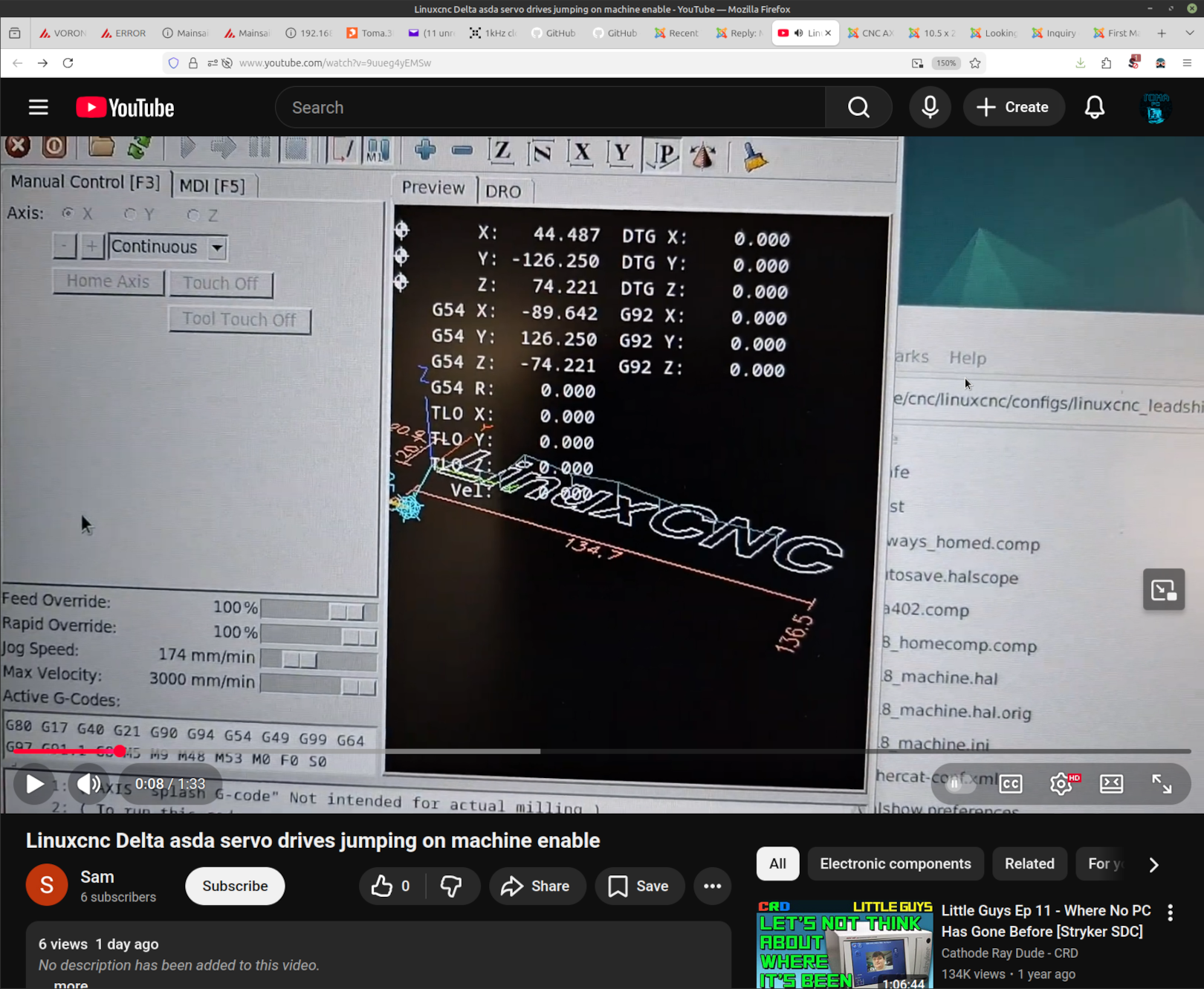

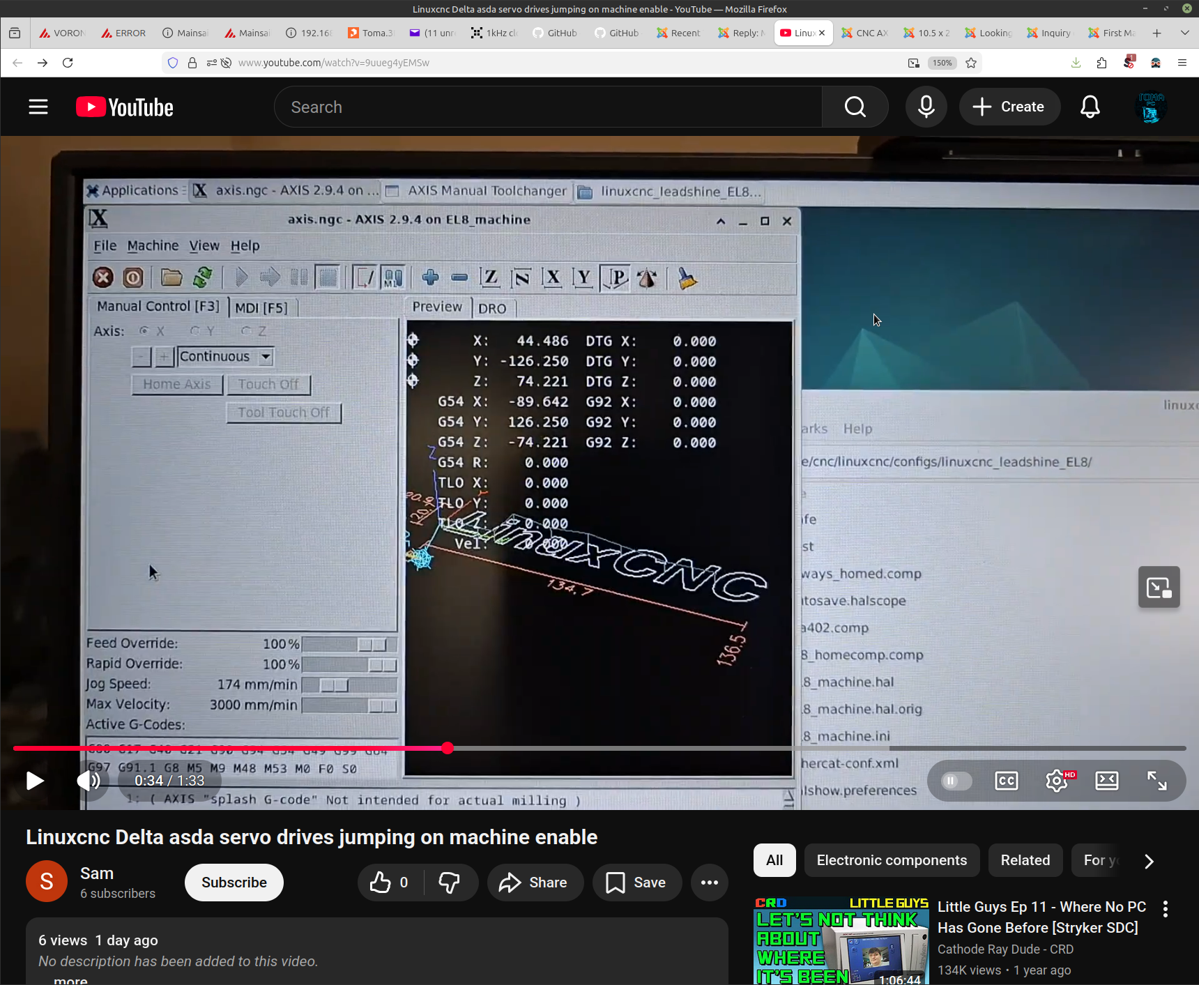

Apologies in advance, I'll probably describe this wrong but hopefully the video makes it clear.
I'm in the early phase of a Weeke router retrofit. I've got my Delta Ethercat drives up and running with LCNC thanks to a lot of help over in the Ethercat section of the forum.
I've got an issue at the moment that I think is probably just basic Lcnc behavior stuff. After I launch Lcnc and Axis loads the axis positions are updating and the machine is trying to move to that new position (if it's enabled at the time). It seems to happen just as the "axis" dialog box in the bottom right corner disappears If it's not enabled then the position for the axis update and everything is good from then on. It looks like Axis is importing the stored values from linuxcnc.var about 5 seconds after startup, the g54 values I think.
If the machine is enabled at the time when the update happens the drives are seeing this position update and trying to teleport to the new position at what seems to be max speed and acceleration making for some very noisy and unpleasant sounds.
What do I need to do to get rid of this behavior?
Video shows it all pretty clearly. Even though you'll hear me saying that it doesn't do it the first time it clearly does. You can see the Z axis (I think) move about 50mm right at the start of the video.

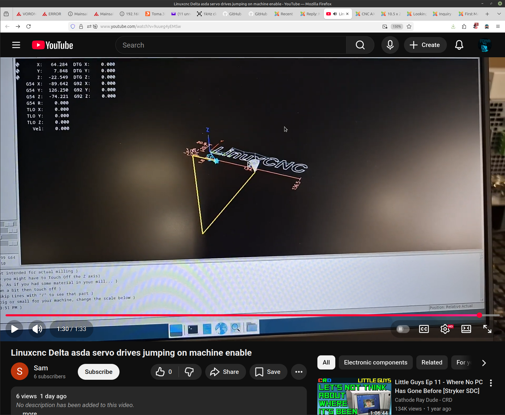

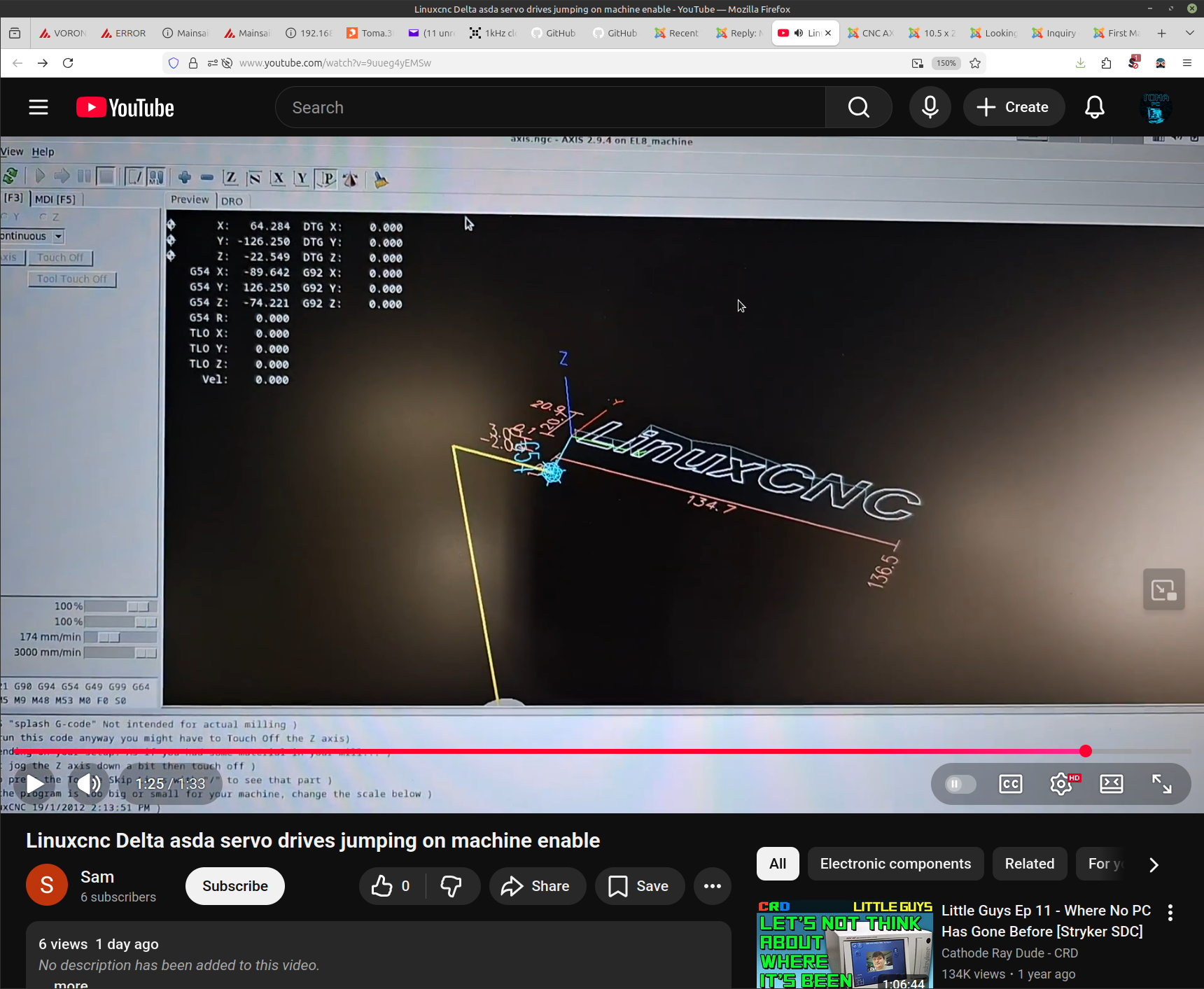

Check the DRO on the attached images, sometimes the Z axis changes, sometimes the Z and Y, but never X.
I would say definitely not LinuxCNC issue, and definitely feedback/drive/interference issue, but i am not sure how the feedback is done in EtherCAT, although i vividly do recall reading somewhere about it having some unacceptable (for me) issues with encoder feedback.
Sorry i can not help more, but since that time i really lost interest on EtherCAT, and sticking to Mesa as much as humanly possible.
