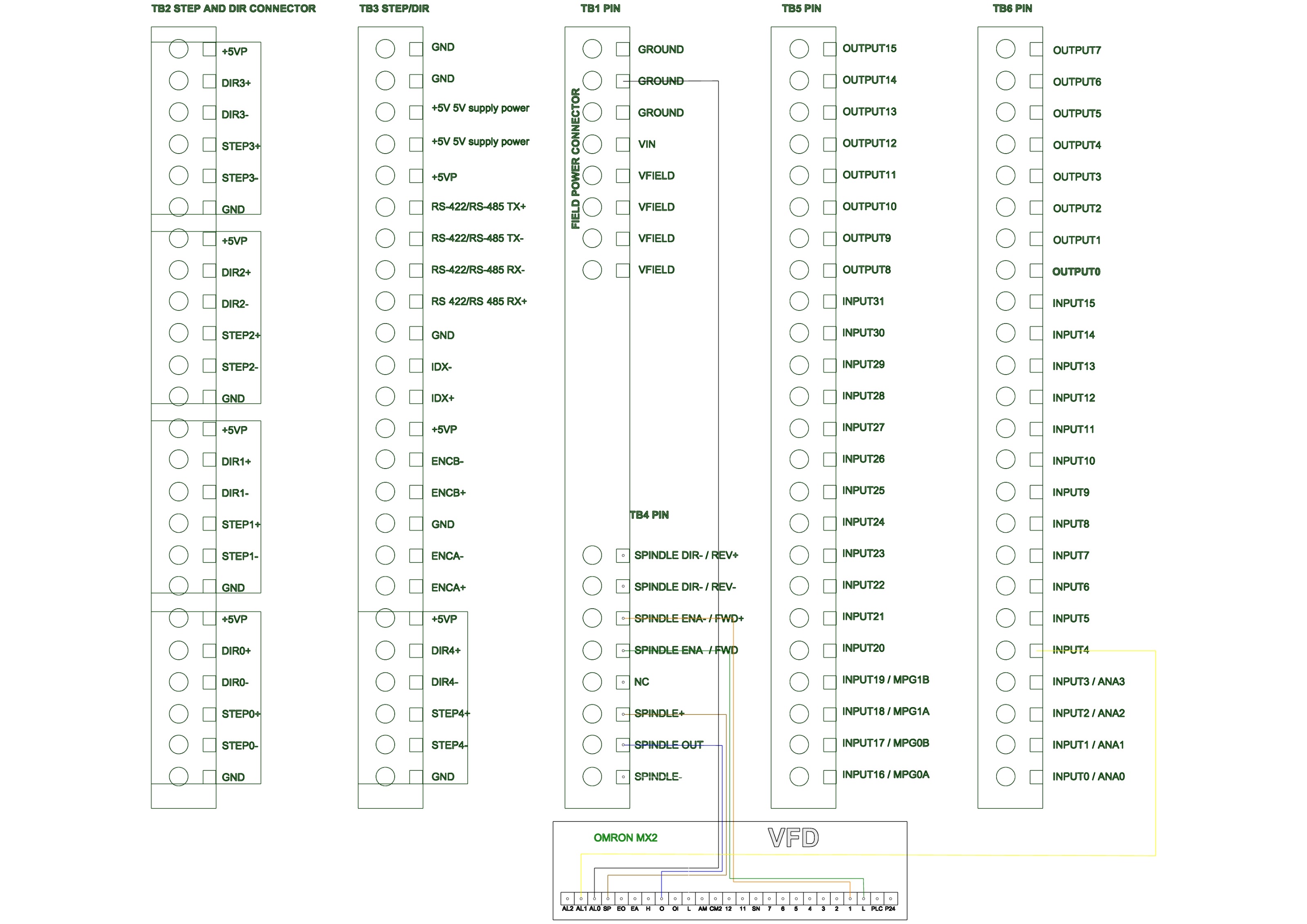

Hello,Im using LinuxCNC 2.9Can I please get some assistance with wiring of the mesa 7i76U to an omron mx2 VFD and the HAL and INI file and the correct firmware recommendation. files.omron.eu/downloads/latest/manual/e...rs_manual_en.pdf?v=1

Here is 5I25/6I25 firmware for a 7I76U with the PKTUART
I can try to help more later, but note there is another user trying to get a Omron MX2
working with a Mesa card and having issues. I suspect I may have to acquire a MX2
to try and get this going.
The 7I76U manual has the RS-485 wiring information (and you must use RS-485 mode with the 7I76U
so you lose on estep/dir output)

Ok thank you I'm happy to use the RS-485 mode,

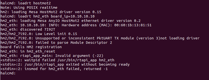

Hi, PCW
Is there available firmware, for the configuration: 7i92 + 7i76U_pktv3d.bin ?
I need to use the modbus characteristics of 7i76U
Thanks, in advance.
Thanks, in advance.

No, but I can make one tomorrow.
7I92 or 7I92T?
7I92 or 7I92T?

7I92 and 7I92T firmware for 7I76U with PKTUART/RS-485:

The correct firmware is this:
Replied by PCW on topic Mesa 6i25 - Mesa 7i76U - Omron MX2 wiring
Sorry that was the wrong firmware for a 5I25/6I25 --> 7I76U using RS-485 modeHere is 5I25/6I25 firmware for a 7I76U with the PKTUART
