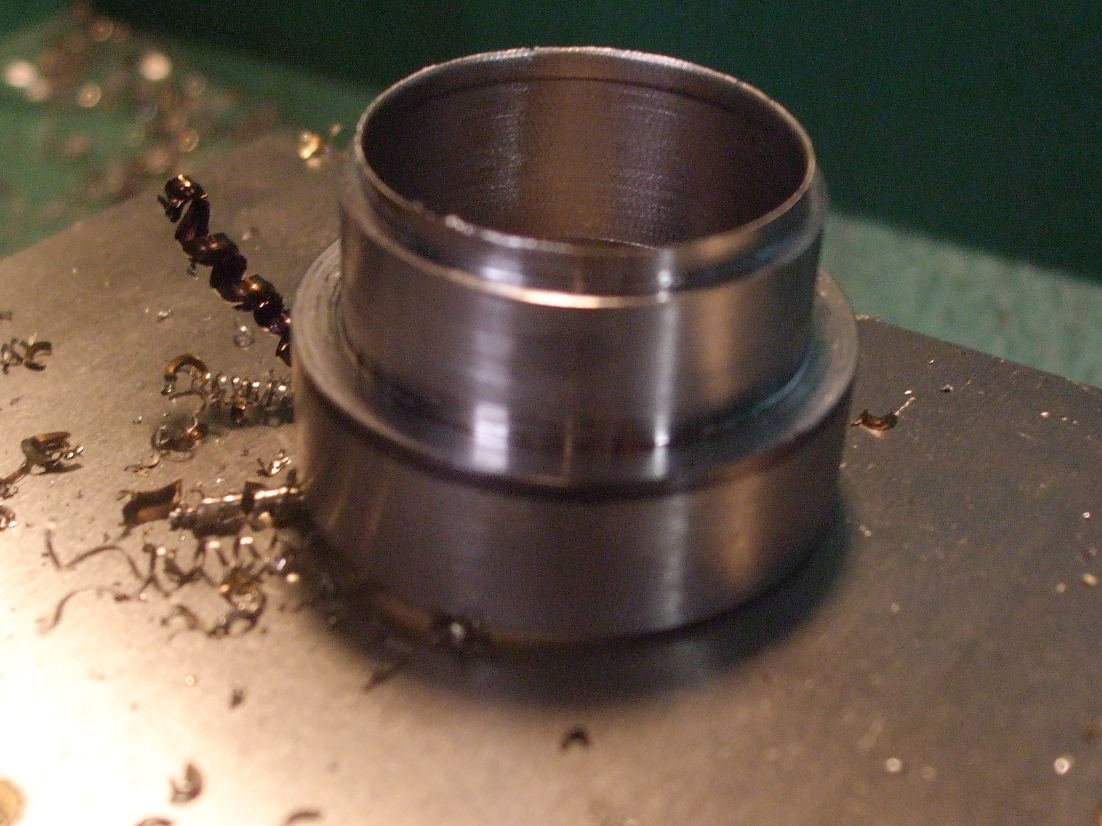

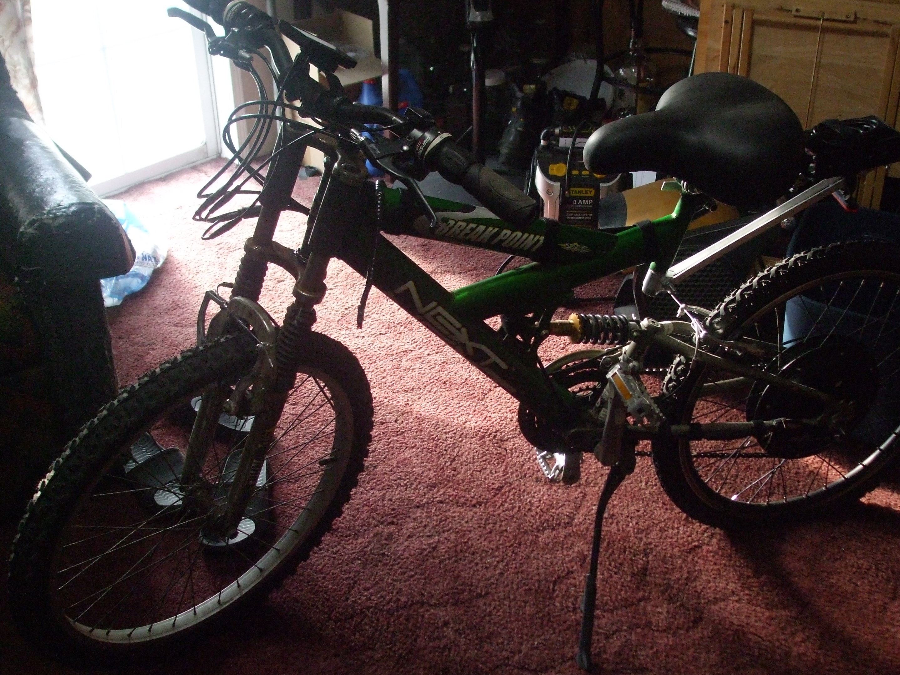

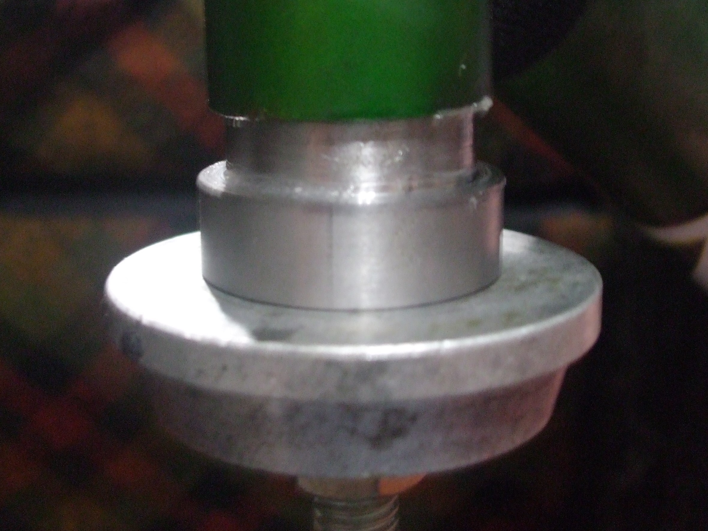

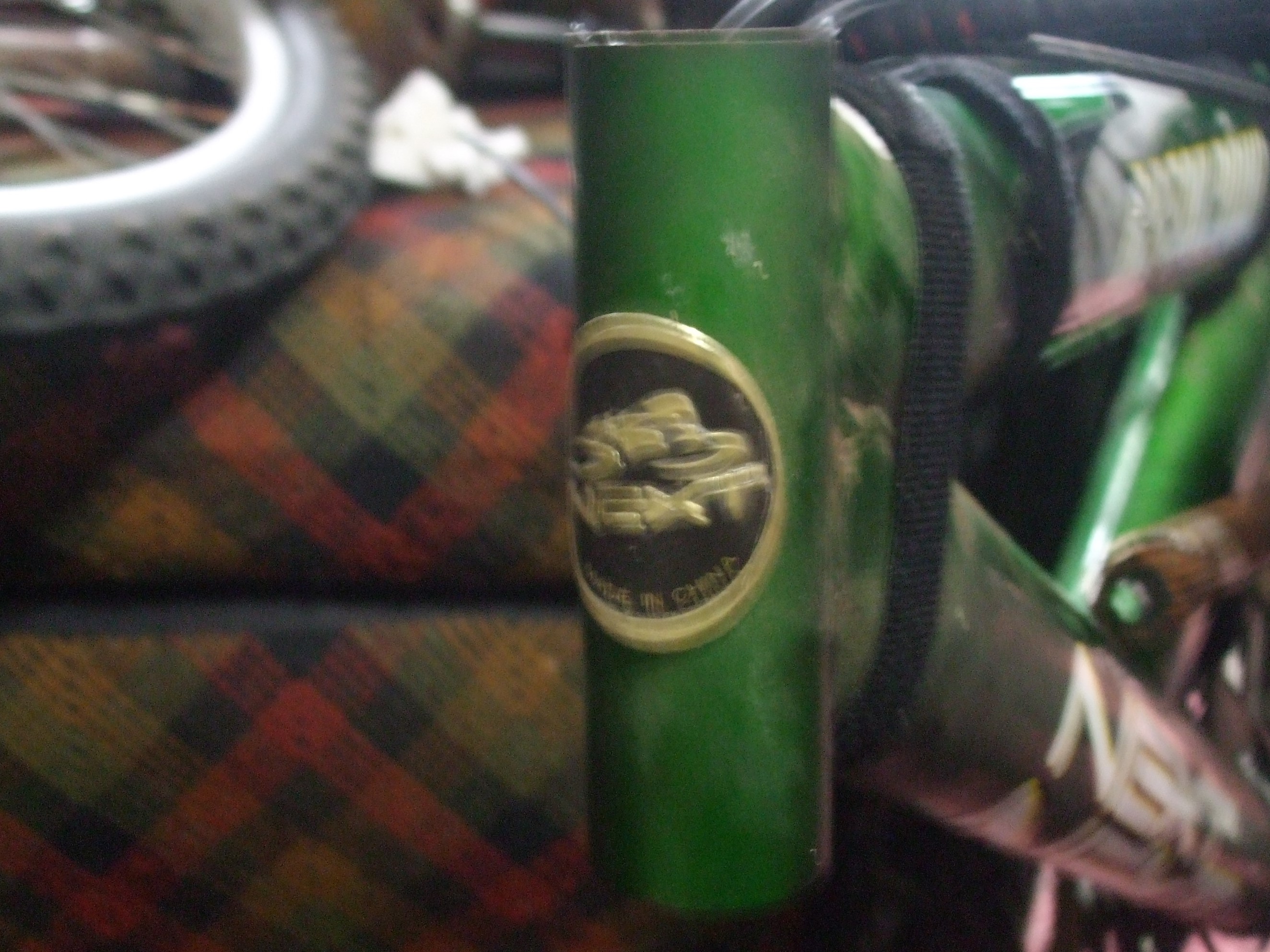

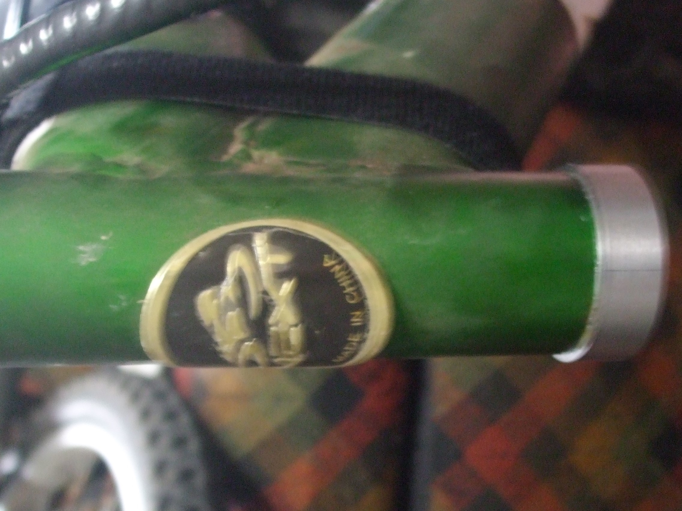

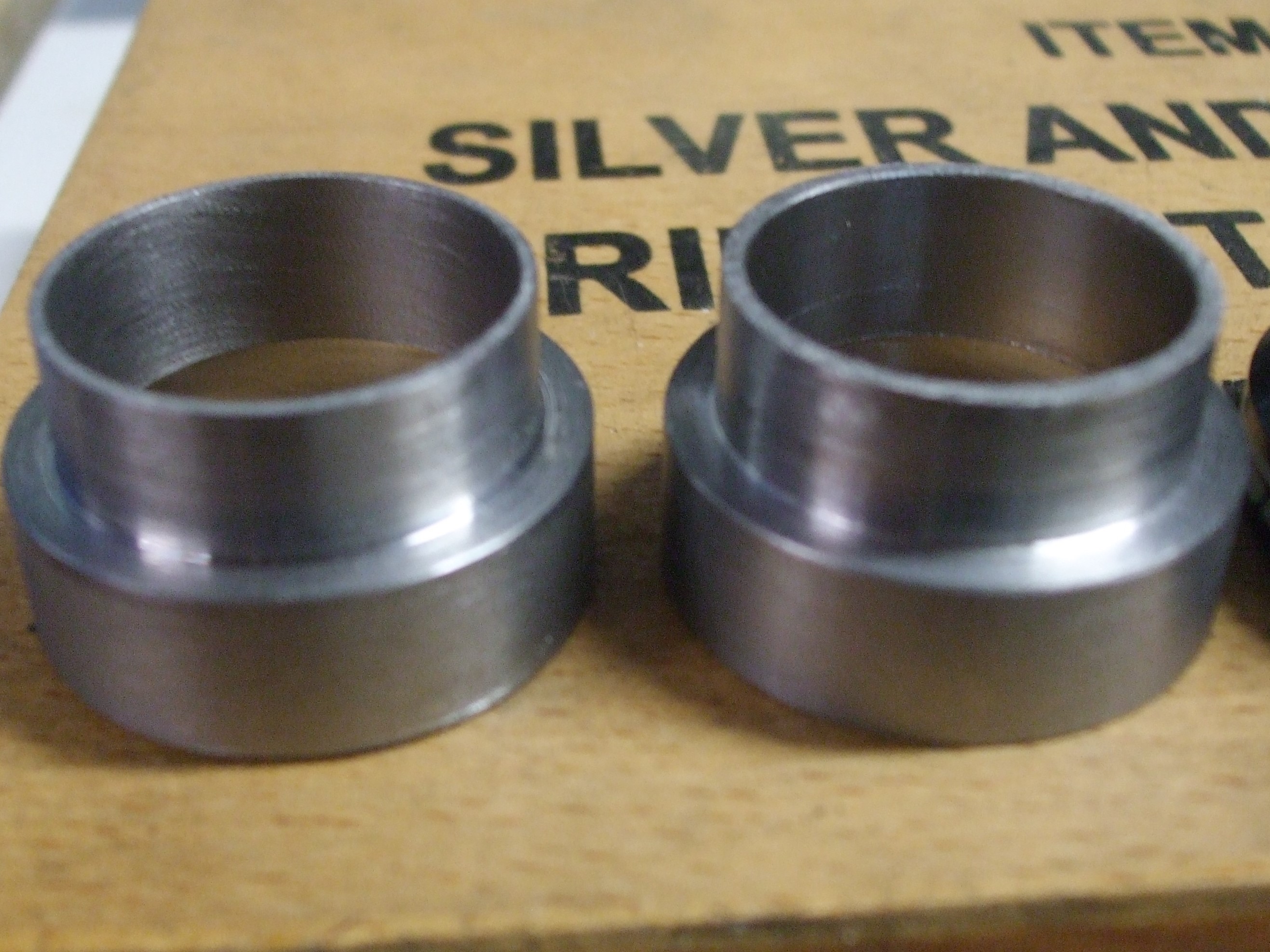

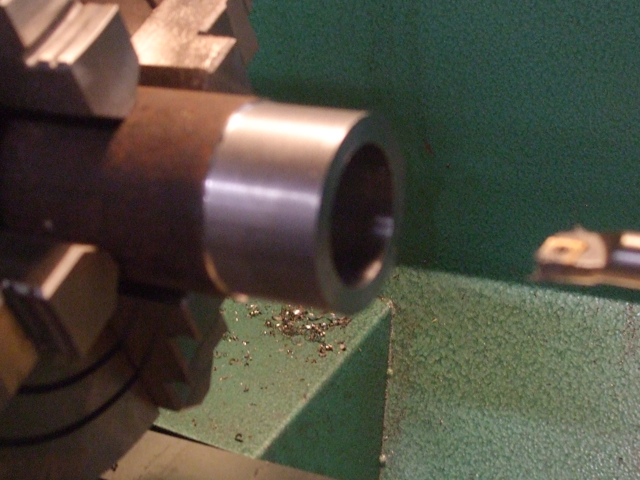

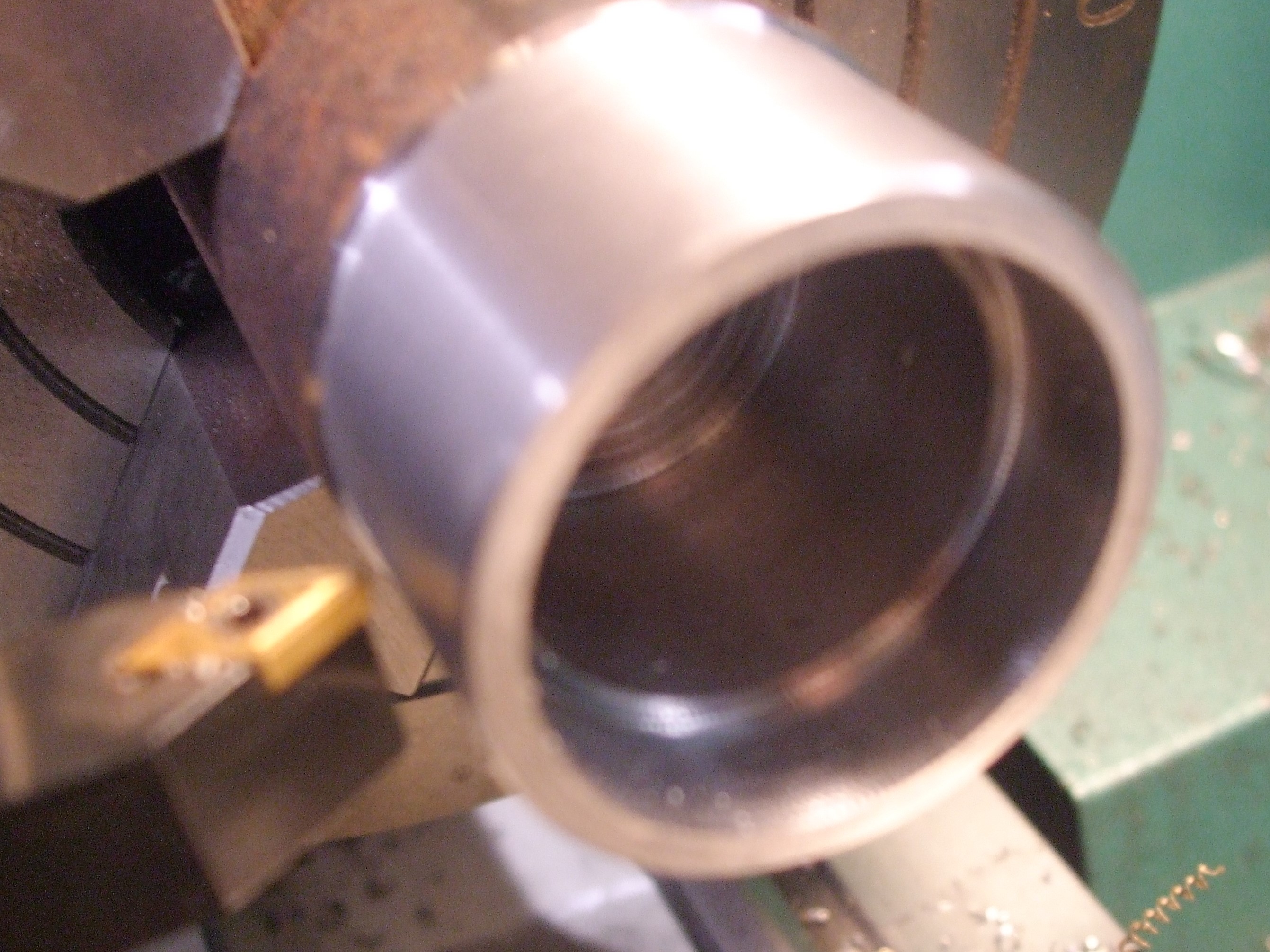

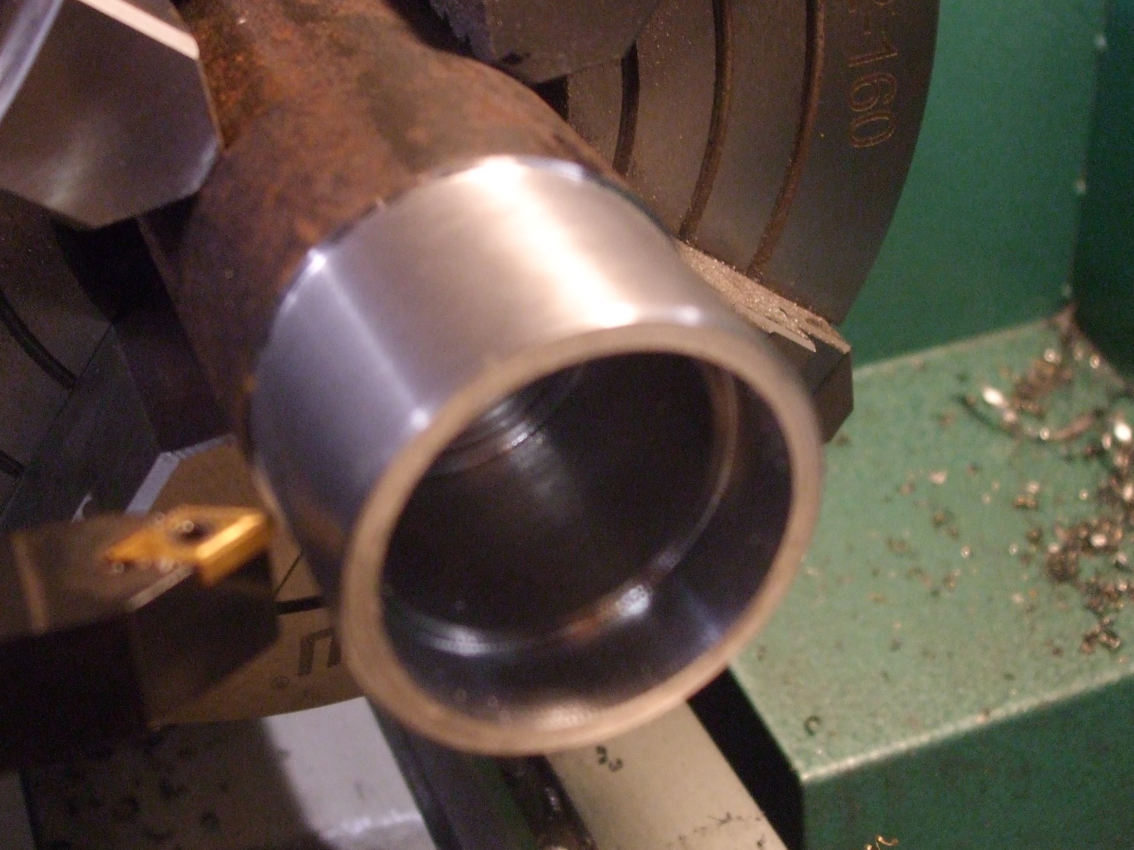

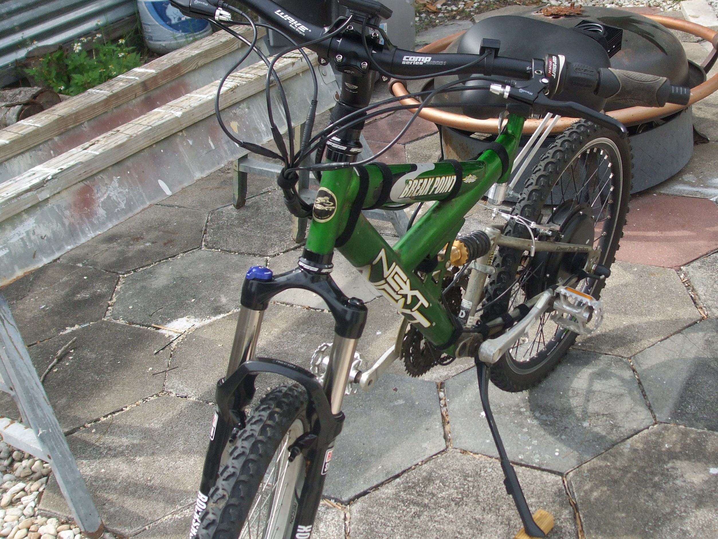

Here I go again.
Me and my sister have been riding E bikes for a little while now and of course I can't leave anything alone.
I switched the batteries over to be in a back pack and moved everthing from my hardtail to my
full suspension Mountain bike . I next did the same thing to my sisters mountain bike . The next project for her bike
will be upgrading the front suspension fork . Only one big hold up any good fork has a 1-1/8" threadless steerer shaft
and her bike currently uses a 1" threaded steerer shaft.
The good news is the 1-1/8" shaft will fit through the bearing cups currently on her bike . After some searching
for an adapter bearing type system and coming up empty handed I decided to make my own .
Once you have tools another world of possibilities always opens up. So I will be using my recently purchased lathe
to build adapter cups to fit the new bearings ( ACB 36 x 36d 1-1/8" MR049 ) to the bike .
We will see if it actually works . LOL

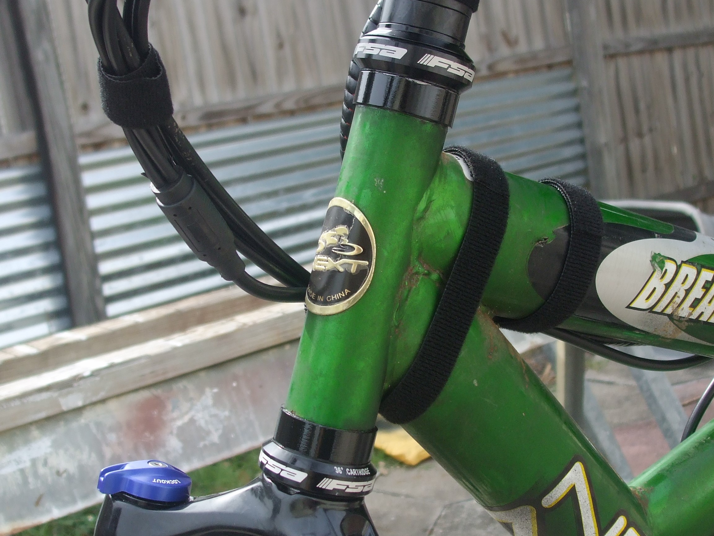

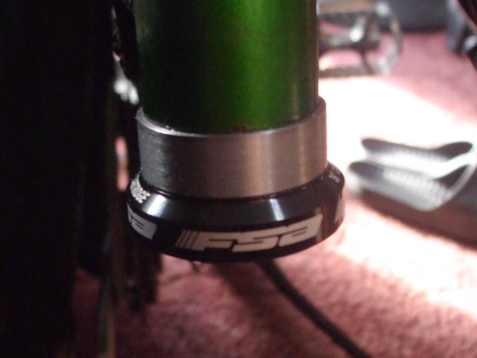

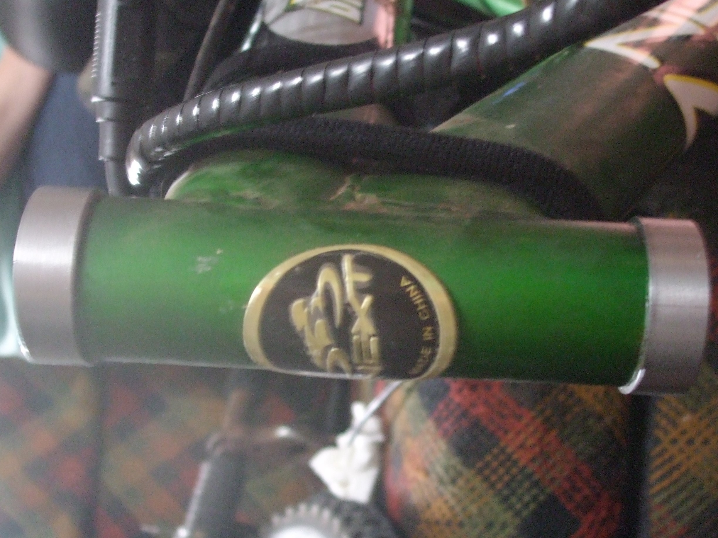

Me and my sister finally got around to test riding her bike with the new fork . What a difference it made . A decent air fork
does wonders and the bike doesn't creek and bang while cycling the suspension anymore. Now
to find some trails to see how it really does.
