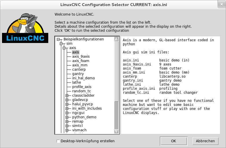

21 Mar 2014 22:04 - 21 Mar 2014 22:07 #45031 by taffou
the installation was succesful, see the screenshot:
Thank you very much for your tip and for your time.
Please look at the result of my latency test.
File Attachment:
File Name: latency_test.txt
File Size:20 KB
What do you think about? This does not look good, right?
Regards,
