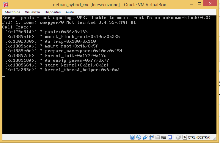

22 Oct 2014 21:49 - 22 Oct 2014 21:51 #52277 by ww34ww34
This is my steps.
cd /usr/src
wget https://www.kernel.org/pub/linux/kernel/v3.x/linux-3.8.13.tar.gz
tar xf linux-3.8.13.tar.gz
ln -sfv linux-3.8.13 linux
cd linux
make mrproper
git clone https://github.com/SebKuzminsky/rtai/ /usr/src/rtai
cd /usr/src/rtai
git checkout old-3.9-debs
cp -prvL /usr/src/rtai/base/arch/x86/patches/hal-linux-3.8.13-x86-1.patch /usr/src/
patch -p1 < ../hal-linux-3.8.13-x86-1.patch
cp -prvL /usr/src/rtai/base/arch/x86/configs/rtai_32_defconfig /usr/src/linux/.config
make menuconfig
make -j$(cat /proc/cpuinfo | grep processor | wc -l)
make modules_install install
grub-mkconfig -o /boot/grub/grub.cfg
update-grub
I can't understand what i'm doing wrong.
I'm also seraching 2.4.9 patch as debian wheeazy....but i can't find it.
:S :S :(

22 Oct 2014 23:10 #52282 by ArcEye
wget www.kernel.org/pub/linux/kernel/v3.x/linux-3.8.13.tar.gz
You are using the 3.8.13 kernel, not the 3.4.55/3.4.9 one Seb used
I have actually had a lot of trouble with that kernel, it built as x86 on one computer and amd64 on another, but completely failed to run on a third computer which quite happily ran 3.4.55 and 3.5.7.
If you are not using the same kernel, I don't really see the point in using any of his stuff at all.
I thought the idea was to optimise the same kernel for Intel Atom, whilst using the provided realtime etc from the distro.
If you want to go away from that, you might be better off using the RTAI at github.com/NTULINUX/RTAI and building the 3.14.7-rtai kernel with the patch and def_config in that.
Probably best to build the amd64 version, not sure he is supporting x86, even if there is a def there for it, it (RTAI) would not build when I last tried it due to definition failures.
regards

23 Oct 2014 01:13 #52296 by ww34ww34
:pinch:
I miss something...same issue.
unable to mount root fs on unknown-block(0 0)
what i can try to fix it?
I really have no idea.
23 Oct 2014 23:55 #52337 by ArcEye
Hi
Do a google search on that error and you will get a lot of hits
Main causes that are solved are the initramfs needs rebuilding and then run update-grub, or the /boot directory too full.
Check out the results and see if any fit yours
regards
24 Oct 2014 15:44 #52349 by ww34ww34
Thanks ArcEye for all the answers.
I'm going crazy.
I have tre option.
1)Wrong config file.
2)Wrong grub config file.
3)both wrong
I'm trying to recompile (whithout modification) the exact kernel that i running on my machine.
I have installed linuxcnc debian wheazy. Kernel version 3.4.9
I explore the build makefile (thanks cncbasher) of github.com/SebKuzminsky/linux-rtai-build .
I use 3.4.55 kernel and github.com/SebKuzminsky/rtai/tree/old-3....x-3.4.55-x86-1.patch
the first time I select
github.com/SebKuzminsky/rtai/tree/old-3....gs/rtai_32_defconfig whitout ANY MODIFY.
but on different virtual machine i have the same issue.
I googled a lot.
1)initramfs fix not work.
2)/boot directory is on the same partition and the hard disk is almost empty. No luck for me.
the log of error say thath i can't mount root partiton.( i attached a screen).
then i use /boot/confing-3.4.9-rtai-686-pae because i want to try the SAME config of debian.hybrid.iso...
but when the compiling goes wrong. Here the message:
WARNING: modpost: Found 10 section mismatch(es).
To see full details build your kernel with:
'make CONFIG_DEBUG_SECTION_MISMATCH=y'
So i'm thinking...what are che right config file ???? Why whith the same kernel-path-config on iso i can't compile?
Now i can try now to manage rtai_32_defconfig. But what value to change ?
or i can try to force compilation of second config with CONFIG_DEBUG_SECTION_MISMATCH=y.
But i think is really ugly.
Any suggestion?
regards
