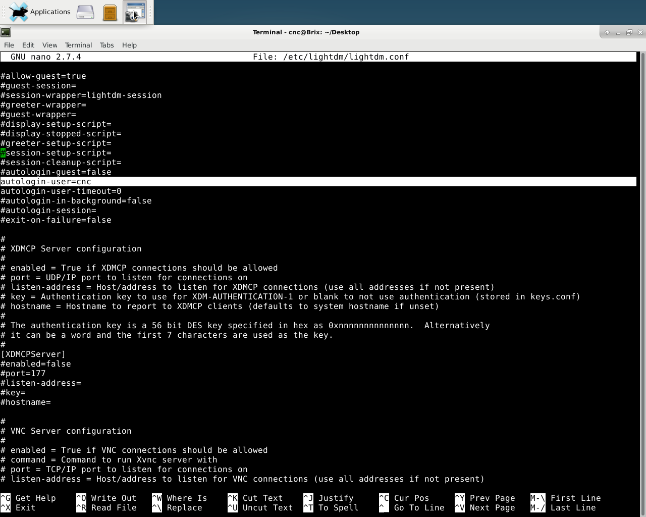

I have made LinuxCNC to start at login and now I want to login automatically to my user account at PC startup.
I haven't seen tool in the menu to do that.
How to make it possible ?

You will need to edit the lightdm.conf file
sudo nano /etc/lightdm/lightdm.conf
nano being a test editor
find the line with autologin-user and uncomment it
then change autologin-user = to your username

It don’t works.

What flavour of linuxcnc are you using
What dose not work. Did you save the file

I have just tried it and it works for me
When saving you have to press exit then Y to save

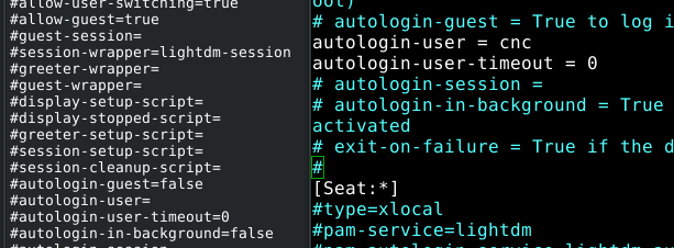

The above has to be changed somewhere below the "seat".
Long time, just recall that it has to be there.

Yes Tommy for the avoidance of doubt:

Yup, that should do it. Also the delay has to be active, set to 0.
