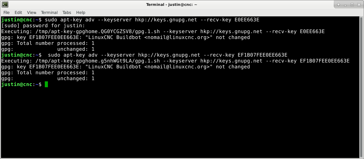

I have run the command to add the buildbot archive signing key and get the following. I found a different key at buildbot.linuxcnc.org/ so ran both. The commands respond with "unchanged: 1" which seems to me it didn't work.
In case for some reason it was already installed (possible meaning of "unchanged") I continued.

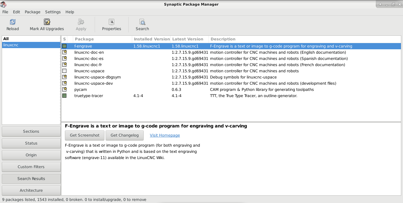

In the package manager I selected "Mark for Removal" on all linuxcnc items & hit apply.

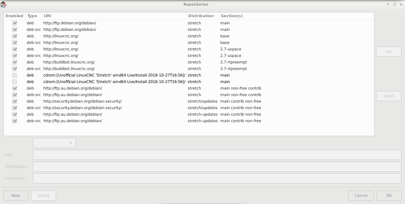

I then go to Settings->Repositories but I still only have 2.7 listed (no 2.8). I assume this means the signing key did not "take".

Did you follow the instructions after adding the key ?
As you still have the 2.7 repos.
So what you need to do is follow ALL the instructions.
The key is OK.
The key does nothing to change the repos. You have to do this your self as per the rest of the instructions on the page you linked to.

You need to edit the repositories as shown in the document.

And hit reload.
23 May 2020 09:11 #168671 by turbodude
Hi BeagleBrainz, I am wanting to run Plasmac so I am just following the instruction linked at top and using the distro they have specified.
OK, I totally missed the concept of what was trying to be done. I thought that the key would cause the repository to "show up" in the list. Didn't realise you had to manually enter it into the 3 boxes.
I stil don't understand the purpose of the key.
Anyway, thanks for eveyones patience. 2.8 is installed now.
23 May 2020 09:13 #168672 by phillc54
The key is basically for security, it means that the LinuxCNC Buildbot really is the LinuxCNC Buildbot.
