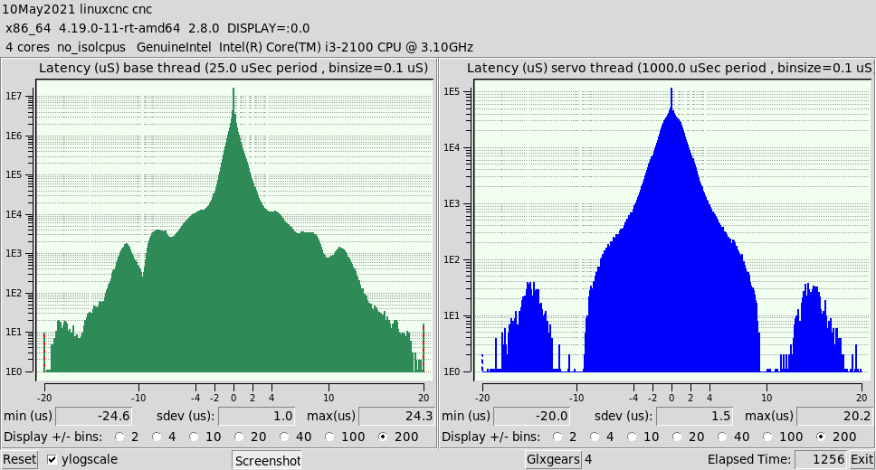

serials errors when connecting with my mesa 7i76 card

Oh nice!
I have seen a lot of bad latency, but that was over everything so far !

Looks like hyperthreading is enabled.

For information, the first one, with terrible latency was an NUC8i7HNK (i7-8705G/32Go Ram).
I disabled virtualisation, still bad latency. I'm looking how to disable the Radeon RX Vega M GL graphics... But i need both virtualisation and good graphical card for this computer.
I'm thinkings of buying a small computer.
