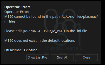

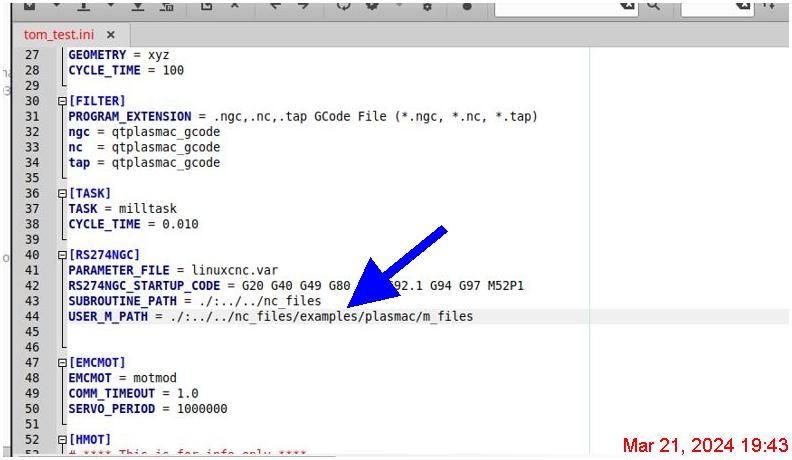

OK, the top pic in
this post
shows that for some reason the link to the sample ngc files is not being created.
In the [RS274NGC] section of the .ini file change:to:
./:../../nc_files/examples/plasmac/m_files./:/usr/share/doc/linuxcnc/examples/nc_files/plasmac/m_filesPlease Log in or Create an account to join the conversation.

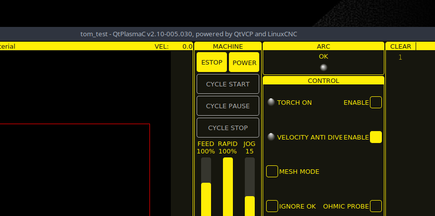

21 Mar 2024 22:25 #296511
by acourtjester
Replied by acourtjester on topic LinuxCNC Install using MX Linux 19.4 - Geared Toward New Users
Well stop the job, I went back and went over some of the commands in the procedure and last thing was nm-connection-editor and it loaded the GUI for QTPlasmaC with version number 2.10-005.030.
Looks like Phill was correct with it being a networking issue.
A great big THANKS for your help, now I move the controller back to the shop for actual testing and operations.
This I hope corrects the glitches I had with the other version (Arc Ok and THC.

22 Mar 2024 01:01 #296523
by acourtjester
Ok Phill I did find a bug, I use the pnnconf to make changes to the GUI, I know you guys use a different method.
Anyway what I found was when I did it the line in the INI file is changed by removing the examples folder info that you had instructed me to add../:../../nc_files/examples/plasmac/m_files
I went into Pnnconf to change the mode from 2 to 0 so I had all the buttons (auto voltage for one) and after that the error came back. reentered the examples folder and it work as it should. Thanks again for all the help.

22 Mar 2024 01:07 #296524
by phillc54
Replied by phillc54 on topic LinuxCNC Install using MX Linux 19.4 - Geared Toward New Users
Thanks, yes, PncConf overwrites the .ini file, I have a fix in hand but am waiting confirmation that it does work.
Did you try the path I suggested here ?

22 Mar 2024 13:38 #296542
by acourtjester
Yes sir That fixed the error right away, Again Thanks for your time.
