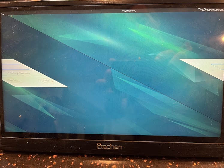

I installed the image from the download page and installed it on a RPi 4B and have an issue I can't figure out. I can get in and the image works, but the login screen is at a resolution that the little monitor I have doesn't support and it is skewed. You can make it out and get past this, and then reset the display setting once to the desktop, but if the Pi goes to sleep, or on next boot, the login screen resets the resolution back to the one my monitor can't support. How can I set both the login screen and the main window resolution to a specified setting.
Here is what the login screen looks like:
https://photos.fife.usercontent.google.com/pw/AP1GczOETd3dhYUDRgXHYTnzpp9TKRjkmYnq6D6_pN9r6YUqH3WpGP2bGTfXxA=w1121-h840-s-no?authuser=0

Replied by tommylight on topic Trouble with Linucnc RPi
Do not double post, please, it makes it very hard for us to follow what has been already answered. Thank you.
That seems like a video signal issue, for sure, so try another HDMI cable if you can, and/or see the RPI forums for what settings you need to have in config for your monitor setup.
Just in case that is a RPI3 and you are using the "composite" analog output, see what your monitor can accept, be it PAL or SECAM or NTSC.

You never specified the resolutions of your monitor nor your make\model of monitor so kind of hard to diagnose.
I think your best bet would be to google something along the lines of "RPi4B skewed login screen" if you get asked what operating system on any forums tell them Debian Bookworm with a kernel built from Raspberry Pi kernel sources. If you mention Linuxcnc their heads will explode and tell you to come back here. The thing is this is the first time I can think of this issue has come up on the forum, so not a lot of knowledge.
Whilst we can diagnose some issues others are out of out league, whilst we could offer suggestions we've searched for not having your particular monitor makes it a bit hit & miss.

As for the problem, I don't think it is an issue with the LinuxCNC images. You are right that it is likely a general problem that would show on a non-LinuxCNC image. I figured I would ask here because you guys seem very knowledgable about not only LinuxCNC, but Linux in general.
That said, I have searched about this problem in general RPi forums and internet searches. I did a lot of that before posting here. There are reports of others having this problem but all of the solutions I have found on this say to go into raspi-config to change things, but the LinuxCNC images don't have raspi-config and menu-config doesn't have the same options. Basically what everything I have found is getting at is forcing the resolution for the login screen to a resolution that works with the monitor.
To be more clear as to what is happening, when the Pi starts to boot the monitor wakes up and pops up a little info window showing what resolution it is being driven at. This little window is a display thing, not a linux thing. Anyway, I can't remember what resolution it starts at with the verbose text, which appears fine, but when it gets to the login screen the little window pops up and shows the driving resolution has changed to 1366x768 @ 60Hz, which gives the skewed image in my previous post. At this point I can type username "cnc", tab to password "cnc" and it takes you to the desktop. Initially the desktop is skewed like the above picture, but you can make stuff out. If I navigate to display settings and set them for 1400x1050 @ 60 Hz the image is normal and everything is fine. If the machine goes to sleep or reboots, once it goes through the login screen again, the resolution is reset to 1366x768. If I can force the login screen rsolution to be 1400x1050 I think all will be good, but I don't know how to do that.

I would change the cable, first.
I have thrown so many HDMI cablles by now that i get irked when someone mentions them, from bad quality to wrong resolutions to not being able to run my 3440X1440 monitor at 100Hz!!!
I have a single HDMI cable here (here being my bedroom) that does 100Hz, the rest are a choice of 85Hz to 2560X1440 at 59Hz, i have more in the shop that are OK, but ALL Display Port cables i have do that and 4K easily, no matter how cheap or bad quality.

There will be some info that mentions modifying config.txt, as this is what the raspi-config utility does.
The HDMI cable that comes with the RPi s doesn't "feel" like the best of quality, so Tommy may have a good point.
The RPi docs have a good explanation of the config.txt file, but just remember that the location of that file on the images is /boot/broadcom/config.txt

Thanks guys. I got it fixed. Not sure exactly which change did it, but here are the changes that I made to config.txt.I may test each individually to see which one it was.
First I uncommented to force VGA mode
# uncomment to force a specific HDMI mode (this will force VGA)
hdmi_group=1
hdmi_mode=1
Next I uncommented to boost the HDMI signal here
# uncomment to increase signal to HDMI, if you have interference, blanking, or
# no display
config_hdmi_boost=4
In this section I changed from "dtoverlay=vc4-kms-v3d,cma-512" to "dtoverlay=vc4-fkms-v3d" based on a problem report I found last night.
[pi4]
#dtoverlay=vc4-kms-v3d,cma-512
#dtoverlay=vc4-kms-v3d-pi4
max_framebuffers=2
arm_boost=1
#disable_fw_kms_setup=1
hdmi_group=1
hdmi_mode=1
# no display
config_hdmi_boost=4
[pi4]
max_framebuffers=2
arm_boost=1
