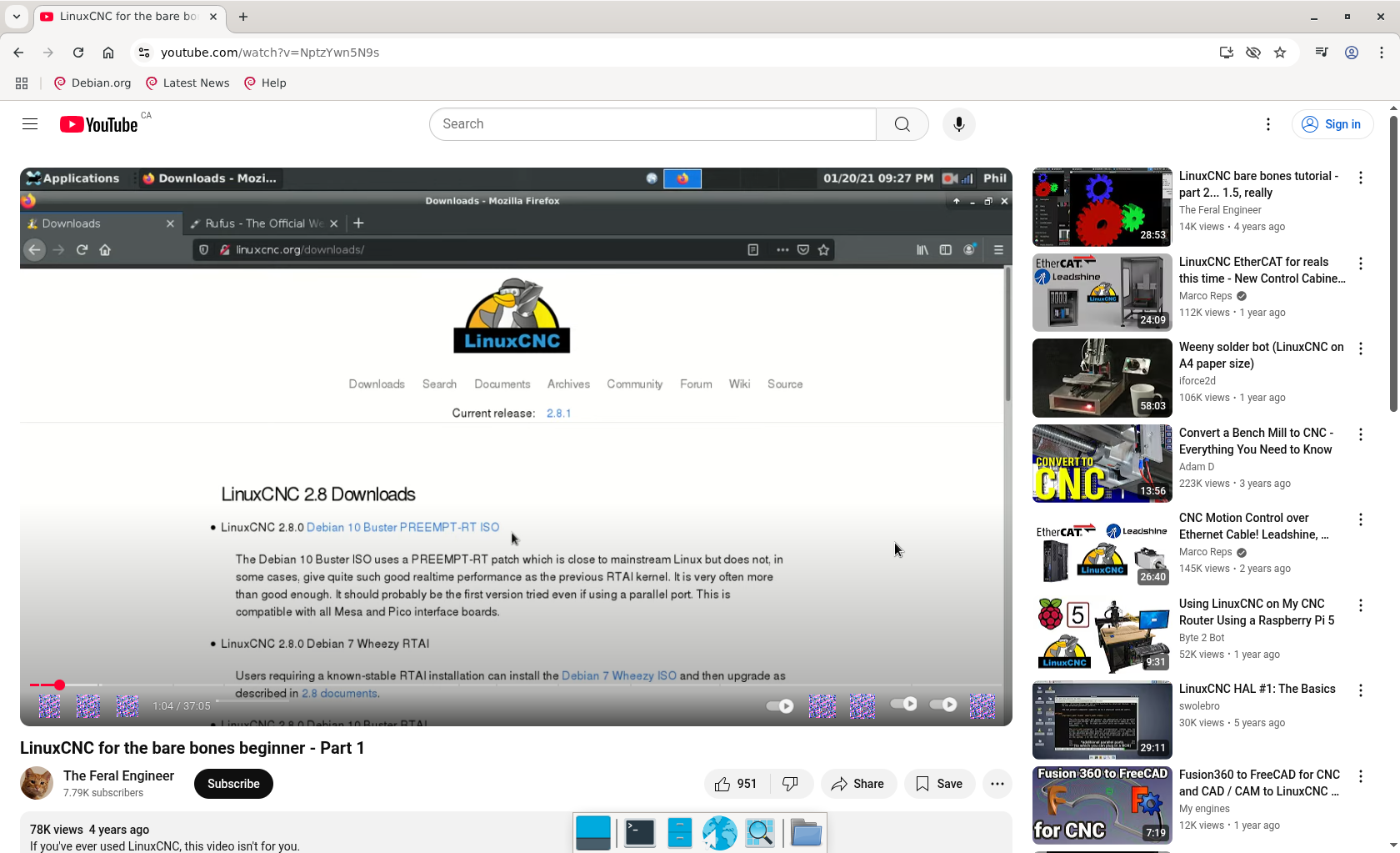

The official LinuxCNC 2.9.4 image for arm64 is installed on a Raspberry Pi 400. There are strange partial graphical glitches in browsers, such as some pages or partial horizontal section of the page not displaying properly, while the rest is fine.
This was tested with Firefox ESR, but Chromium was also installed, and for example, the settings page for Chromium never displays properly. It would appear the underlying text and buttons/links are present but not visible, except by sometimes mousing over them.
The problem appears to be only in browsers, not other applications. Youtube in either browser is also unusable, with graphical glitches on the player controls (YT buttons like play/pause/settings are either invisible or look corrupt).

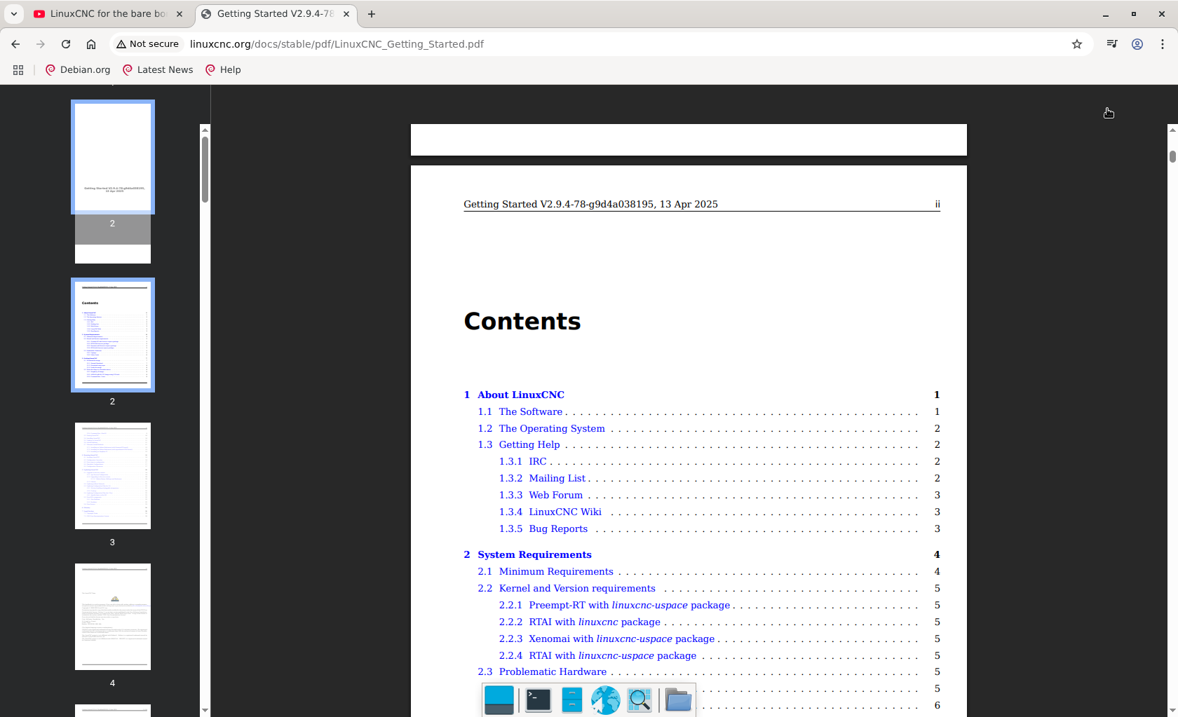

Similarly, when opening PDF documents in browsers, the control buttons along the top of the document for Zoom/Download/Save etc are often invisible, but still present if moused over.
Also, Youtube video playback is extremely laggy, and that is including after removing the isolcpu=2,3 option. The goal on the Pi is just to familiarize with LinuxCNC and set up configs, not to run machines on it, so I'm not too concerned about the latency penalty in this case..
Has anyone else experienced this problem?

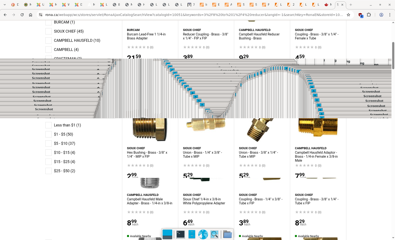

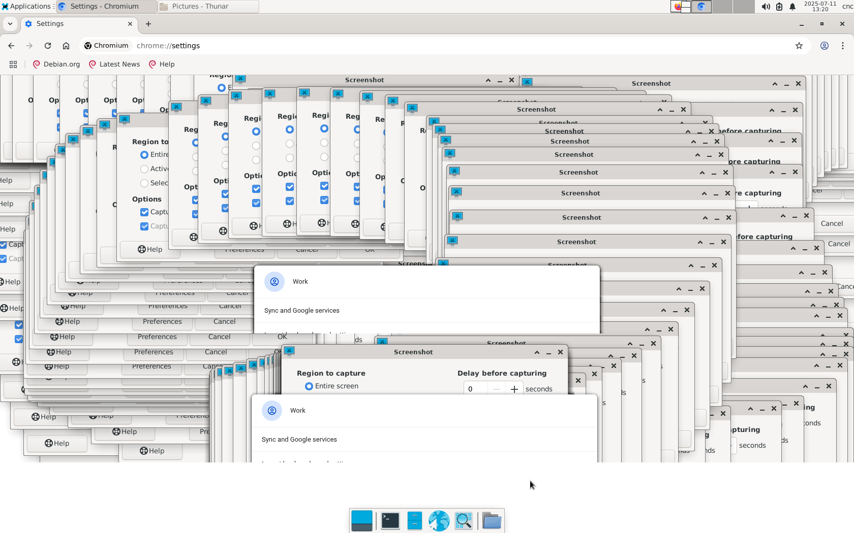

Thanks for the replies. I finally got a chance to check out the suggestions on the RPi400. For testing I made a new fresh image on a new SD card, and the graphical glitches could be reproduced, but it may be just an issue in chromium browser, which is not installed by default. I did not reproduce the issue in Firefox, and though it is painfully slow to load pages, Youtube does play... eventually.
The SD cards used are 64GB Kingston Canvas Select Plus. Nothing fancy, but I doubt it is the issue, since I've used multiple, and other images (default RPi OS, Ubuntu 24.04) don't have the same issue.
For reference, here are some screenshots of the glitches in chromium. Btw, I had to install xfce4-screenshooter to be able to take screenshots, as it is not installed by default in the LinuxCNC rpi image.
The first screenshot shows a horizontal section of the web page with corrupted graphics. The second is chromium's setting page which never displays correctly. The third is a pdf document opened in chromium, with the controls (download, zoom, etc) at the top not showing. The fourth shows the graphical glitches in the Youtube player controls (buttons for play, pause, settings, etc).
They work in Firefox (very slow though, which is why I installed chromium) so perhaps this is not an issue specifically with LinuxCNC's image, though I can't tell. I don't have these issues with chromium on the other RPi OS images, but I have not tried debian 12 directly. I imagine that also precludes hardware issues. The monitor is a 22" Dell at 1680x1050, though I doubt that is too relevant.
