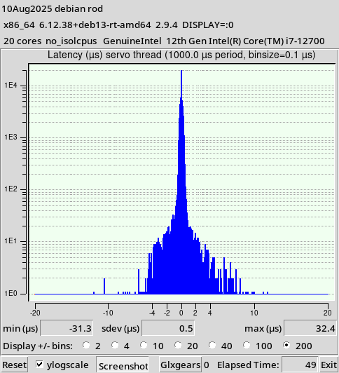

Debian Trixie is released Yeay!!
It contains Linuxcnc 2.9.4 Wow!
To upgrade from Bookworm, very rough instructions
sudo apt update
edit /etc/apt/sources.list and replace any instance of bookworm with trixie
sudo apt update
sudo apt upgrade.
Check you are booting in to the new 6.12 Real time kernel
run sudo grub-customizer to set this.
Reboot into the 6.1.2 RT kernel
I removed my version of linuxcnc
sudo apt remove linuxcnc-uspace linuxcnc-uspace-dev
If it is a new install, download debian from Debian.org Trixie is their current release and install with balena etcher
Check you are running Trixie: lsb_release -a
Check you are runing the prempt_rt kernel 6.12: uname -v (the RT kernel got installed for me)
Linuxcnc should install the RT kernel but I have not checked that.
Install linuxcnc. Seems one dependency did not play well
sudo apt install libqt5webengine5
sudo apt install linuxcnc-uspace linuxcnc-uspace-dev
enjoy Thats It. If you are running ethercat, I think the packages need to be removed and reinstalled as the config ssemed to be missing config files in 6.12
PS I am using the Cinamon Desktop, Latency seems good even without isolating any cores
Seems that I can run the RT kernel without this desktop hanging which is good! I'll see how it goes.
Have fun

I don't think it will cause problems. In fact, I could not run PREEMPT_RT on bookworm or this PC and it would also hang on the normal kernel sometimes. I gave the PC a workout tonight on preempt_rt and its been perfectly stable. I'll try and build a trixie ISO now as the Debian builder takes the OS from the running version.
Just look at the usual network driver upgrades and disable energy efficient Ethernet (EEE) because it will cause latency spikes.

I have a fresh install of Trixie and linuxcnc and ethercat and it works fine

I upgrade from bookworm to trixie & ethercat work fine

apt update, apt upgrade, apt dist-upgrade
Ethercat works. Didn't have an issue with the Qt package, might have brought it in earlier.
Did need to reinstall linuxcnc-ethercat.
Then it ran fine on the right RT kernel.
Adding that I see the Ethercat kernel modules get signed so there's a big chance we don't need the trouble with secure boot anymore.
Can't test it but someone maybe can check?
