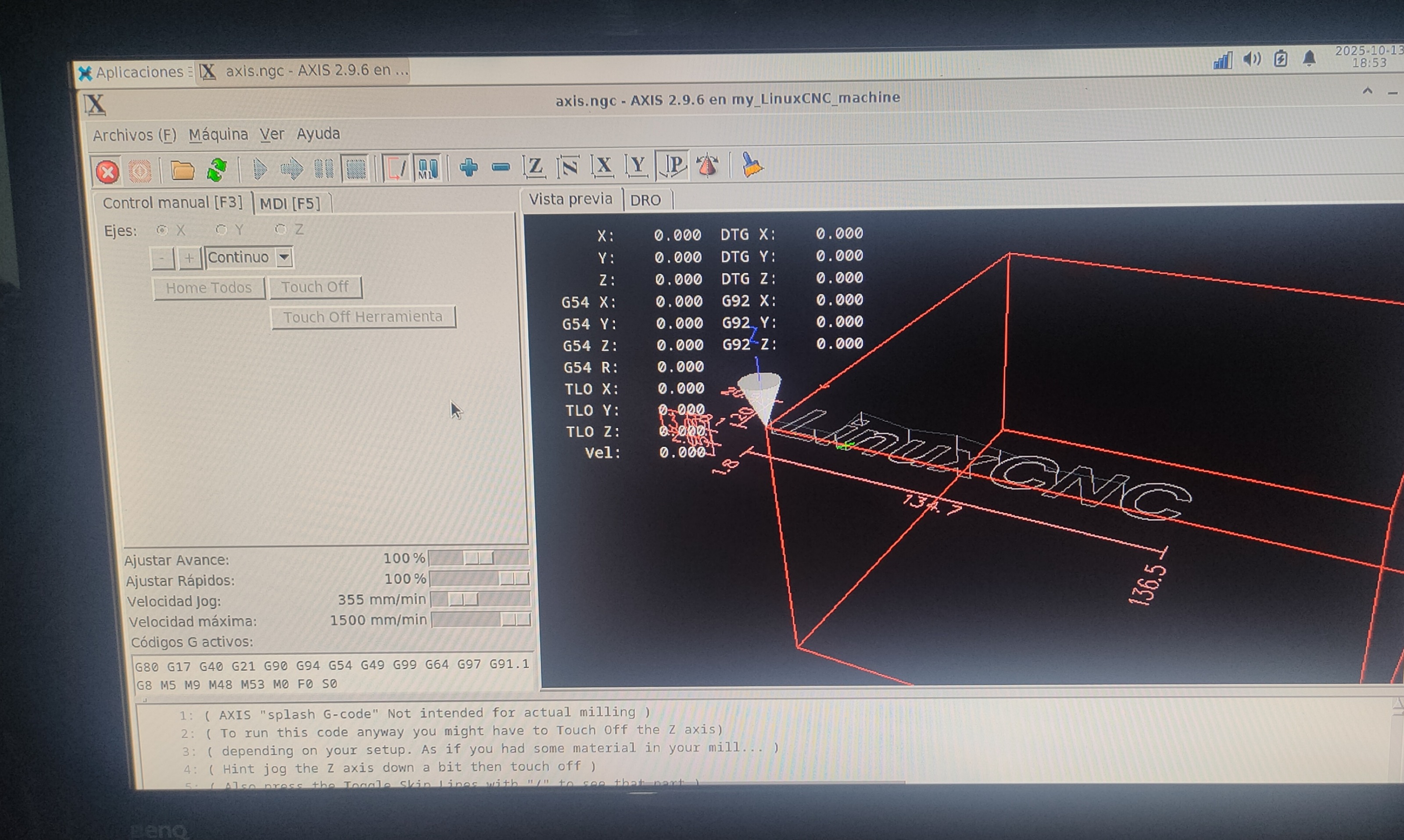

13 Oct 2025 12:11 #336386
by jmp97
LinuxCNC installation + 7I96S was created by jmp97

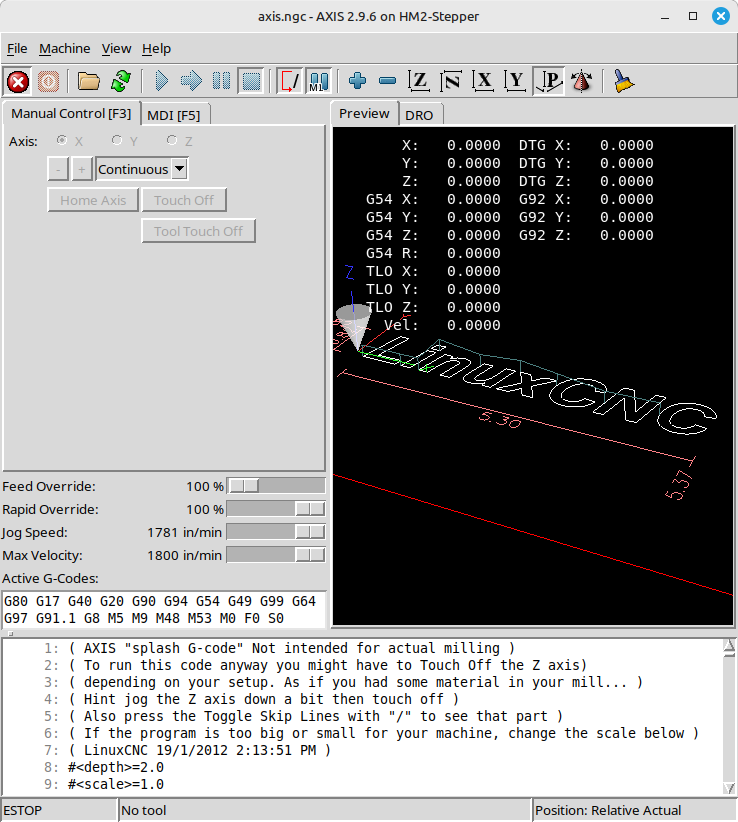

If the "Emergency Stop" button (red X) does nothing, this is likely an issue in the hal or ini files.
Can you post your hal/ini files here?

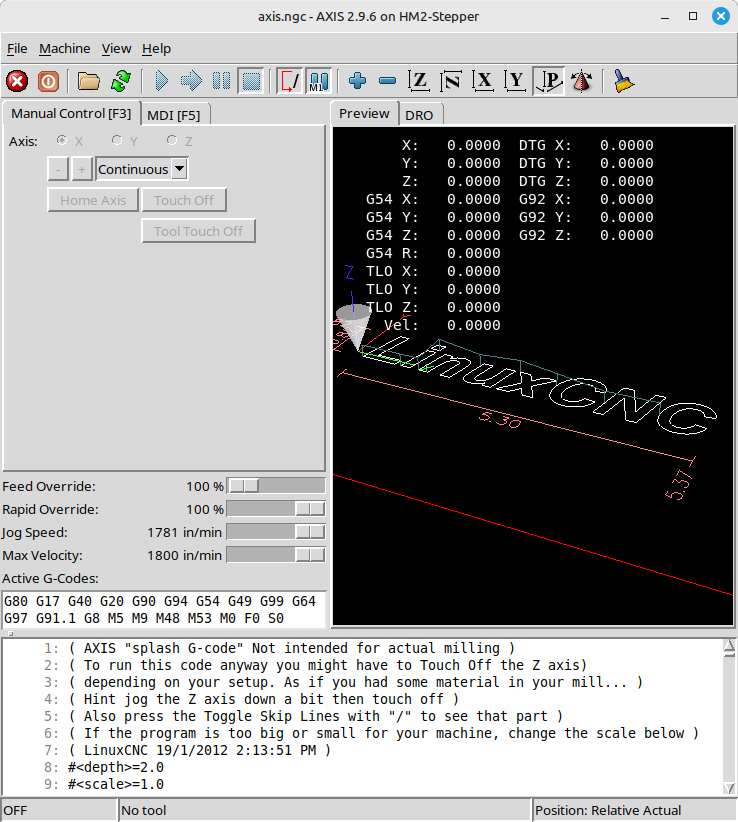

Axis should look something like this initially (before estop is released):
After Estop is released and before power (Orange button) is on:

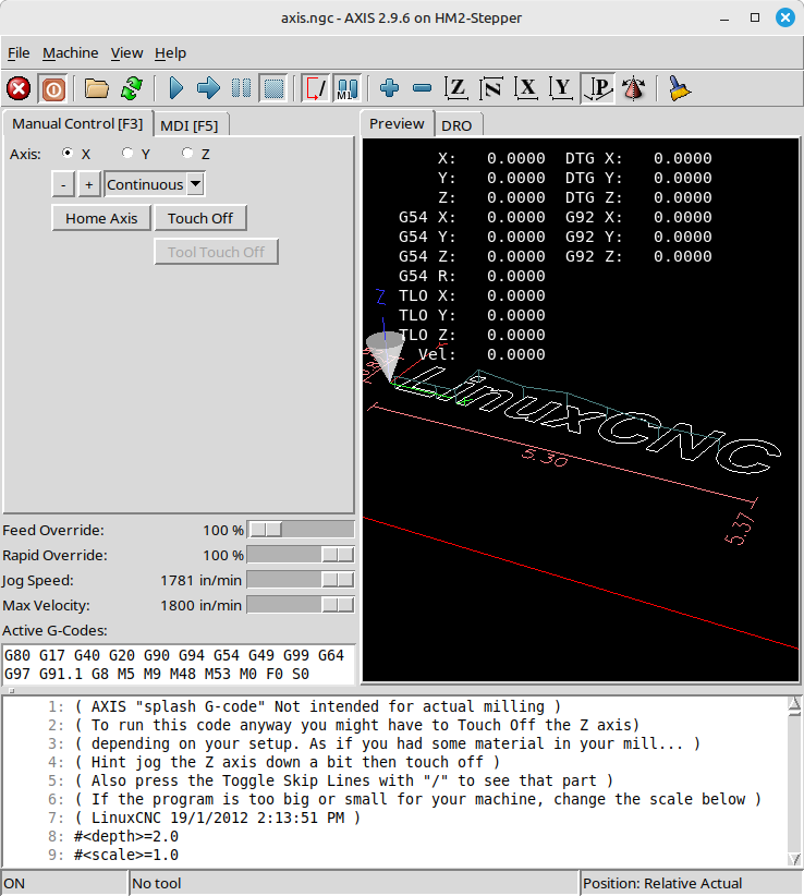

and after power is on:
- jmp97
- Posts: 32
13 Oct 2025 15:36 #336396
by jmp97
Replied by jmp97 on topic LinuxCNC installation + 7I96S
Hi!

- Posts: 18118
- Thank you received: 5336
13 Oct 2025 16:01 #336398
Replied by PCW on topic LinuxCNC installation + 7I96S
The hal file is incomplete, if you cannot get out of estop, this is likely an issue
with the EStop related signals and these tend to be at the end of pncconf created
hal files.
Did you setup an external EStop? That might be another reason for inability
to get out of the EStop state.

- jmp97
- Posts: 32
13 Oct 2025 21:04 #336406
by jmp97
I simply followed the installer's instructions. I only configured the selection of the 3 axes to their ports. I don't remember configuring an EStop.
It won't let me exit the emergency stop on the interface.
Is there a tutorial on how to configure it correctly?

- jmp97
- Posts: 32
14 Oct 2025 13:04 #336438
by jmp97
With the LinuxCNC test configuration, when I select the 7I96S table option, the interface allows me to exit emergency mode. However, I cannot find a way to move the motors (there are no jogs).
