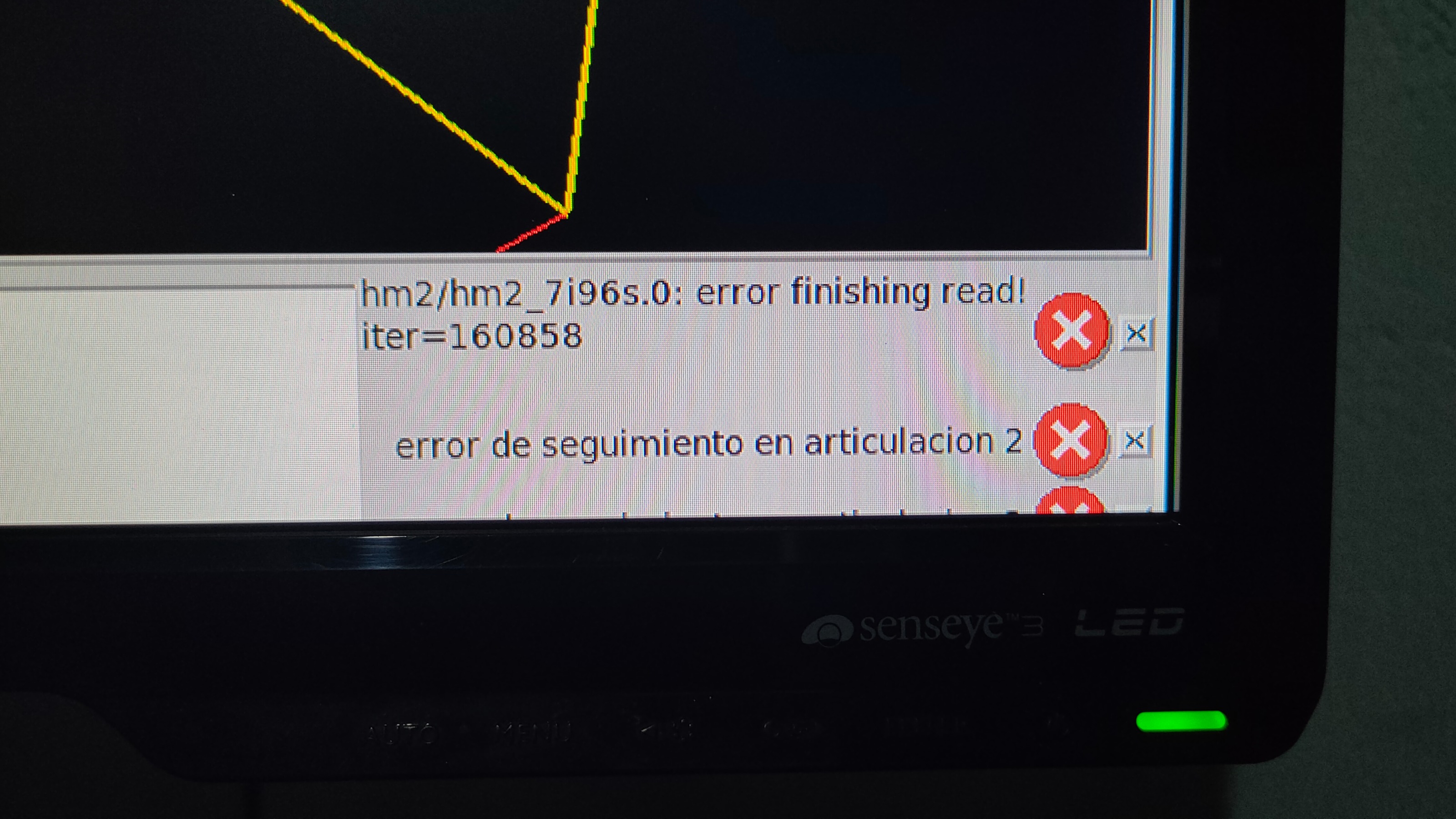

14 Oct 2025 21:45 #336469
by jmp97
Replied by jmp97 on topic LinuxCNC installation + 7I96S
- Posts: 18118

14 Oct 2025 22:02 #336470
Replied by PCW on topic LinuxCNC installation + 7I96S
That indicates a Ethernet latency issue.
What does the command
sudo chrt 99 ping -i .001 -q -c 60000 192.168.1.121
report?
(the command will run for one minute then print statistics)
report?
- jmp97
- Posts: 32
15 Oct 2025 06:37 #336496
by jmp97
--- 192.168.1.121 ping stadistics ---
60000 packets transmitted, 60000 received, 0% packet loss, time 59998ms
rtt min/avg/max/mdev = 0.046/0.057/0.157/0.000 ms
I don't think it's a connection or latency problem.

- Posts: 18118
- Thank you received: 5336
15 Oct 2025 13:46 - 16 Oct 2025 10:46 #336513
Ethernet latency is the most common cause of the "Error finishing read" fault
It basically means you have lost connection to the card, either because too
many read requests went unanswered within in the time limit (with default settings
that time limit is 80% of the servo thread period and 5 successive requests must time out)
This may be caused by poor Ethernet latency or something more basic like power problems
on the FPGA card, host Ethernet power management issues, or Ethernet hardware problems.
What LEDs are illuminated on the 7I96S when you get the error?
Can you run this command after LinuxCNC gets the error and post the results here:
halcmd show all *.tmax
Also the CPU speed would help.
Last edit: 16 Oct 2025 10:46 by PCW. Reason: clarify

- Posts: 18118
16 Oct 2025 13:59 - 16 Oct 2025 14:00 #336563
LinuxCNC must not have been running when you ran halcmd show all *.tmax
otherwise it should have show a set of parameters like:
Parameters:
Owner Type Dir Value Name
33 s32 RW 0 hm2_7i76e.0.read-request.tmax
33 s32 RW 1159140 hm2_7i76e.0.read.tmax
33 s32 RW 270636 hm2_7i76e.0.write.tmax
23 s32 RW 45260 motion-command-handler.tmax
23 s32 RW 942716 motion-controller.tmax
27 s32 RW 233832 pid.0.do-pid-calcs.tmax
27 s32 RW 246480 pid.1.do-pid-calcs.tmax
27 s32 RW 21700 pid.2.do-pid-calcs.tmax
27 s32 RW 20144 pid.3.do-pid-calcs.tmax
24 s32 RW 1564056 servo-thread.tmax
and yes, RealTek Network interfaces have issue with real time when using the stock
Linux kernel driver, the suggested fix is to install the DKMS 8168 driver.
This affects any Ethernet or EtherCAT connected device that use the standard RealTek in kernel driver.
Parameters:
Last edit: 16 Oct 2025 14:00 by PCW.
