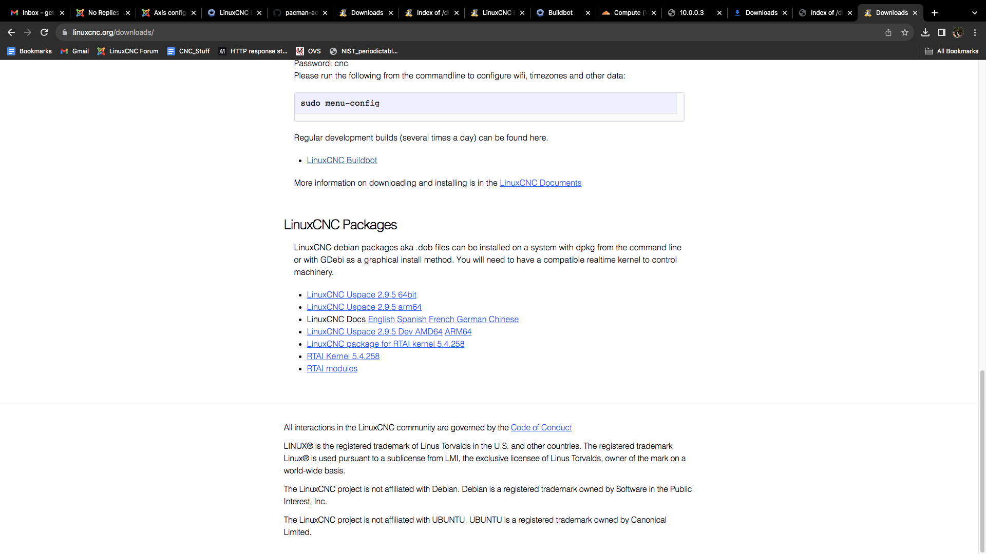

2.9.5 should not be available to download due to it being broken.
- Posts: 19902
25 Oct 2025 21:26 #337166
2.9.5 should not be available to download due to it being broken. was created by andypugh
2.9.6 is also broken.
And 2.9.5 and 2.9.6 only exist because 2.9.4 is broken.
As it 2.9.3, 2, 1, 0....
As far as I know at the moment 2.9.7 is, at least, broken in unknown ways.
It will be out on Sunday.

Any idea of what may be suitable for a new image ?
I'd like an idea of what to use in the Raspios image I'm working on for Trixie.

2.9.7
The following user(s) said Thank You: unknown
