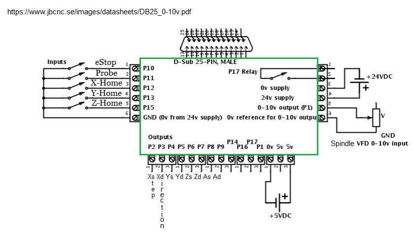

I recently struggled with getting my Raspberry Pi 5 to accept the estop input. On this forum, I asked the following question.
I would like to know how to connect the GPIO to LinuxCNC’s E-Stop chain.
From this, I received some tips and advice that pointed me in the right direction, but no working answers. I used a YouTube video on installing LinuxCNC on a Raspberry Pi, but the advice was old and no longer valid. My assessment at this time is: If someone were to attempt what I attempted, I don't see a mechanism for them to follow in my footsteps because they would unlikely use the search term "estop" or "GPIO" to search the forum. So I would like to put together what I learned to make this happen.
1. Not many users of this form are using Raspberry Pi computers - they have some limitations
2. The Byte2Bot hat does not create a parallel port. Rather is isolates the GPIO pins on the computer board and brings them out using a DB25 connector that is just like the parallel port on your Mesa card or computer. This allows you to use a parallel port breakout board. While a parallel port dedicates PIN2 to a dataline, with the output from a Raspberry Pi, one needs to refer to what is the GPIO line connected to that pin which is GPIO9 in this example. In your setup, you cannot refer to PIN2; you must only refer to which GPIO line it is. When someone sends you suggestions that look like "=> hal-gpio.PIN12.out" - it won't help you.

4. The schematic offered by Byte2Bot had some notable omissions that is corrected in the Circuit3.jpg schematic from another user.
5. The eStop button should be NC (Normally Closed) - I did not correct that. The eStop button should be latching - mine is not.

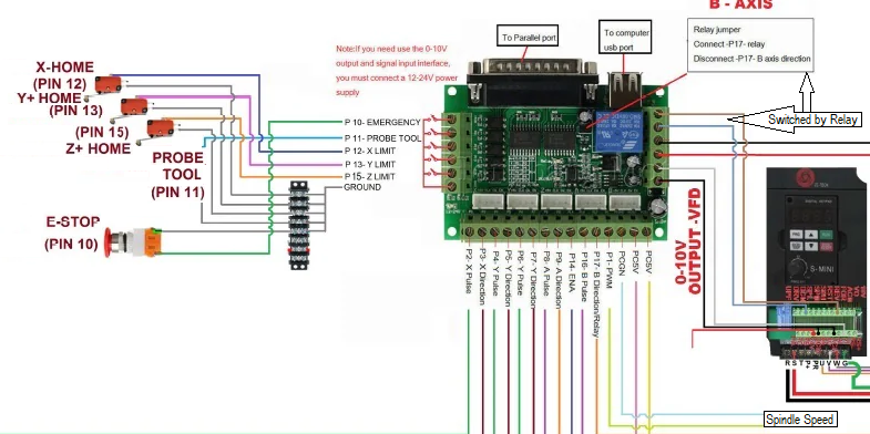

I'm trying to set up the DB25 board to connect to a geckodrive G540 and running into some confusion. Currently reading the
byte2bot guide
on this and I'm confused about the hal_gpio pin naming. Where are these pin numbers for "pi5 2025" coming from? They don't seem to match any pin mapping I've seen in any other online source. Do I use the 2023 or 2025 one?
Image of pinout naming matrix below.
