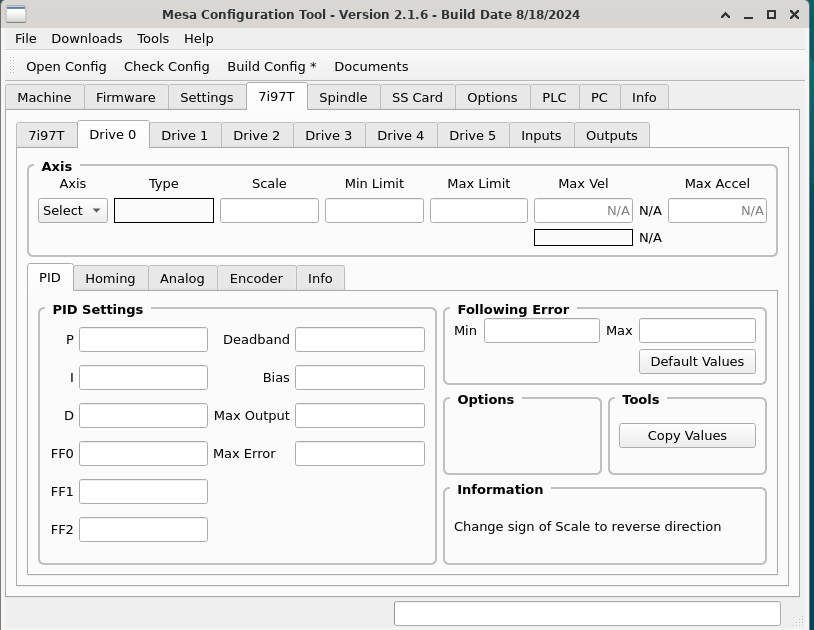

I just have lots of question hoping someone can help me trying understand how to use Mesa CT what is the Scale ,min limit,
max limit ,max vel
How do i get the PID for analog servo how do i get the values for deadband what is the bias what is max error and max output what is FF0 FF1 FF2
max limit ,max vel

I keep getting these errors can you help me to see what I am doing wrong
- Posts: 21985
- Thank you received: 7484
02 Oct 2024 08:05 #311157
Replied by tommylight on topic Mesa CT
From your error logThe same pin is used twice in you main.hal file.
./main.hal:55: Pin 'hm2_7i97.0.pwmgen.00.enable' was already linked to signal 'motion-enable'

Here it is, as Tommy said; it does seem it's using pin 55 twice; how do I prevent mesa ct from using it as pwmgen.00.enable and motion-enable, or is something I have to edit manually
Error report created by /usr/lib/tcltk/linuxcnc/show_errors.tcl:
