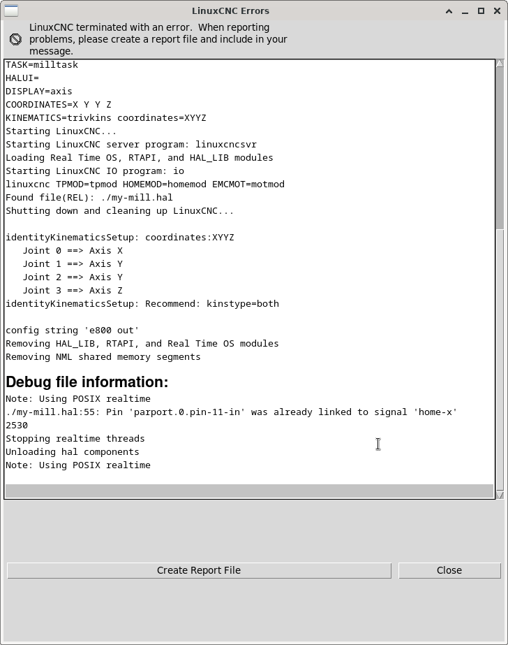

Homing my greatest bugbear. I simply can't get my head around this one.
I wish to have my new machine home X axis and Z axis using one pin IE pin 11
and the two Y axes  on pin 12.
I would prefer to have the Z axis home before the X.
The 2 Y axes should home together in whichever drive arrives first.
I have tried a number of things but have reverted to this setup.
Any help would be greatly appreciated.
Cheers Paul

It is not possible to use the same pin for tandem axis homing, but you can use one pin for home_all and the second for home Y2 as in the attached example from a working machine.
The following user(s) said Thank You: captain chaos
24 Feb 2025 06:45 #322462 by rodw
Also note how Tommy has used HOME_SEQUENCE to home the Z axis first.
