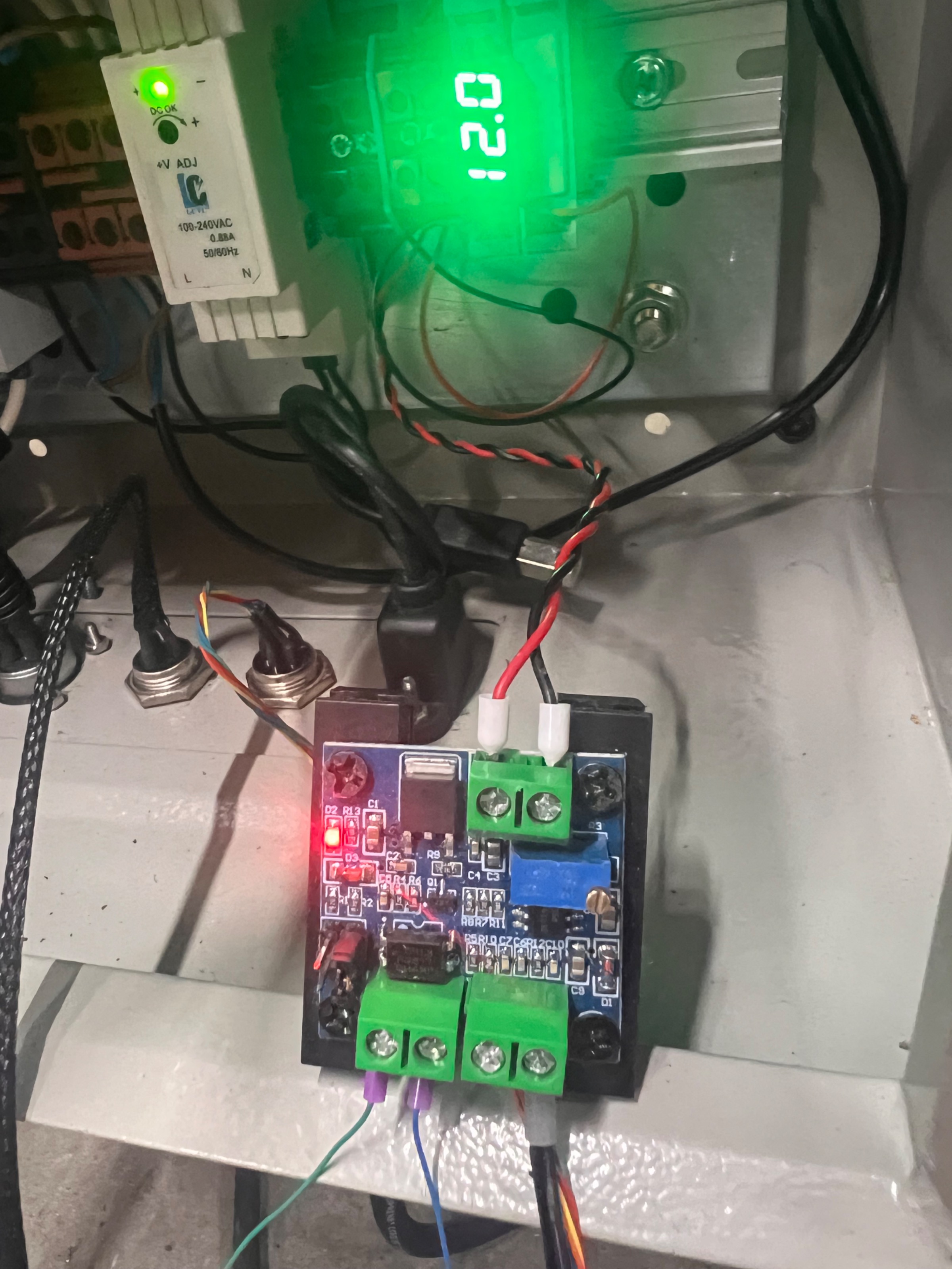

thanks jt, that was making me go bonkers trying track that one down. found that in one of my other machines configs and it worked!
as for the pwm voltages, i just got through checking everything and i shouldn’t have any load on the pwm at all. the 7i96 is powered with a dedicated 5v 0.55a psu. i adjusted the pot to 5.42v(i dare not go any more) and i get 5.31v between +5 and gnd and at 24k rpm which is max, i get same between gnd and pwm- when i have the cable to the vfd box disconnected. when i connect the cable it drops to 4.86v. is the converter actually pulling a load? i can get close to 10v if i boost the input voltage to 14v which is within the range of the board, but is that just a hack or will that work? or is the psu for the mesa board under powered? i saw that in a post that 250ma was enough without any loads.

that is what i thought. it should just be a proportional voltage coming out, but there must be a small load on it because my pw
voltage drops about 0.5v when i plug it in and tye only way i can get 10v or close is to increase the input voltage to the module to 14v.
these are the new ones i have coming.
a.co/d/5rSxmMy
which is similar to tye board i have now.
i could just use rs485 to control the spindle, but this is a big machine and at least for now i use the same computer to control 3 machines and i dont want to have 2 cables running across the floor. i trip over one often enough, so i need to try and get this pwm running
a.co/d/5rSxmMy

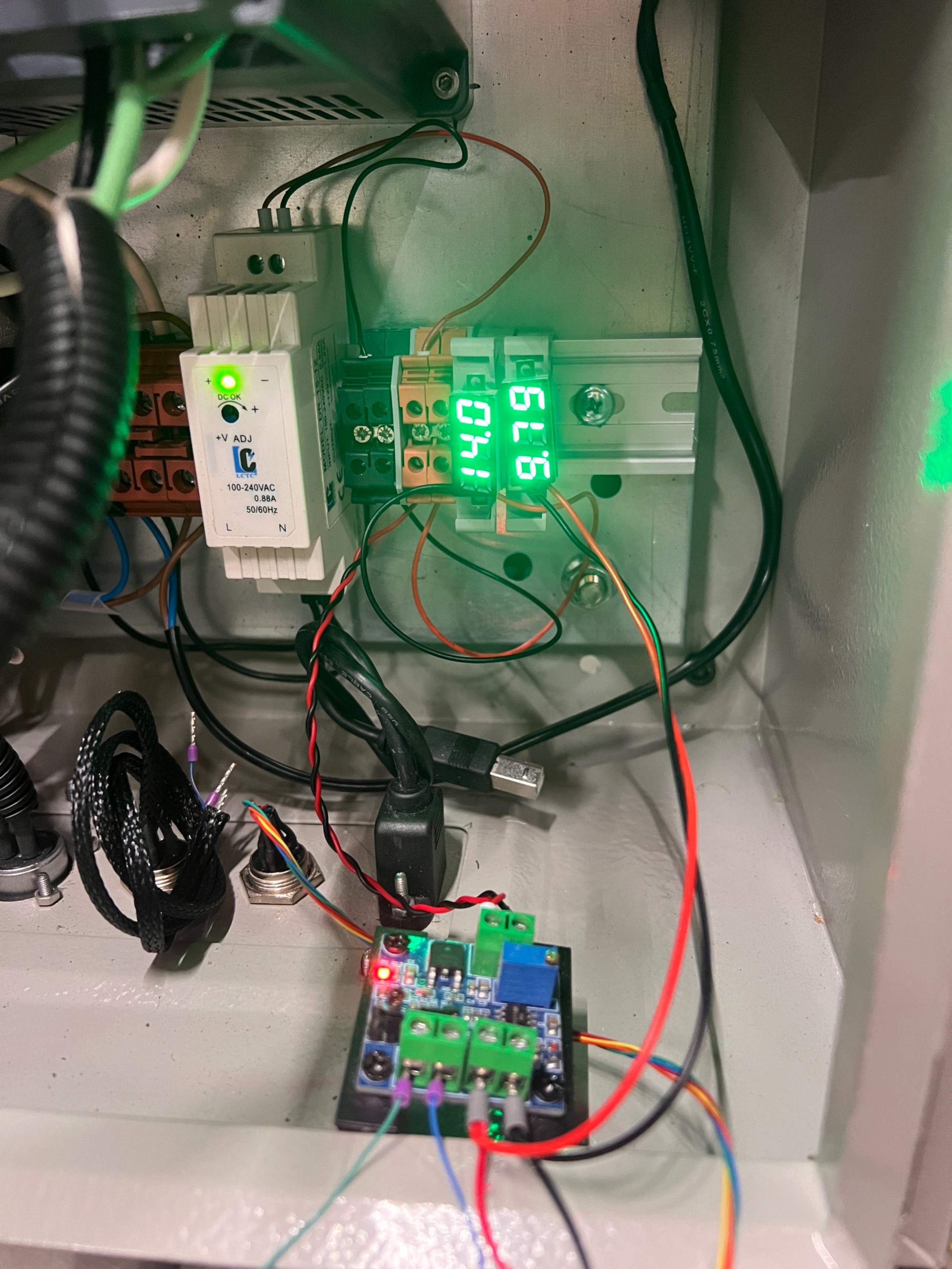

Replied by oddwick on topic MesaCT problems with 7i96 pwm spindle
it does adjust the output voltage a bit, but not the scale i dont think.
so here are some numbers when its working
mesa - 5.2v
pwm module - 12.1v in
m3 s12000 (min) - 2.34v in (2.53 unplugged) 4.92v out
m3 s24000 (max) 4.65/5.07(u) 8.62 out
if i step up the input voltage to 14.2v i get 9.77@24k and 5.24@12k
if i adjust the pot on it i can get 10v but only at 14v. i max out at 8.65 @12v. but when i get 10v, im at 5.78 on the low end which i suppose wouldnt be all that bad with an air cooled spindle vs going too slow
mesa - 5.2v
