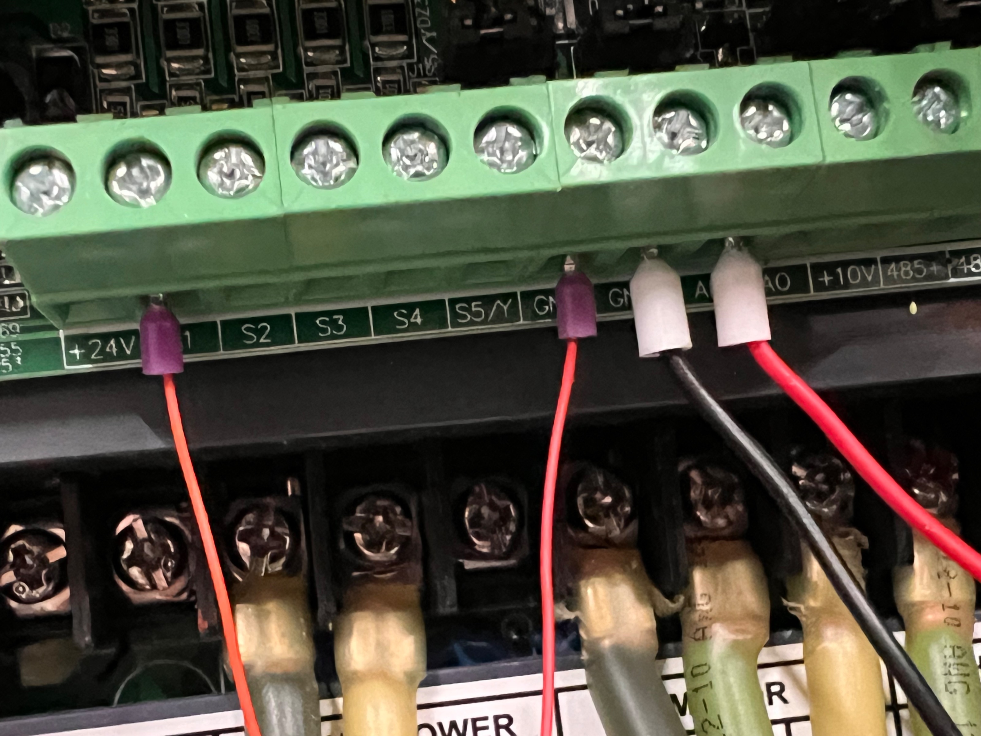

ok so i for the most part got it working now, thanks jt pete and tom for the help! basically if i run the pwm module at 14v i get close enough to 5-10v to give me 12-24k rpm.
the last thing i just need to figure out is how to get the spindle to actually start. been trying to decipher a chinglish manual all afternoon to program this vfd. to be fair tho, it is actually better translated than the other ones ive dealt with. i can set the working frequency from linuxcnc but cant actually get it to start remotely. if anybody has any experience with a huanyang fc01, any help would be greatly appreciated!

Pictures of your VFD connectors?
Not from the net, last week i dealt with two of the same make and model VFD that are not the same in any way, nor are the electronics the same.

ok so heres a pic of the conns. i have verified everything all the way up to them is working. spindle start is on ssr.03, and all the wiring from the mesa to the vfd is tested. as best as i can tell P00.01 should switch between the keypad and remote switching. i can change the frequency from linuxcnc but thats about all.
the manual is here: www.huanyangvfd.com/wp-content/uploads/2.../FC01-Series-VFD.pdf

Manual, this section:
P05 group Input terminals
