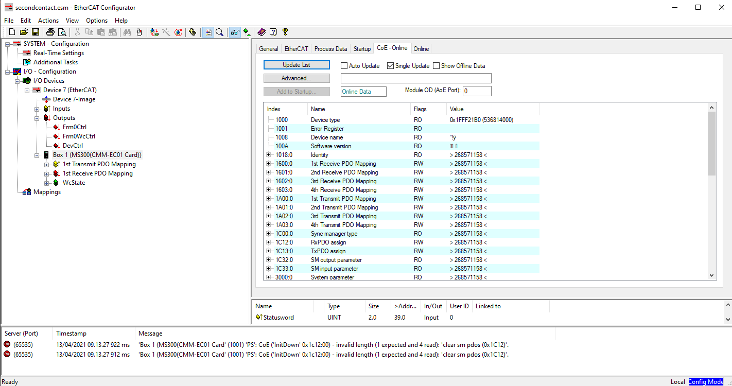

13 Apr 2021 07:26 - 13 Apr 2021 11:19 #205763 by Stormholt
Replied by Stormholt on topic Ethercat with Delta Ms300 and CMM-EC01
So i have also tried Codesys and Twincat. Codesys cannot find the device and Twincat cannot establish an online connection.
Ethercat Configurator(After the EEPROM update) finds the device and seemingly has an online connection, but i can no longer read values like status word etc. The system parameters have either become empty or gibberish. And i cannot write to the writeable ones. I have attached an image, that also displays an error. Seems like a sync manager has the wrong idea of how many registers are mapped to it.

13 Apr 2021 14:13 #205797 by db1981
Replied by db1981 on topic Ethercat with Delta Ms300 and CMM-EC01
-your ethercat problems are caused of an etherlab/ethernet driver problem or that your are not running in realtime.
-with the ms300 box, maybe something wen't wrong with the eeprom update. Where did you find the eeprom data and the xml file from delta?

[ 2313.959735] 0x1600
[ 2323.959720] EtherCAT ERROR 0-3: Timeout after 10000 ms while waiting for SDO 0x1a00:0 download response.
[ 2323.959723] EtherCAT WARNING 0-3: Failed to clear PDO mapping.
[ 2323.959724] EtherCAT WARNING 0-3:
[ 2323.959724] Currently mapped PDO entries:
[ 2323.959725] 0x6041:00/16
[ 2323.959725]
[ 2323.959726] 0x6043:00/16
[ 2323.959726]
[ 2323.959727] 0x6061:00/8
[ 2323.959728]
[ 2323.959728] 0x0000:00/8
[ 2323.959729] . Entries to map:
[ 2323.959729] 0x6041:00/16
[ 2323.959730]
[ 2323.959730] 0x6043:00/16
[ 2323.959730]
[ 2323.959731] 0x6061:00/8
[ 2323.959732]
[ 2323.959732] 0x0000:00/8
[ 2323.959733] EtherCAT WARNING 0-3: Failed to configure mapping of PDO 0x1A00.
[ 2333.959712] EtherCAT ERROR 0-3: Timeout after 10000 ms while waiting for SDO 0x1c13:0 download response.
[ 2333.959715] EtherCAT WARNING 0-3: Failed to clear PDO assignment of SM3.
[ 2333.959716] EtherCAT WARNING 0-3:
[ 2333.959716] Currently assigned PDOs:
[ 2333.959717] 0x1A00
[ 2333.959718] . PDOs to assign:
[ 2333.959718] 0x1A00
[ 2333.964712] EtherCAT 0: Domain 0: Working counter changed to 5/6
[ 2333.964713] .
[ 2333.995385] EtherCAT 0: Slave states on main device: OP.
With XML:
<masters>
<master idx="0" appTimePeriod="1000000" refClockSyncCycles="1">
<slave idx="0" type="EK1100" />
<slave idx="1" type="EL1002" />
<slave idx="2" type="EL2004" />
<slave idx="3" type="generic" vid="000001DD" pid="10400200" configPdos="true">
<syncManager idx="2" dir="out">
<pdo idx="1600">
<pdoEntry idx="6040" subIdx="00" bitLen="16" halPin="ms300.control" halType="u32"/>
<pdoEntry idx="6042" subIdx="00" bitLen="16" halPin="ms300.target-velocity" halType="s32"/>
<pdoEntry idx="6060" subIdx="00" bitLen="8" halPin="ms300.mode" halType="s32"/>
<pdoEntry idx="0000" subIdx="00" bitLen="8"/>
</pdo>
</syncManager>
<syncManager idx="3" dir="in">
<pdo idx="1A00">
<pdoEntry idx="6041" subIdx="00" bitLen="16" halPin="ms300.status" halType="u32"/>
<pdoEntry idx="6043" subIdx="00" bitLen="16" halPin="ms300.velocity-demand" halType="s32"/>
<pdoEntry idx="6061" subIdx="00" bitLen="8" halPin="ms300.mode-display" halType="s32"/>
</pdo>
</syncManager>
</slave>
</master>
</masters>
I got the xml file from Delta's own downloadcenter . The eeprom data is not something i found, but some thing i believe is generated when using the "EEPROM update" in ethercat configurator. I believe it is similar to the sii_tool that can generate an SII file from an xml file
