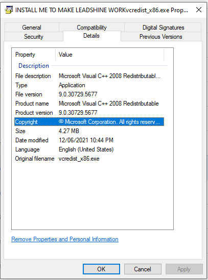

motors, which are 220v AC servos and drives, 400w. So far the leadshine ELP-EC drives seem pretty good, everything appears to be exceptionally high quality for the money, these definitely appear to be a sweet spot for cost/quality. (side note, for those who struggled to find a price for these I paid (USD) $85 for the motor, $145 for same with brake, and $224 per drive, I purchased directly from leadshine.)
- One important tip for others working with these drives: Leadshine's motion studio did not want to run under windows 10, it took a bunch of sleuthing with windows event viewer to figure out that it wants a C++ redistributable from 2008 and it needs to be run as administrator. I've attached a screenshot of the redistributable version properties, it's pretty hard to find as microsoft doesn't officially want you to download one that old but some google fu found me a viable official MS download link eventually. I'd link that here but it was a while ago. If anyone's desperate PM me and I'll share the file... if you trust exe's from strangers on the internet

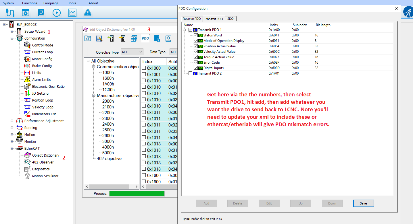

- Side note on PDOs: you may need to configure your drives to send them/which ones to send using the manufacturer's software before any of this will work. If you're using the same drives then open leadshine motion studio with the drive connected via usb (doesn't need power), run the setup wizard (just 'next' everything for now), then go to the ethercat section, open 'object dictionary' then the little 'PDO' button at the top.... that took forever to figure out when I didn't know what a PDO was....
- Next step was IO... the drives have 14 digital in, 6 out, some of each are differential, all optoisolated as you'd expect and conveniently you can wire them for common+ or common-, basically you can choose the IO bank for the drive to be sinking or sourcing, which is handy as my Z lims are a different flavour to the X and Y (space limitations motivating that decision). This took a while to figure out:
- On these drives you can use PDO 0x3000 for raw input states, or 0x60FD (side note, leadshine uses xxxxh to denote hex in the manual) for input states with some named (estop, home etc). You'll need to configure in the leadshine software which IO goes to which name first.
- Next you'll need to configure the drive to send that, see the leadshine pic for info
- Then you’ll need to edit your xml to have that new PDO in it.
- and the bit that took forever to figure out: how do I get this 32/16bit number to be something useful for LCNC? The answer is 'haltype=complex'... which as far as I can figure (if I'm wrong link me, I couldn't find it) does not exist in the linux docs.... only in that 130 page thread 'Ethercat Hal Driver'... Via this haltype you can treat a single 32bit PDO as 32 hal pins, or whatever mix you need. See my attached xml for example

Hi Lausch, how did you go with your setup?
I noticed something in one of your posts about leadshine setup that isn't ideal: "Pr0.2 Real-time auto-gain tuning = 2 (position mode)" - that's for point to point motion not interpolated motion... that happens a lot in the manual, a lot of things that have 'position' in their name are for point to point, usually it says in a footnote or somewhere in the 5.2 section of the manual.
Also Pr0.0 Mode Following Control = 1 (automatically sets bandwidth) it says "If multi-axis synchronous movement needed , set Pr000 as the same for all the axes", where 0(auto) or 100+ is valid. I dramatically reduced my following error by increasing it up to 2000... though then I ran into a weird issue where the stiffness settings would be fine in the leadshine motion test page (ie smooth, low following error, no noise) but would get noisy if you moved the motor via ethercat/lcnc.... so I had to lower it which brought some following error back in.
oh and pr1.15... yeah I'm confused as well, digging into that one myself.
An interesting side note of the mode following control value is the timing portion of ethercat - some of the random forum posts etc I've read mentioned that the sync0cycle time should match the position/velocity loop of the drive, and from what I can tell pr0.00 is where you set that.... I think.
If you get a chance upload your ini/hal etc, I'm having trouble setting up the velocity mode with PID and cia402 though I've likely missed something simple. Did you need to change anything on the drive?
I've upped one of my leadshine configs though I'm no expert on them or anything.
Edit: had to zip the leadshine conf file
