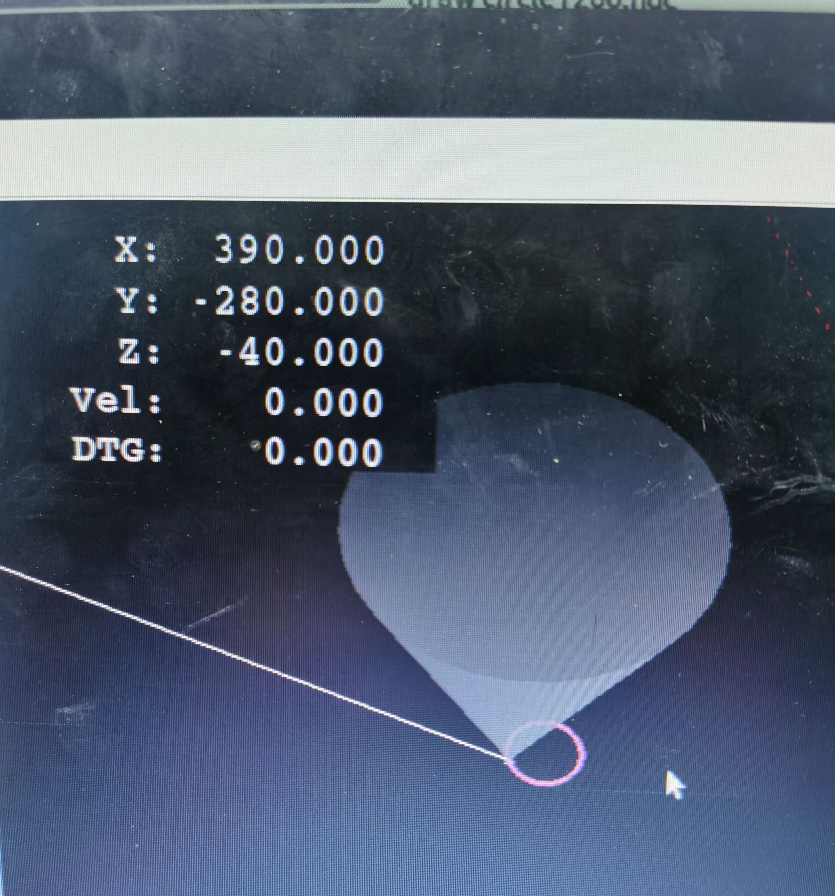

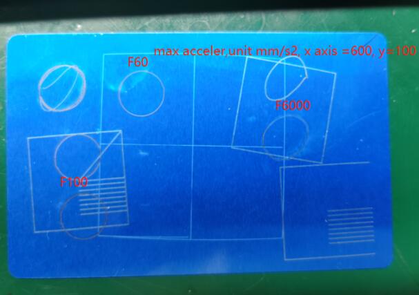

I control the laser machine tool through Ethercat. When I interpolate and draw a circle, because of the driver gain setting problem, the interpolation circle is not round.
like this:
But it shows a very round image on my image. I am using an incremental encoder.
like this:
Can anyone explain me the reason? I think it’s a problem with the drawing algorithm
like this:
like this:

09 Nov 2021 20:31 #225913
Replied by tommylight on topic GUI feedback display
blog.prusaprinters.org/calculator_3416/
Go to "acceleration", input your numbers and you will see that the acceleration is way to slow for the feed rate you are requesting.

Sorry, my question is "Why is the circle interpolated by the laser an ellipse but the circle shown in the image is a perfect circle?"
- Posts: 22030
- Thank you received: 7504
10 Nov 2021 03:08 #225940
Acceleration to slow for the requested feedrate.
Use
G64 P0.1
Or set higher accelerations in the .ini file.
Use
G64 P0.1
