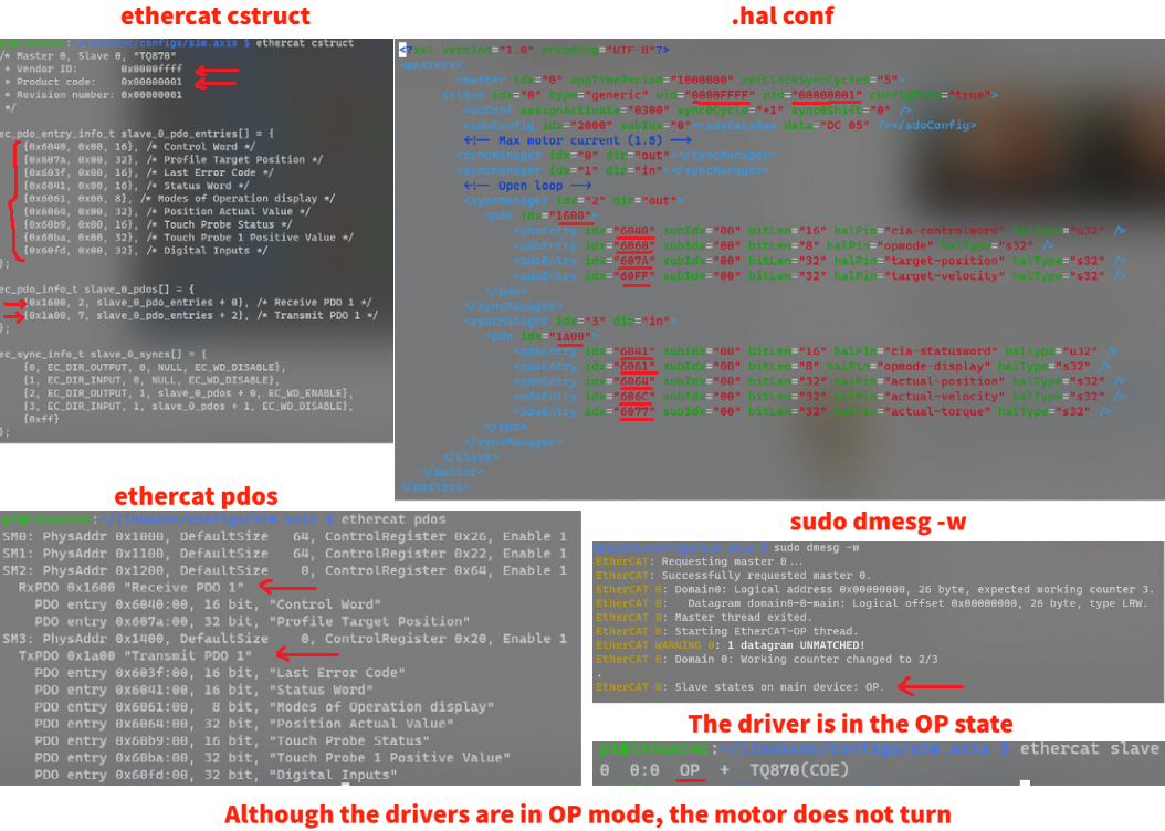

this is my hal file. I m going step by step to avoiding error
loadrt [KINS]KINEMATICS
#autoconverted trivkins
loadrt [EMCMOT]EMCMOT servo_period_nsec=[EMCMOT]SERVO_PERIOD num_joints=[TRAJ]AXES
loadusr -W lcec_conf ethercat-conf.xml
loadrt lcec
loadrt cia402 count=3
loadrt pid names=x-pid,y-pid,z-pid
I added the following code to section [EMCMOT]
COMM_TIMEOUT = 10.0
COMM_WAIT = 0.100
# Timeout for comm to emcmot, in seconds
COMM_TIMEOUT = 1.0
and the error disappeared
now there is another error
waiting for s.joints<0>, s.kinematics_type<0>
loadrt lcec
COMM_TIMEOUT = 10.0
COMM_WAIT = 0.100
COMM_TIMEOUT = 1.0

I think my problem is the drivers. They are in the PREOP state
pi@linuxcnc:~/linuxcnc/configs/sim.axis $ ethercat slaves
0 0:0 OP + EK1100 EtherCAT-Koppler (2A E-Bus)
1 0:1 OP + EL1018 8Ch. Dig. Input 24V, 10�s
2 0:2 OP + EL1104 4K. Dig. Eingang 24V, 3ms, Sensorversorgung
3 0:3 OP + EL2008 8K. Dig. Ausgang 24V, 0.5A
4 0:4 PREOP + TQ870(COE)
5 0:5 PREOP + TQ870(COE)
6 0:6 PREOP + TQ870(COE)
I configured it with vendor id and manufacturer

am i right that linuxcnc is now starting up?
you will have to find out whats wrong with the pdo mapping. Set ethercat debug level to 1 and carefully read dmesg. It will help to reduce the config to an minimal setup. (only PC and one drive for example) , so reading dmesg is a lot easier....

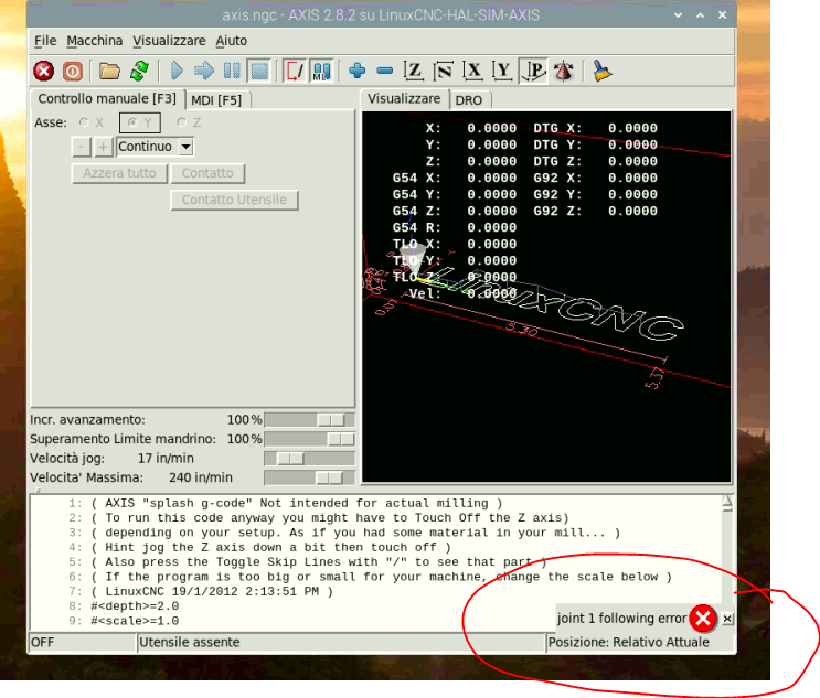

Yes! linuxcnc is started.
It gives me join error and according to the linuxcnc manual it may be due
1. too little ferror or min_ferror
2. the RT pulsing can't keep up with the speed needed
2.a. BASE_PERIOD set incorrectly or (requested step rate is not possible at this BASE_PERIOD)
2.b. max velocity too high
2.c. max acceleration too high
Anyway I look at it later now I connect a driver as you said and try to see if I can configure it

Hi everyone
I only connected one driver as recommended but the motor does not run. It seems that the configuration is correct, I also downloaded the xml file of the ECT60 driver on the tuttorial cia402 to compare it with mine and the settings are almost all the same.
The driver status is in OP.
dmesg gives no error.
I connected the driver on Windows with TWINCAT and the motor is running
but connected on RPI and starting linuxcnc the motor does not work.
I do not understand why
